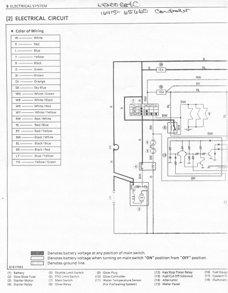

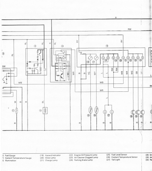

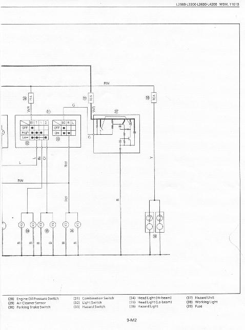

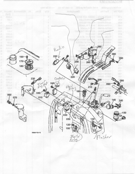

Your glow plug controller module died - having the plugs AND indicator not light up indicates the controller. It is under the dashboard. My L4200 did the same thing the first year I used it for winter maintenance (figures).
I ended up pulling the controller out of its socket, and bypassed the function by wiring in a big button on the dash, so I now can manually actuate the glow plugs (and indicator light), which I like better. To restore normal function to your tractor, your best bet is to simply buy a new controller from Kubota and replace it. Wiring and parts diagrams attached.
Edit: Just saw your 'got it started' post. Your controller could be flaky at extreme cold temps, but more than likely a connector issue. There is a thermistor in the coolant that gates the controller as a temp sensor - a connector to it could be a problem or possibly the connect to the module itself. Pulling the dash is a PITA, but if it happens again, I'd get into the controller and at the very least unplug and re-plug it (w/ a bit of dielectric grease) - same with the coolant temp sensor. Also why I bypassed the function with a button.

I agree with Jay; it's likely the glow plug controller. Mine stayed on and killed the battery before I read posts here. I replaced it, but be aware it awfully tight beneath the dashboard. I like Jay's idea to bypass it manually or at least re-wire so you can get to it easier next time.
