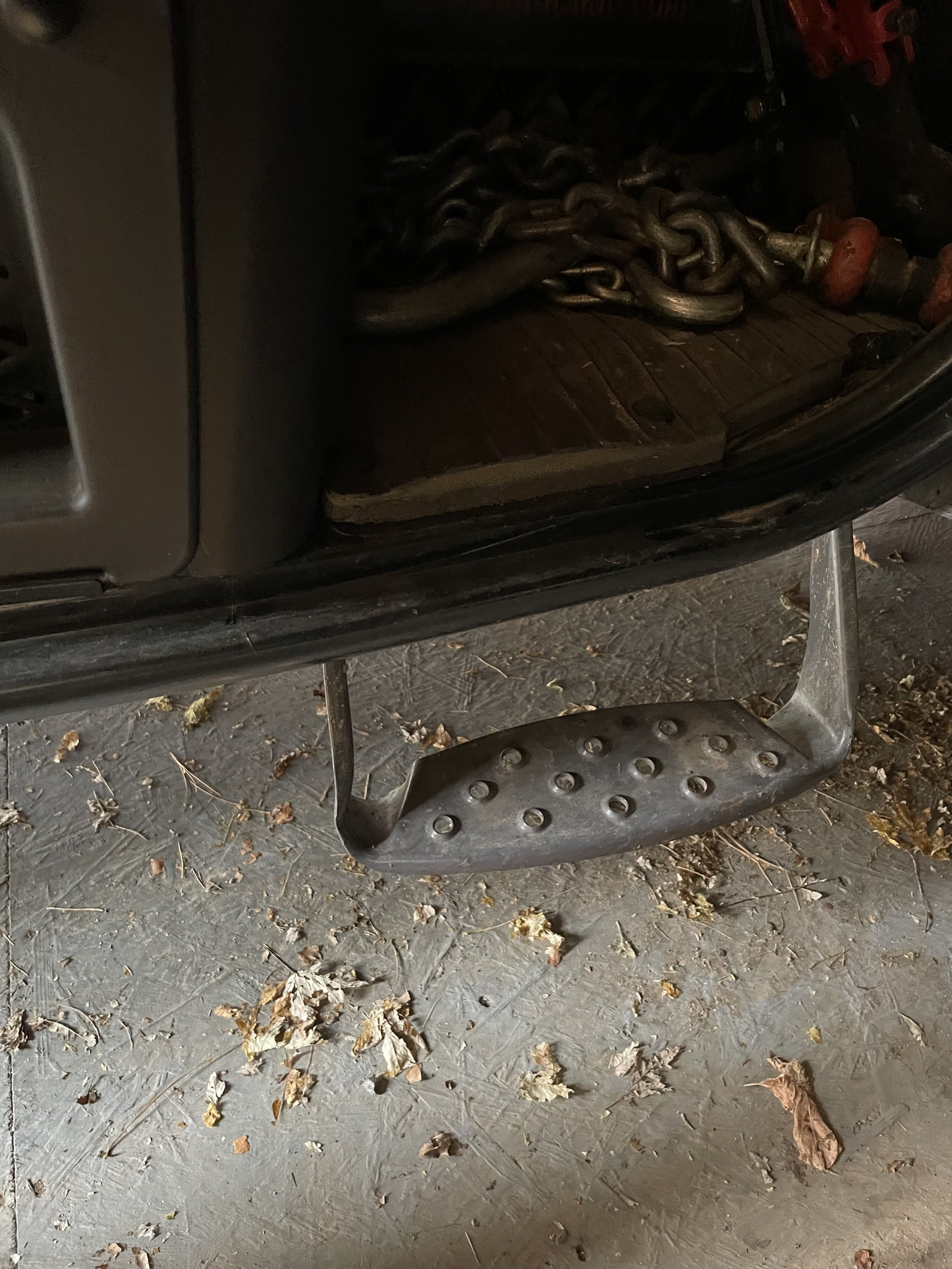

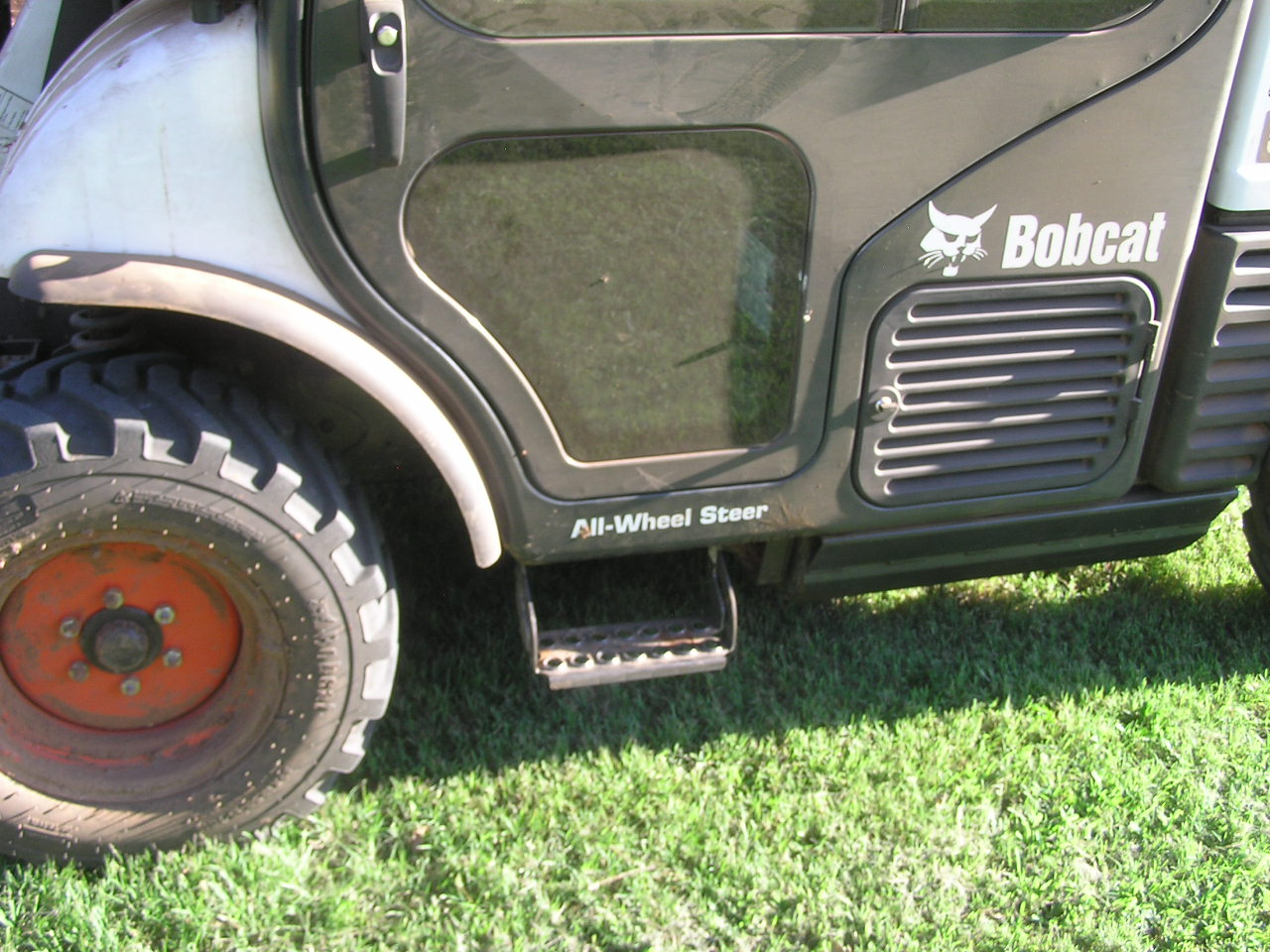

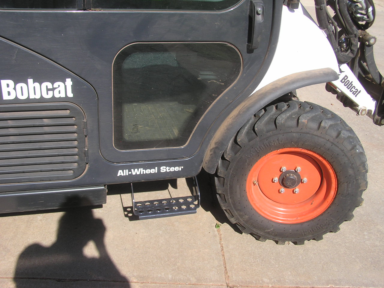

The old broken folding ruler is just long enough to show the floor is 23 inches up from the ground on the Toolcat:
At my age now (82) I am very glad I put the steps on it when I did: trivial question about the step kit

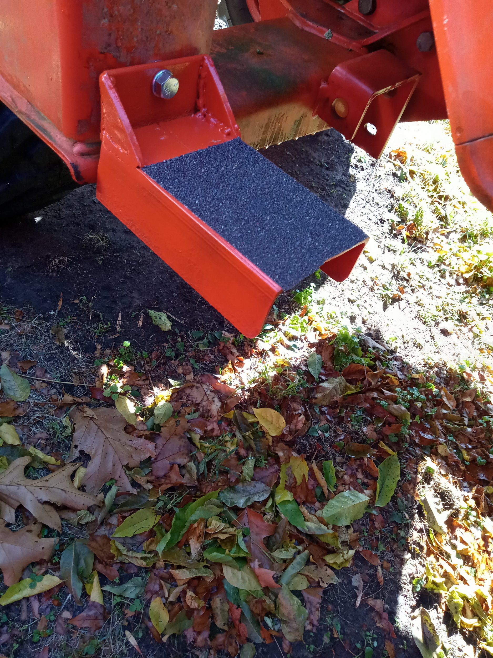

Your step idea encouraged me to finish a project that I've been thinking about for a while. My LA302 loader frame had two 10mm holes which I tapped to 7/16-14 and welded up some angle iron to make a bolt on step on each side. It lowers the step height by about 8" and allows a second step to get up on the platform of my B7500. It's much more convenient than having to do it all in one step with my bad leg.

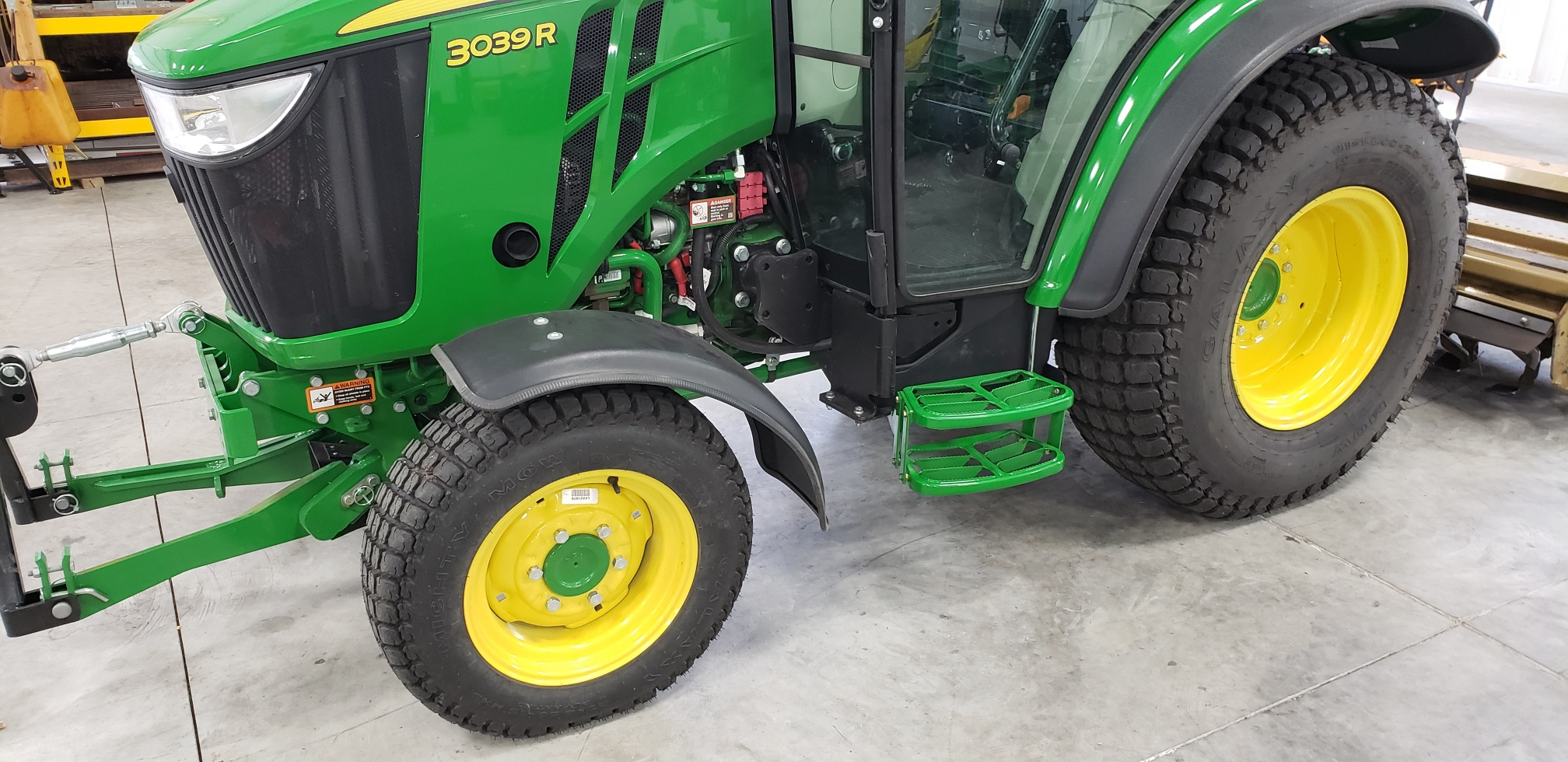

I added a second step for the same reason as everybody else, bum leg.
