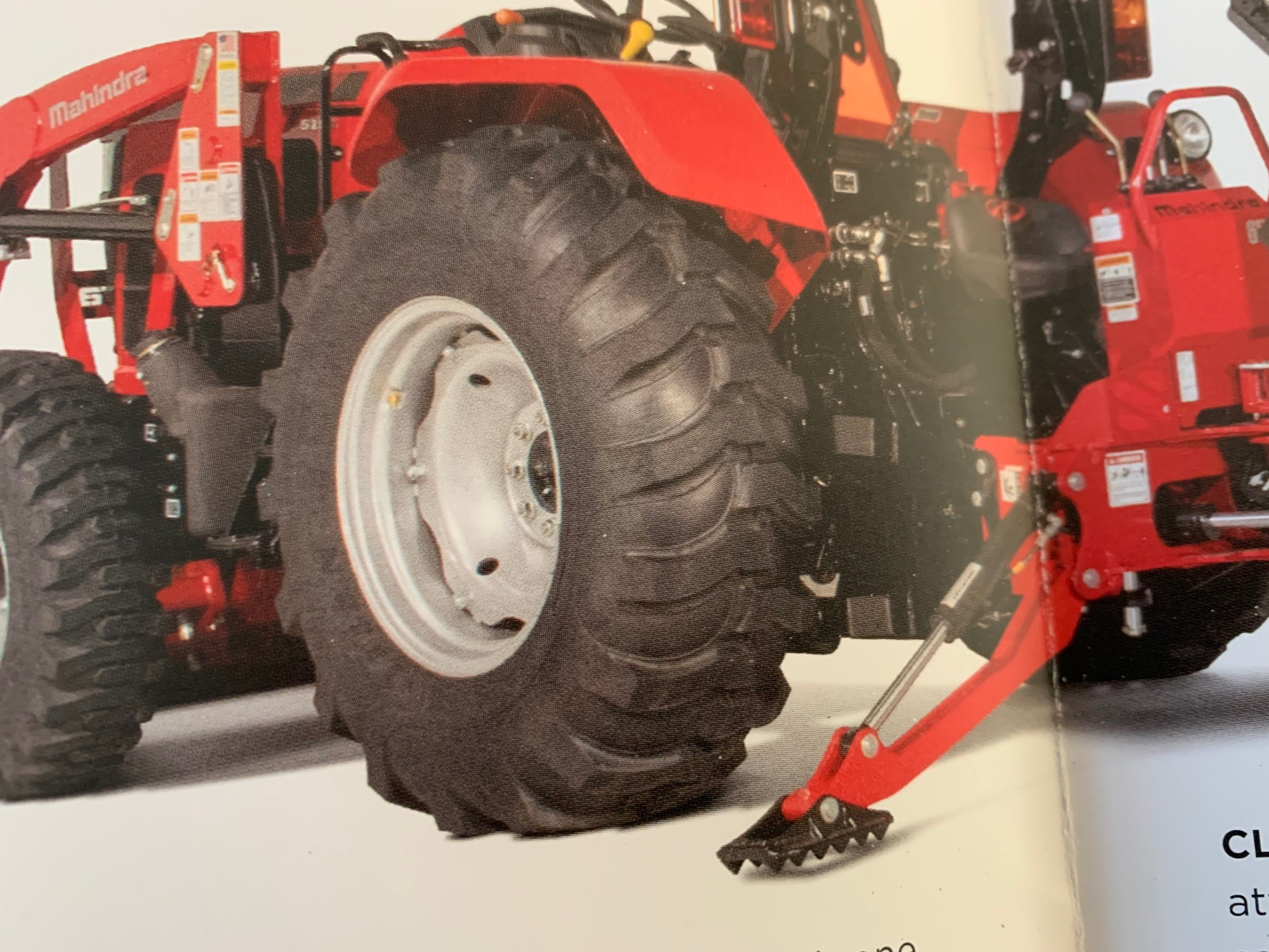

I'm looking at a Mahindra 5145 and twice now I've been told I can't get R-4 tires with the 2 piece width adjustable wheels.
They can get R-1 Ag tires like that but not R-4s. I pointed out that the factory brochure shows the wheel/tire combo I want
but have been told they can't get them like that. Is the this the sign of a dealer not willing to go the extra mile or am I being unreasonable?
My property is very hilly and I need to get the wheels out as wide as possible. They told me I could turn the factory 1 piece wheels around and switch sides with them but there's no adjustment. I was also told I could use spacers but I don't want spacers.
Picture of brochure attached.

The dealer is incorrect.... an R4 rim is much wider / deeper. You cannot "turn them around or swap side to side
Vs. an R1 rim:
Don't forget the R4's are much wider to begin with. The new R14's fit on R4 rims and are also wider.
   / Getting the wheel/tire combination I want on a new tractor #5
Vs. an R1 rim:
You are correct, 1 piece R4 rims as you have pictured cannot be turned. The OP has a picture of R4s on 2 piece adjustable rims on the tractor that he wants.
His posted picture is an OEM brochure picture with factory supplied tires and wheels. The 2 piece R4 rims are common on full sized utility tractors, I have them on my tractor. Maybe Titan has not caught up with their back logs, but the 2 piece R4 rims are indeed available and were a std item for Mahindra utility sized tractors.

I bought R4s for 2 of my tractors. I was thinking the wider tires would be better on hills. I was wrong, They slide sideways on hills, don’t grip well. Last tractor I got R1, which are almost as wide as the R4s I had before. Will never get R4s again.

You can get wide (or narrow) R-1’s with higher load capacities for loader work. I have some pretty heavy duty R-1’s on mine

I think that the OP wants what is suppose to be a std no cost option for the tractor that he wants to get.
