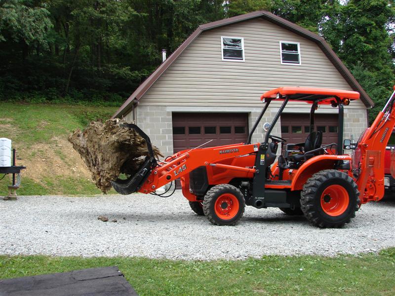

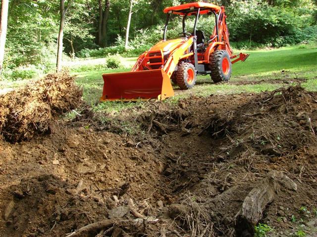

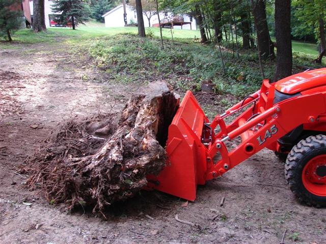

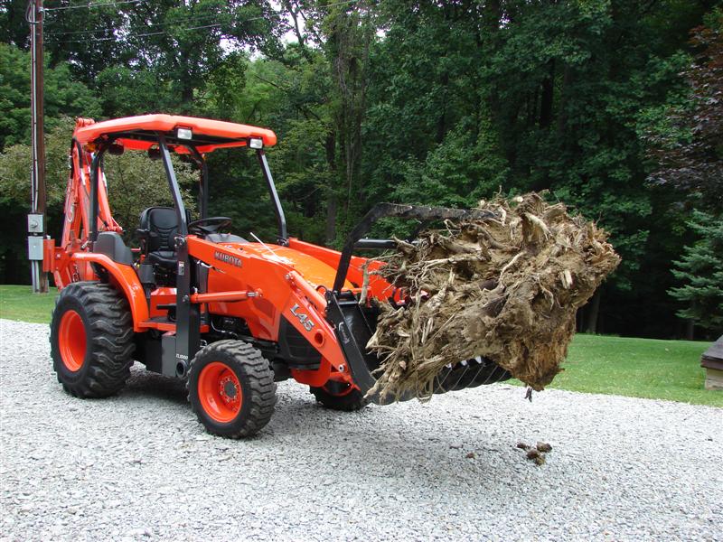

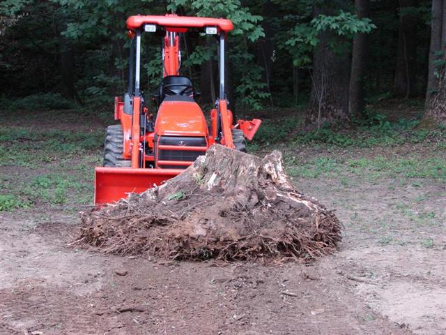

jdonovan, Hi
I have a L45 and love it!! It is just the right size for most of the jobs I do. And it is still very easy to transport around. If you are not in the need of a full size back hoe. I think the L45 would suit you well.
The M59 is just about the size of a full size tractor you just have to look at your needs . But let me say this the L45 will dig stumps with no problems. You are not going to rip them up 1,2,3 but you won't do that with a full size hoe either. Time and practice. Here are a few pic's of mine in action!!
