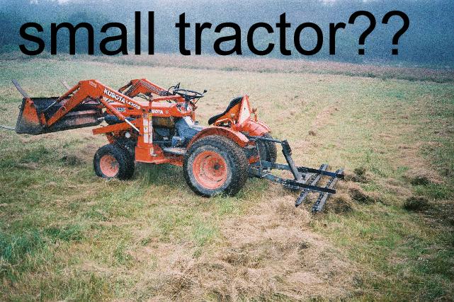

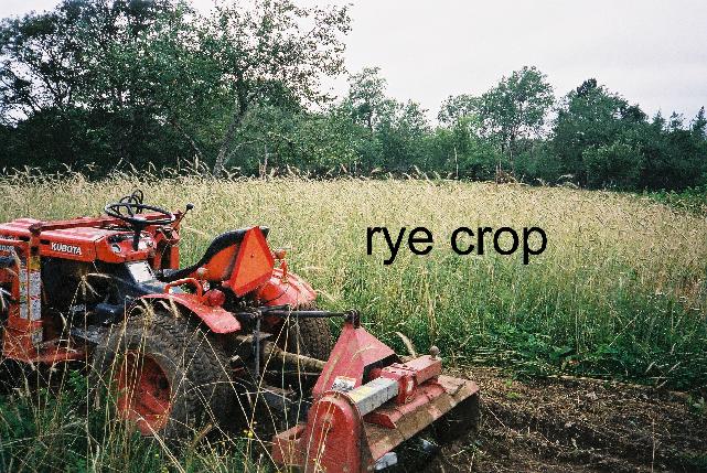

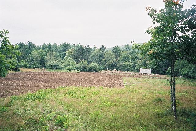

Go with the roto tiller. You will make the best use of your HP this way. Also fabricate a drag of some sort and use that for the leveling. With a combination of tilling and dragging you will surprise yourself with the results.
For seeding six acres is entirely doable use a hand seeder or just broadcast and then harrow.
A three point harrow an be made from pickup tines and should work OK.:D
A picture attached of a few acres prepared with 16 HP tractor, hand spreader and home built harrow.:D

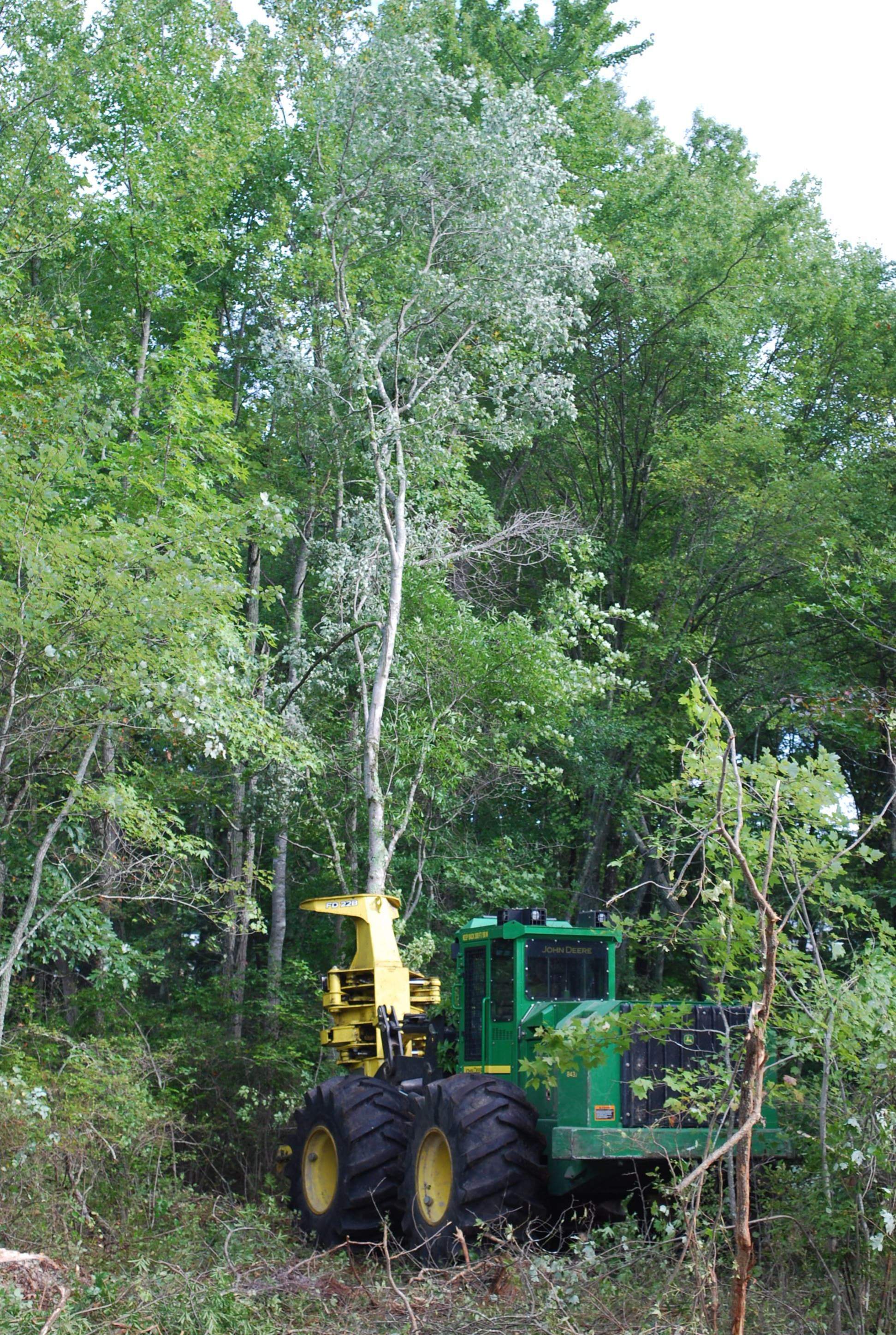

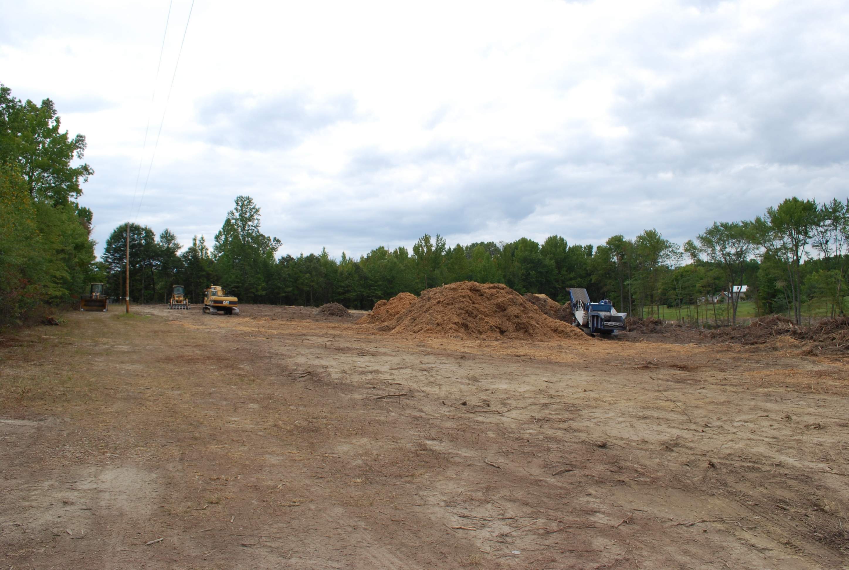

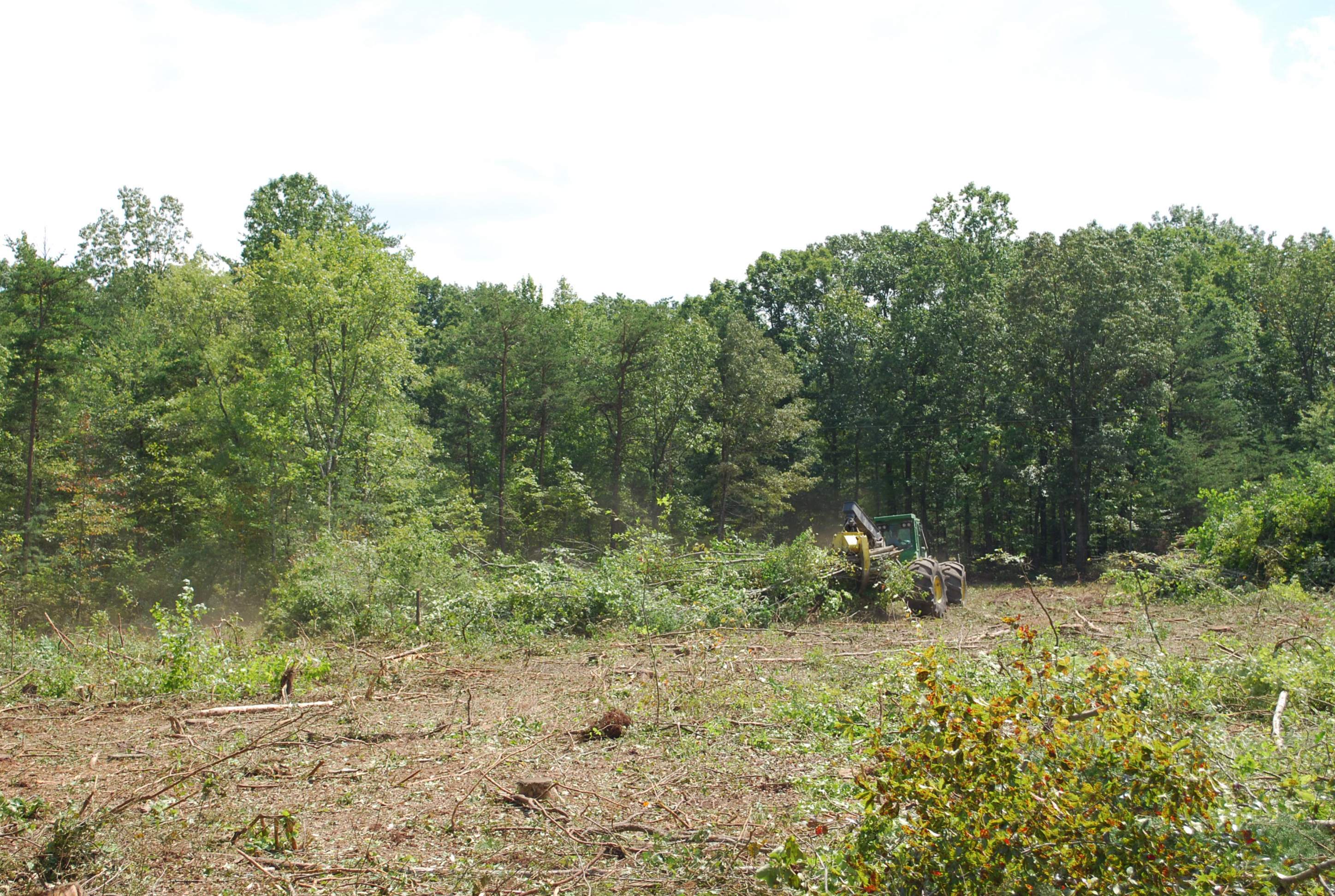

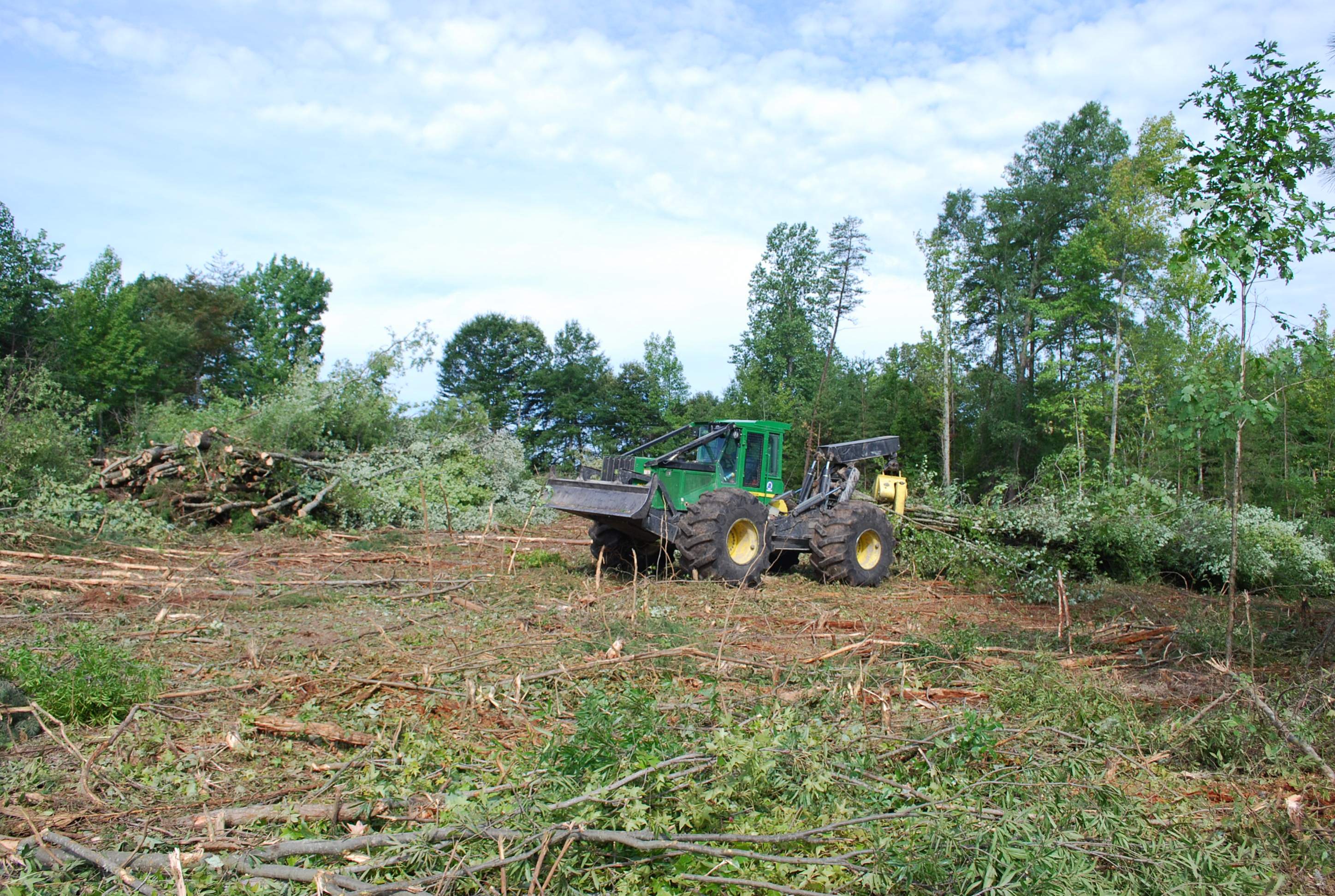

I'm in the process of finishing up the clearing of 6 acres for a Christmas tree farm.
This has not been an easy process. I have a 40 hp Kubota Grand L3940. All my stumps were removed but I've had to battle with the roots. The contractor that removed the trees and stumps also pulled a 4 tine sub-soiler, then disced the land, then sent a dozer to smooth things out. I then ran my landscape rake to collect the remaining roots. I got a lot of dirt with it and now am trying to get rid of the piles of topsol mixed with roots. Once this is done I will spread lime and fertilizer and pull a small disc (smaller than the contractors bat-wing disc :eek:) to mix the lime and fertilizer into the soil. Then I'm pulling a 3pt mechanical seeder to plant clover and pasture grass. Christmas trees go in next spring.
This has been much more work and much more money than I ever anticipated. My tractor did not have the hp for some of this so I had to contract it out. Anyway, I'm almost done :D
Check out the photos of my progress:
