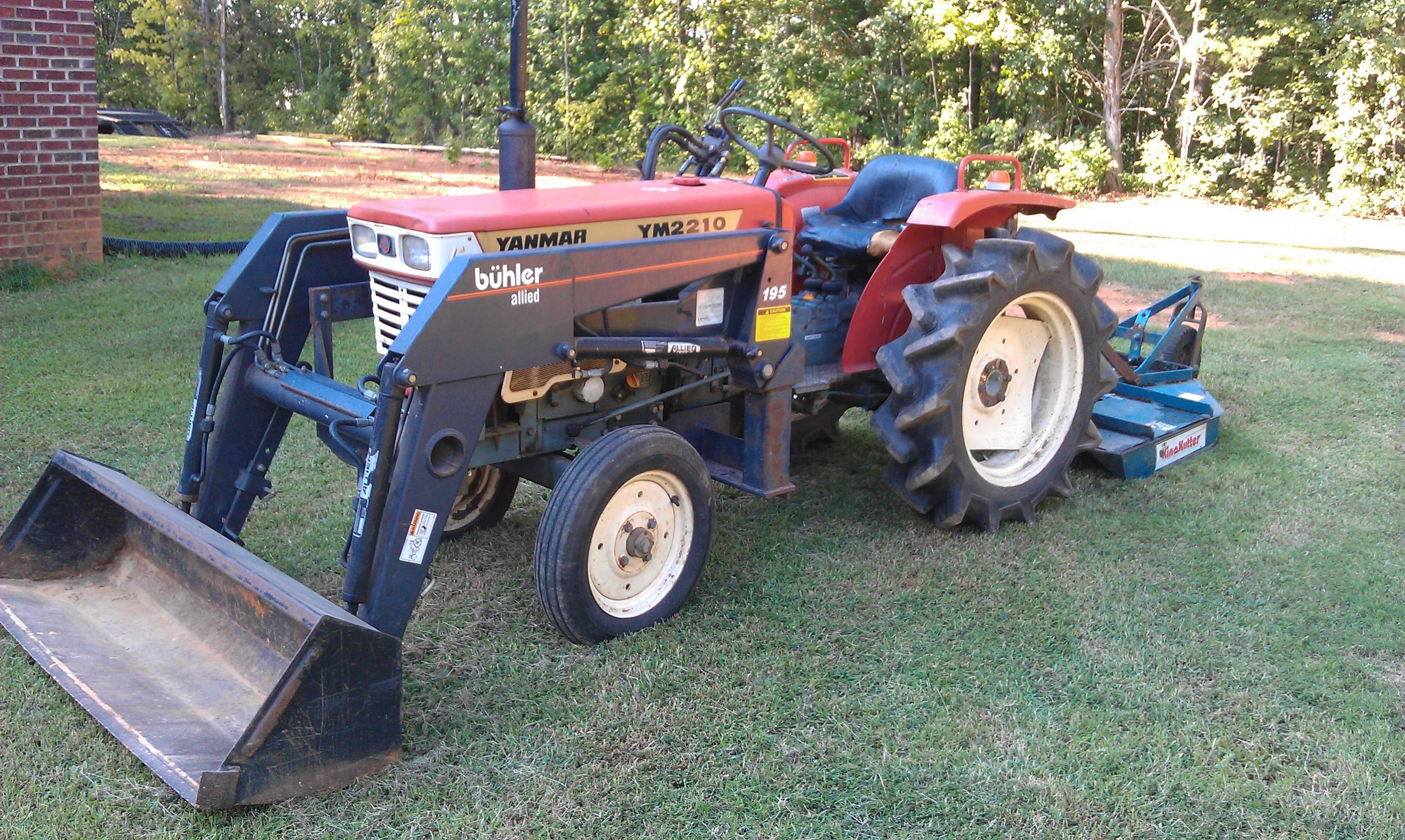

here she is
/ Getting a new toy #14
That's a nice looking unit. I'm interested to hear you compare the 2210 to your YM2001. The loader sure looks brawny.
