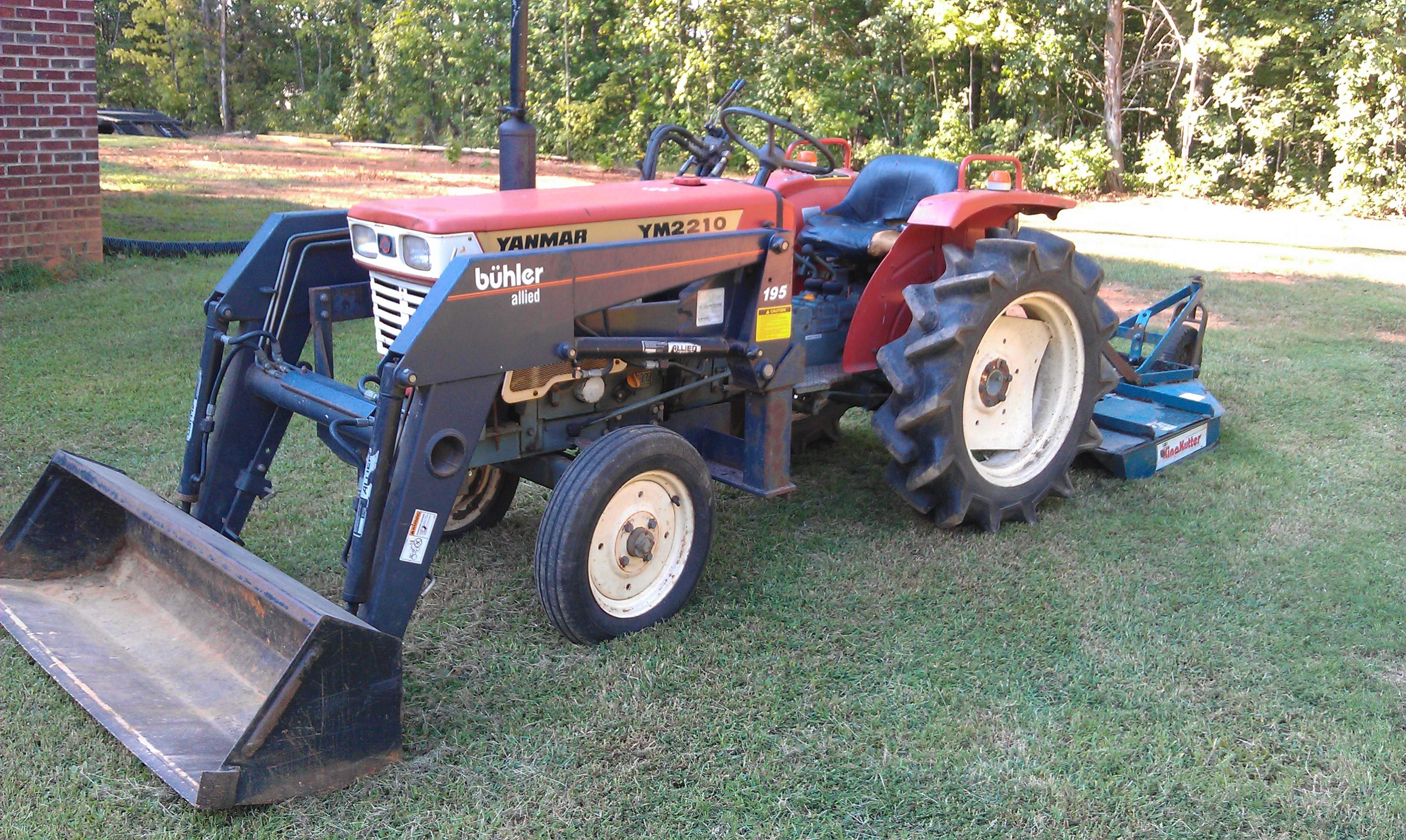

I would use any kind of petroleum oil lubricant. It's exposed to the engine oil under the valve cover, so it should get lube just because of the environment, except maybe at the seals. That doesn't mean it hasn't sat unused for too long and seized or frozen up, though.
Hopefully you'll pull the calve cover off and discover that it's just gotten tight from sitting unused, and you can disassemble and clean things up, and it will be in good shape. Take pictures of what it looks like, so we can see how it works and what fixes it.

The little decompression shafts that go through the valve cover have o-rings on them. Wouldn't doubt them just being dried out and clinging hard.

Winston was right, it was just tight from sitting, i didn't have to remove the valve cover, there are 2 small caps on top of it that are held in place by two #7 screw, remove those and you can see the decompression rode that runs through the valve cover, lubed all the the parts that touch the valve cover and after working it back and forth with a rubber mallet it eventually freed up, worked with it about 15 minutes. So all is good now, haven't found anymore issues yet.

To answer your question on what lube you can use. You can pretty much use anything. I prefer PB blaster or Liquid wrench to WD as WD dries out fast. You can also use transmission fluid which is the best penetrating oil as well as all purpose lube i have found. That stuff frees about anything up that has seized!
Can use deisel as well but i doubt you have that in an oil can?
