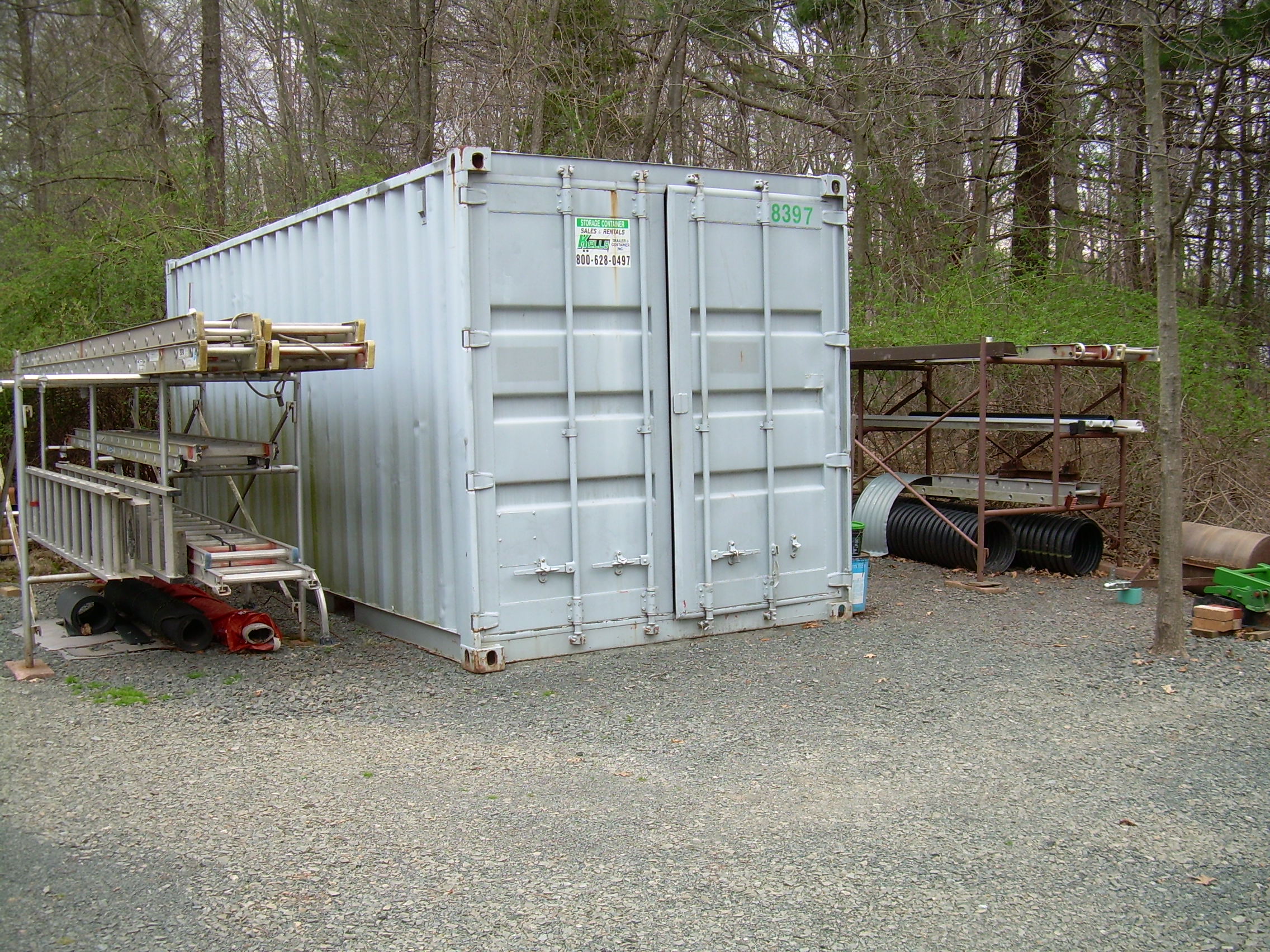

I plan on getting a new(one trip) 40' standard or high cube grey or beige sae container. Now I am wondering how level do these things have to be for the doors to work correctly because where I will be putting it at first isn't completely level? Also would solid concrete blocks be strond enough without breaking to put on the corners on the container? I figuered if I can get it on the blocks that will give me a few inches to get a jack under it to maybe level it up some. Another question it will be sitting near hard packed gravel from our semi's packing it down the past 30 years. Will it hurt the container on its bare bottom if we use a 850d case dozer or 380c skidder or even a 90hp kubota tractor to pull the container around on the hard packed gravel if later on we want to move it around on the lot? Do you guys think this new container will be good and secure to keep my atv's and other valubles in that I am araid id going to get stolen? THANKS!!!
/ Getting a new 40' shipping container need advise! #2
Level doesn't matter, it's a end to end twist that will mess up your door alignment.
They're designed to be supported on the corners only, I would suggest doing so.
Crossmember design will be the factor in if any damage will accure from dragging.
Plan on redoing the door lock design.

/ Getting a new 40' shipping container need advise! #12
I've got a twenty footer, I just leveled and raised the ground with road base. Expect all kinds of critters to make the underside of that thing there home :) I've got a wood chuck living under mine that had a liter last year.
Around here the 40 footers are only a tiny bit more expensive than the 20's. seems more people want the 20 footers. For the 40 footer try and get the midway door, tend to pack stuff in the back of the longer ones and have trouble getting to it.
I ran 3 foot deep pallet racking down 1 side, floor to ceiling.
The closer to the ports you are the cheaper the price obviously, I paid $2400 for mine that looked almost new at the time.
Oh yeah, they do get hot!
JB.
