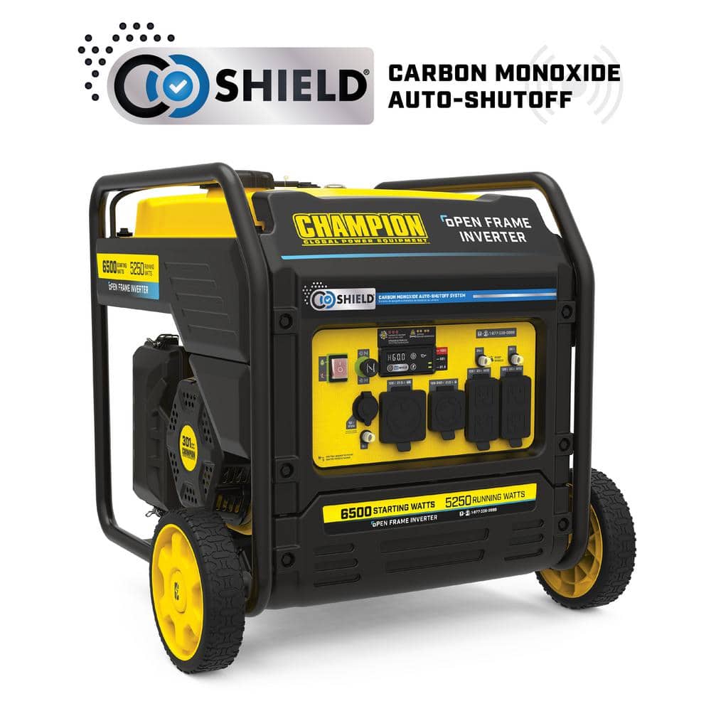

Have you found a small inverter that does 240V?

Something like this.
That will probably do.
But for my use I just (about an hour ago) bought the Duromax , I was pleased to see I got my 10% military discount.
