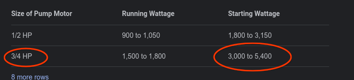

My well - ¾hp pump 160' down - required all other loads to be disconnected from my 3.5kW generator, and then it was still a 50/50 chance that it would pop the generator's breaker on pump start-up; I think if you're expecting to rub other things at the same time as the well pump start, 5kW may be small.
Remember also that initially everything is likely to try to start together, but you don't have to let this be the case. When we used that 3.5kW generator I would first turn on the well, flush necessary toilets, wait a minute or two, then connect the other loads.

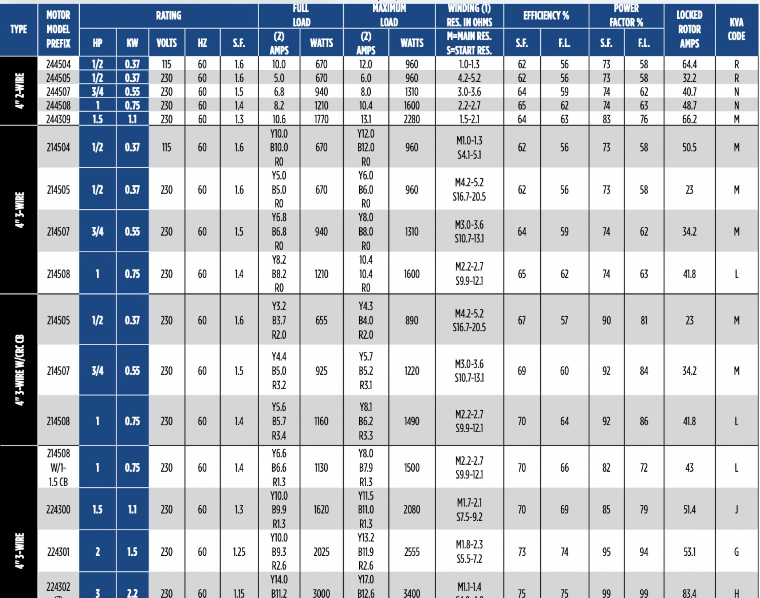

Yes, definitely a 20 amp double. A 240/20 amp breaker is supposed to be 80% of the 4800w, that is the 3800 number I put. Maybe because mine is 3 wire single phase? But here is another chart.

I think that perhaps a reason for the "voodoo" aspects, is different motors have very different peak currents, and different generator models can have extremely different abilities to handle the peak draw of a motor starting that gets into the details of the generator bull, windings, insulation, and its control circuitry. There is also the detail of "do you want to be able to start your well once, ten times, or five times a day for a year, or for twenty years"? You get the picture.
I think well pumps are amongst the most demanding motors to start because the have a head of water on top of the pump that the motor is attached. A relative has a well pump that is 700' down, that's over 300psi. So in her case it isn't so much that the motor is a 3HP, it is the back pressure on the pump.
Net result: I think that you get a lot of folks saying "Hey, I can/can't do it with my XXXXwatt generator...." both can be true.
