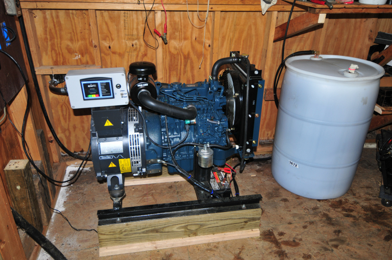

   / Generator and propane tank sizing feedback needed #54
What it looks like
#55
Love it. Is that drum the fuel tank? Looks like you keep the vent covered when not in use?
Imagine you could run for a week or more on that.
What you see is my half-assed breather - an oiled cloth. Just to keep dirt and water out.
It will run longer, depending on the season. If it is not too hot or too cold I shut it down overnight during a power outage. Don't need much power when we are sleeping !
paul
