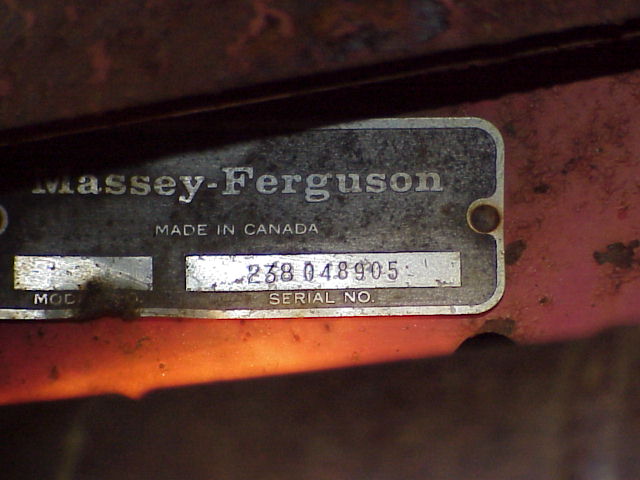

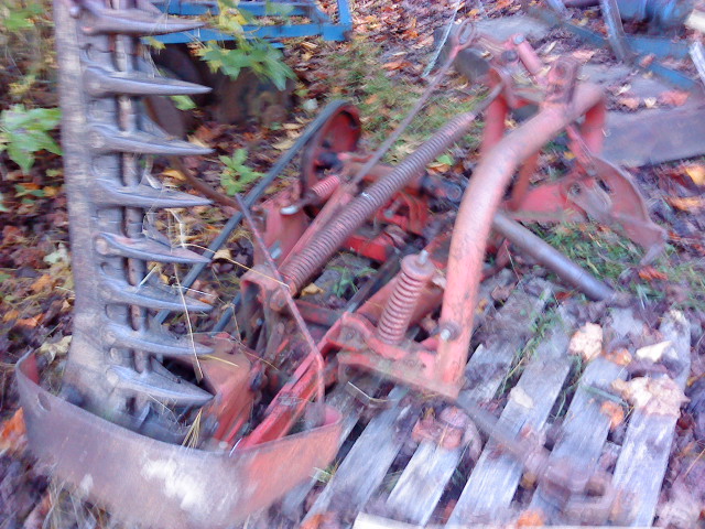

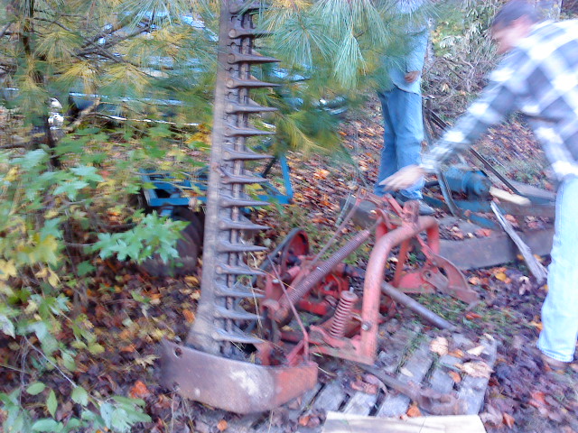

I finally got a chance to go look at the sickle bar mower mentioned in the OP...
after looking at it and after what I have seen and read (here) I thought $300 was a good deal...so I bought it... attached are some (lame) pictures...I did not expect to be getting "like new" piece of equipment for what I paid but I think I did OK...
... the MF tag was intact but I could not read a model # (see pic)...it must have been printed on the tag but the serial # is legible.. 238 048905
[Question for Ken Sweet]...what are my chances of getting a manual for this mower? anything close?
I will take better pictures of *all* the adjustment points that are on the mower...as previously stated...I'm totally ignorant on the operation of this piece of equipment...also it is the first attachment that uses PTO power so I will also have some questions on that aspect as well...
sorry for the poor pics...

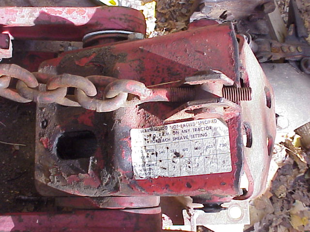

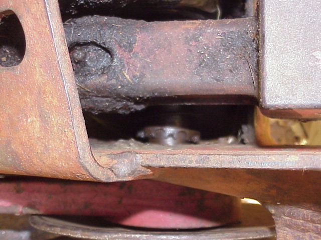

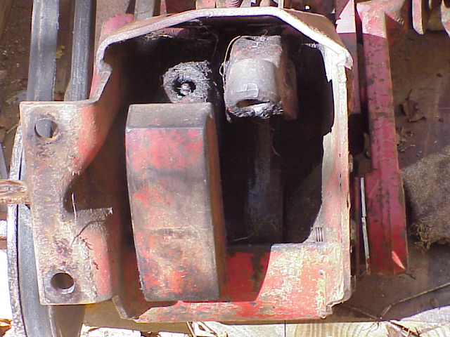

I'm going to need at least one set of bearings for the pulley side of the head...I hope they are readily available?...
When I was checking out the mower (there was no tractor available) I spun the belt to make sure the bar functioned ok...today when I lowered the bar and spun the belt I noticed some lateral movement in the pulley...
I pulled the bar off and realized there is obviously a tore up bearing...I can see part of the ring and race...I need to get a bigger wheel puller before I can actually see what is needed...
Ken, can you tell from the pictures if this is a welded or cast head...I'm not sure what part I'm supposed to be looking at ?
in the last picture the broken parts of the bearing can be seen...
   / General questions about Sickle Bars #49
It is the later model #41 series. Lets hope the previous owner did not run it very long in that condition. That crankshaft is easy to score and too expensive too replace, MF will have all your needed parts. Ken Sweet
