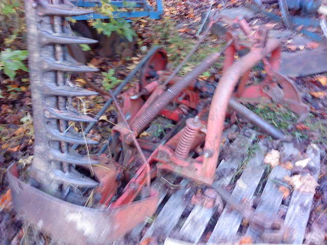

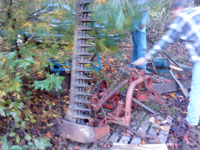

I finally got a chance to go look at the sickle bar mower mentioned in the OP...
after looking at it and after what I have seen and read (here) I thought $300 was a good deal...so I bought it... attached are some (lame) pictures...I did not expect to be getting "like new" piece of equipment for what I paid but I think I did OK...

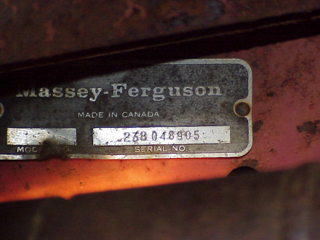

... the MF tag was intact but I could not read a model # (see pic)...it must have been printed on the tag but the serial # is legible.. 238 048905
[Question for Ken Sweet]...what are my chances of getting a manual for this mower? anything close?
I will take better pictures of *all* the adjustment points that are on the mower...as previously stated...I'm totally ignorant on the operation of this piece of equipment...also it is the first attachment that uses PTO power so I will also have some questions on that aspect as well...
sorry for the poor pics...

Congratulations on the purchase, you did good if the head runs out ok. Pine, the cast iron drive head will be the 31 and the welded head will be the 41 series. I really can't tell from the pictures. From what I can see in the pic. looks like a cast head. Let me know?
I have not figured a way to add hydraulics that will let the mower retain its full range of movement (70 degrees below horizontal and 90 degrees above. There are a few recent posts
showing ways to add the cylinder to raise to transport. Ken Sweet

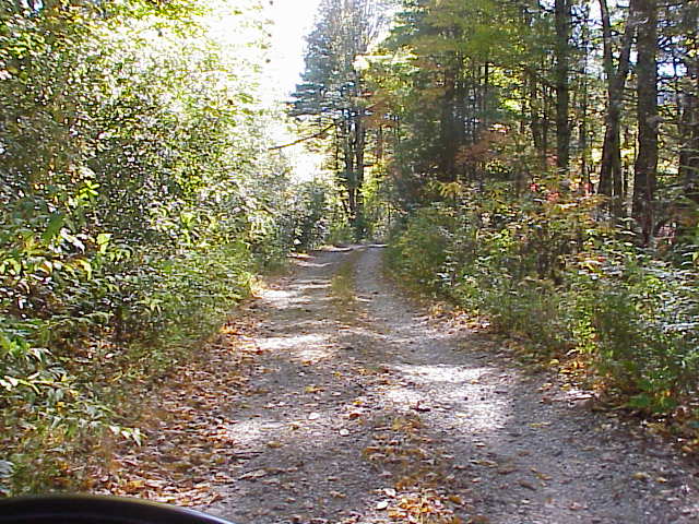

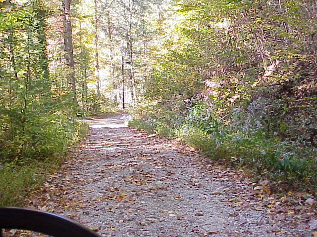

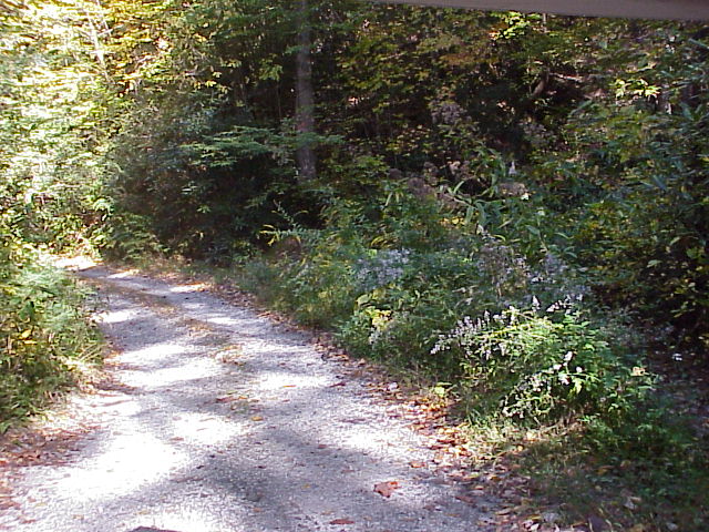

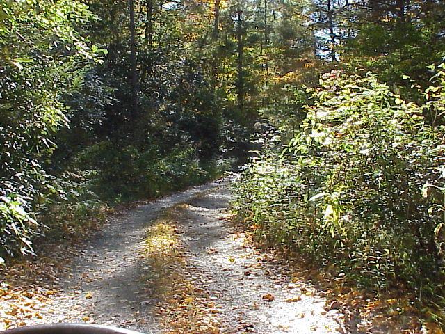

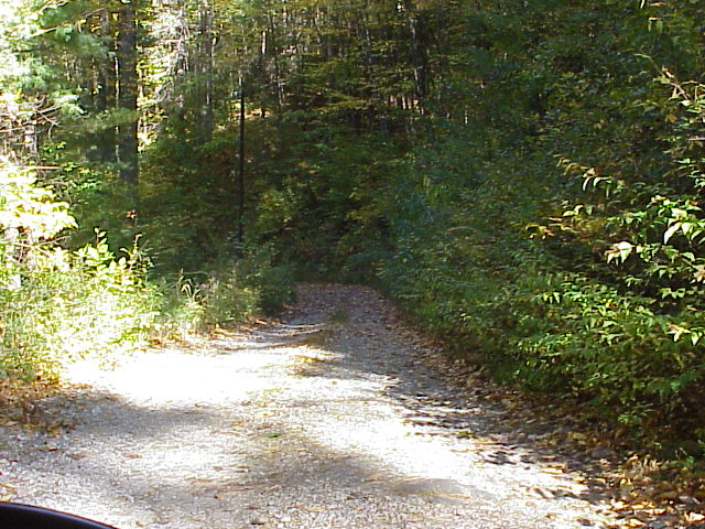

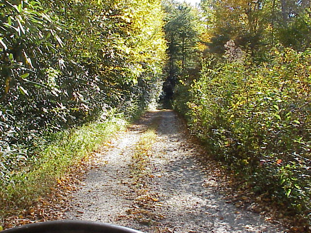

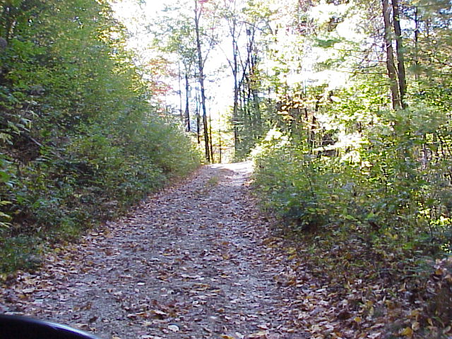

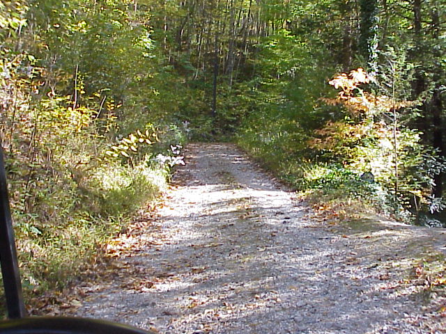

...there are about 8 residences along this road that is entirely private...landowners actually own the road and pay taxes on it...the only ROW is granted for telephone and power...
Around here, if you had 8 residences on that size road, you could very likely have the county "annex" the road and have it paved, as well as have the county maintain the ROW's. That may not be your wish / the wish of the other homeowners?
Another thing that comes to mind... 8 x $150 = $1200. Perhaps your neighbors would be willing to put some type of agreement together that the equipment would be community property, and that you would (so long as you are able) operate and maintain said equipment for the puprose of clearing this ROW X number of times/year?
the road is 100% private property...the only ROW is allowed for utility lines and we mandate what they do as far as "trimming"... the last thing we want is a paved road...access on this road is by right of egress by the land
owners...
there is only one full time residents...we hare here about 8 months...the rest are "weekend warriors"
as for another type of mower...nothing else would work...to use a pull behind mower the tractor would either need to be in the ditches (impossible) or on much too steep of slope to operate...(side of the mountain)...if you drive off this road on the low side the only thing that keep you from going all the way to the river are the trees...
the only alternative to a sickle bar is hand held string trimmers...
