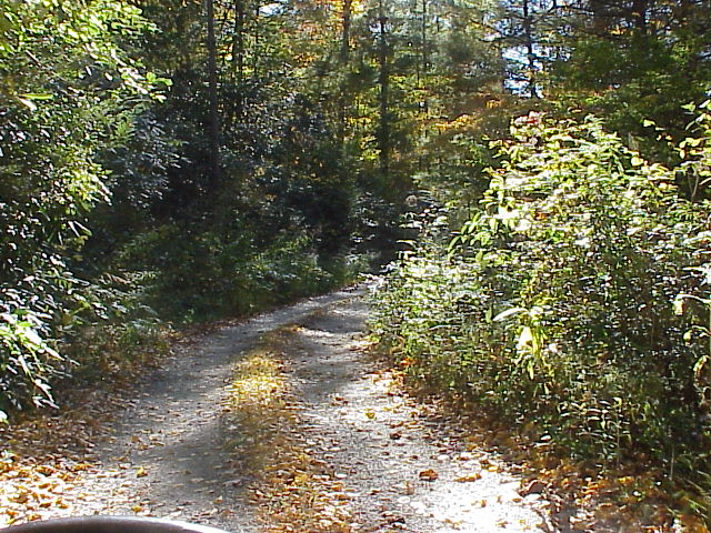

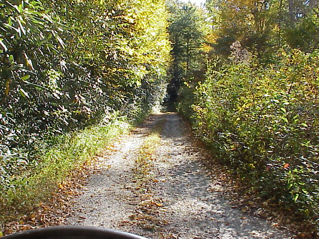

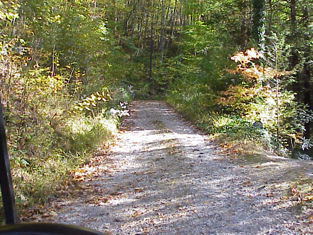

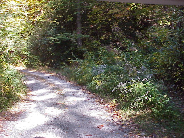

Here are some pics of the road sides and ditches I am looking to use a sickle bar on...the ditches are mostly hidden by the weeds etc...

/ General questions about Sickle Bars #30
Have you considered just hiring this job out?
/ General questions about Sickle Bars #31
I guess that if all that were mine and I really wanted to keep it mowed (which I would), I would either hire it out or be willing to invest in my own equipment. Just a heavy duty gas powered hedge trimmer or decient chain saw costs $500. You might have to pay more for a sicklebar especially if it has hydraulic lift/angle control which you need.

Something that I should mention is...trimming along this road only required after all the blackberries are done...and it only needs to be trimmed not "cut back"...there are about 8 residences along this road that is entirely private...landowners actually own the road and pay taxes on it...the only ROW is granted for telephone and power...
The only mowing required is to keep the ditches visable to prevent visitors/guests from thinking there is a shoulder (it is one track and there are a couple of wide outs when an incoming meets an outgoing vehicle...someone has to back up)...and the side banks only need an occasional trimming to prevent scratching of vehicles...none of the residents want it to look "groomed"...we like the natural look...
