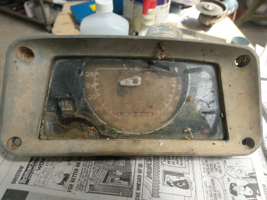

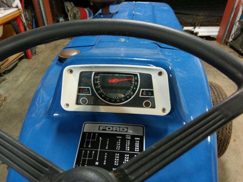

I've had to put the tractor restoration aside for the past couple of months due to some more pressing jobs, this week I finally got back to doing some more stuff on the tractor so thought I'd resurrect this thread.
The instrument cluster was in a sad state
I found a clip on youtube
Instrument Panel Renovation - YouTube
where the guy reconditions the same cluster, got in touch with the very nice chap from Missouri and he sent me a copy of the photoshopped repaired fascia he has created. I did essentially the same process Jim shows in his video, plus repairing the broken needle. Before reassembling the cluster I tested the voltage stabiliser and it was shot, I replaced it with a DC to DC converter from eBay, by pure chance the eBay component mounted to the same holes on the cluster casting that the original bimetal stabiliser was screwed to.

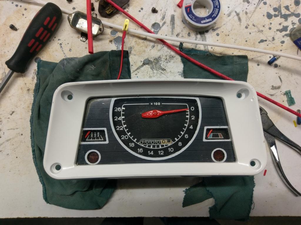

I used a modern silicon sealant to seal the two halves of the casing rather than the strip of cellophane tape originally used. I also made up a sachet of silica gel by emptying a teabag and refilling it with silica cat litter, glued it into a void inside the cluster to absorb moisture out of the assembly and hopefully avoid condensation.
The cluster came up pretty well with the photoshopped fascia, repaired needle and fresh enamel on the surround.
   / General freshen up of 1967 Ford 4100 #43
Great work.......
Do you plan on calibrating the tach?

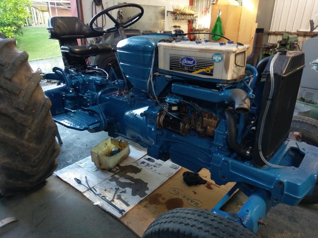

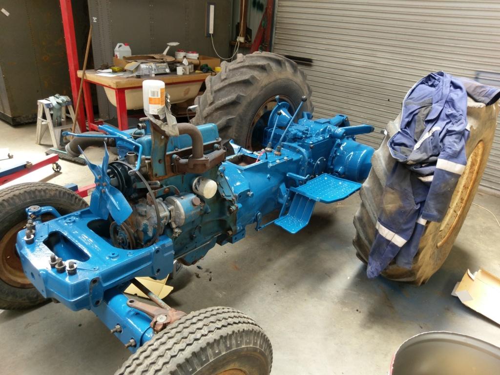

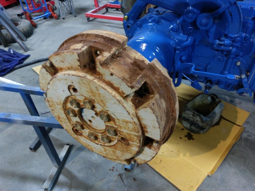

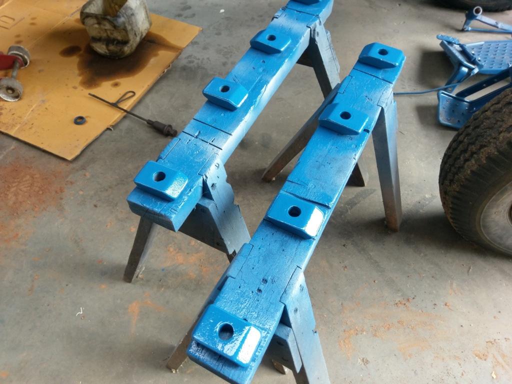

I've got the tractor back in the shed to continue the 'freshen up' that has turned into almost a complete restoration. Fitted up the reconditioned instrument cluster, here it is insitu- I decided to zero the hour meter, given the fact that it had not been working for an unknown period, the numbers displayed were meaningless. At least now it will reflect a known starting point.

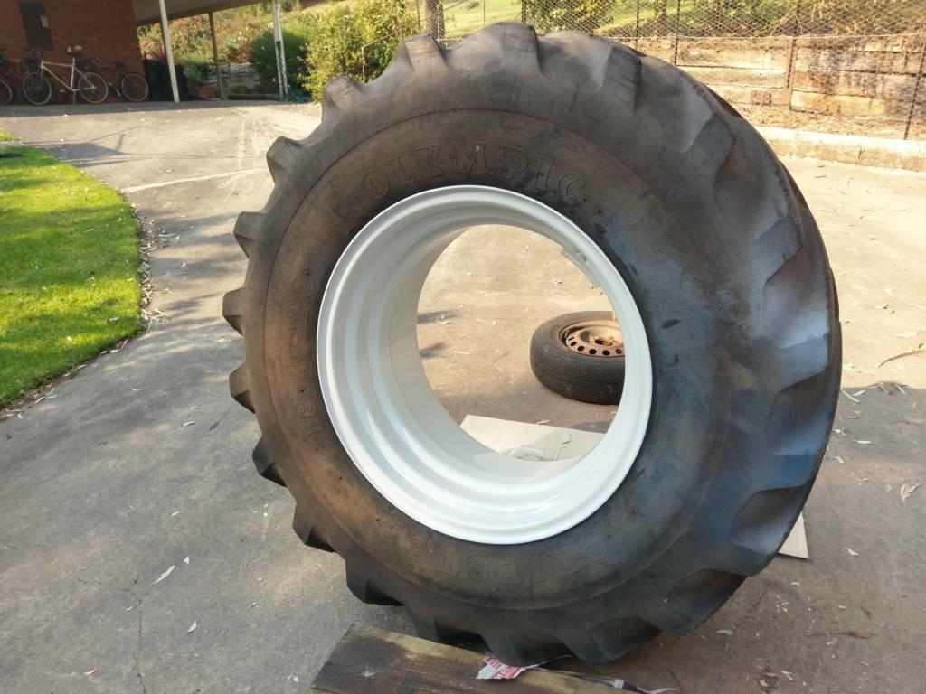

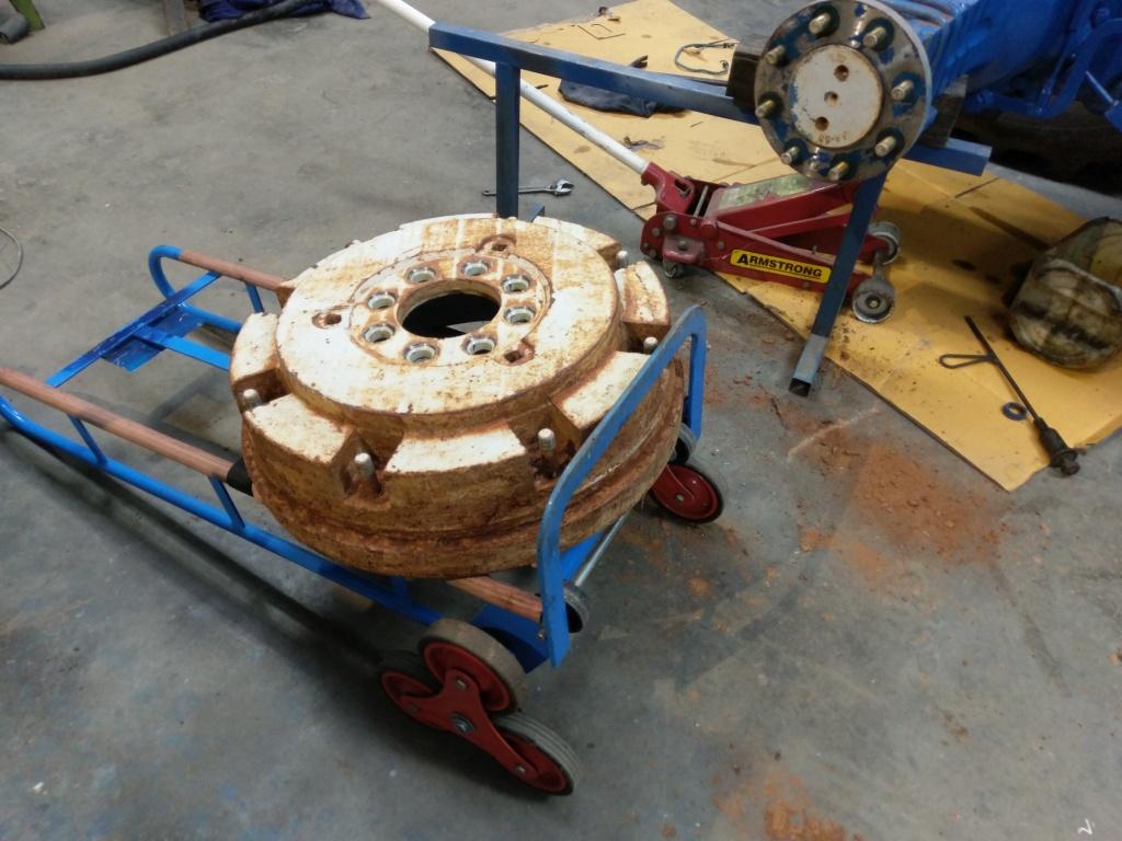

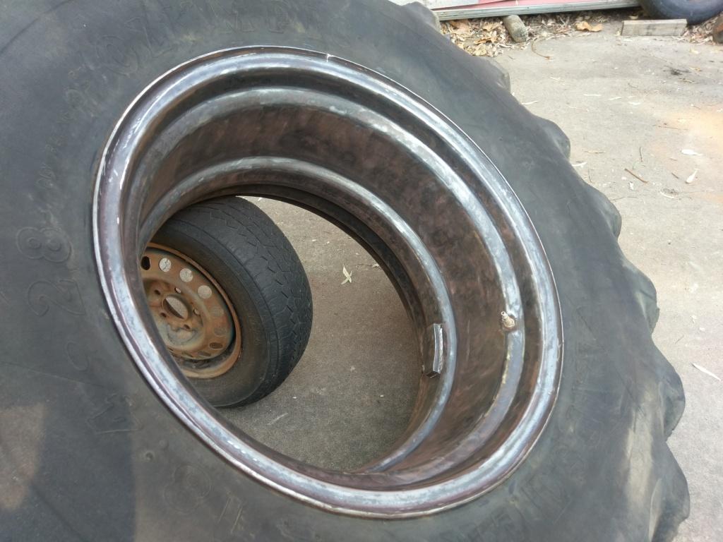

Made a start on stripping and painting the wheels, one rear wheel done so far. Wore out one wire cup wheel on the angle grinder cleaning this up.
That wheel centre casting is incredibly heavy, I had water ballast in the tyres but I suspect it may not be necessary with those wheel centres.
A bit of contrast was in order for the retainers
The end result is certainly an improvement. Who needs mag wheels.:)
I should get the other rear wheel done this week, then both the front rims.

G'day Pete looking the goods would prob recommend water in the tyres still it helps alot with traction and stability
Jon
Jon
Yes, on reflection, with the loader and my hilly property I don't want it less stable than it was, so water will go back in.

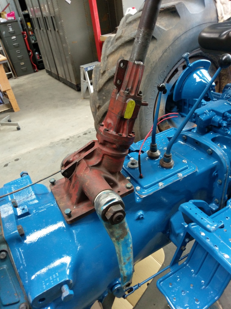

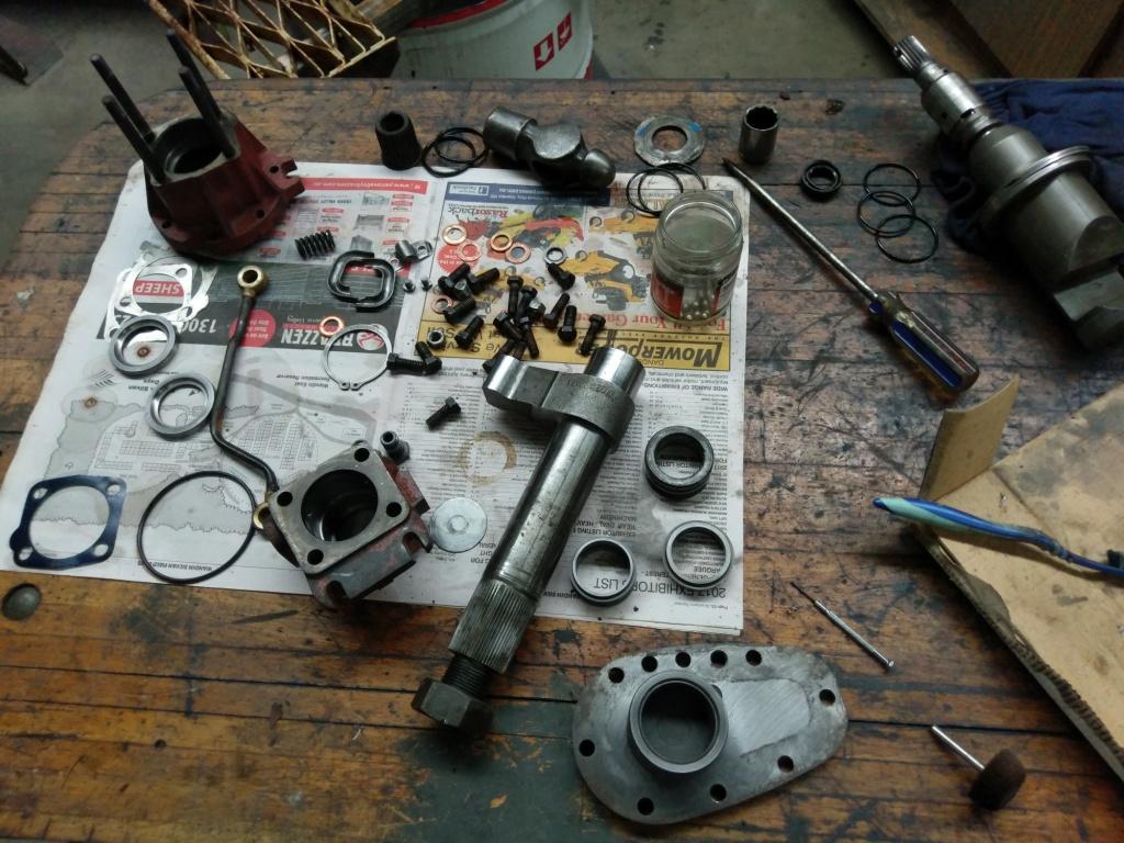

Managed to get a little more work done on the tractor this week. Frustratingly, part of it was re-doing something that had already been attacked; the shaft that I built up with epoxy way back in post #2 of this thread was leaking hydraulic oil. i did a little firewood carting with the tractor a few weeks ago and when it got warmed up, it was marking it's territory.
This shaft runs through the bottom of the rear axle casing, the three pedals pivot on it. The problem was nothing to do with the epoxy repair- which was outboard of the axle casing- but the area that the seals run on was very finely pitted. I tried polishing it in the lathe but could not get the pitting cleaned up enough to risk putting it back together a second time. The following picture shows the pitting at the seal area.
I made up a new shaft. The small end, which is where the right-hand brake pedal pivots, is 1" diameter, the rest of the shaft is 1 1/8". There's a woodruff key that takes the torque from the left-hand brake pedal- the keyway is facing down in the photo- had to use a friend's milling machine to cut the keyway as mine is out of action. I re-used the lever arm off the end of the old shaft.
After re-assembling and refilling the 38litres of hydraulic oil, I got her warmed up again today and there's no leak. Hope it stays that way, I hate doing a job twice. Three times would be a real pain.

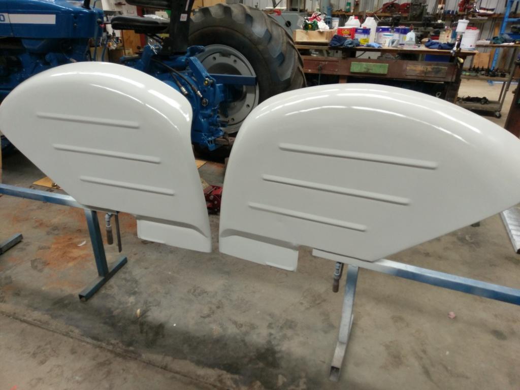

The old mudguards were rusted out beyond repair (beyond my panelwork skills that is) so I ordered a replacement pair, they are slightly smaller than the originals so I had to fabricate a pair of brackets to raise them 75mm. Painted them up:
and made a trial fitment today, needed to confirm the brackets work before I paint those.
Next task is to remove, strip and paint the front wheels. I'll paint the mudguard mounting brackets whilst I've got the white paint going. If my calculations are correct, I'll then be able to move on to reconditioning the loader.

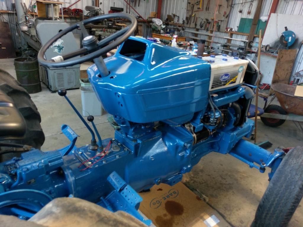

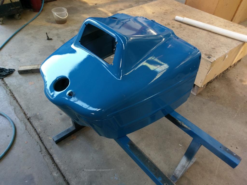

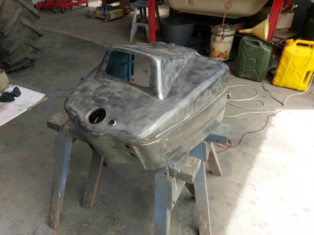

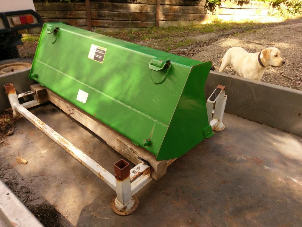

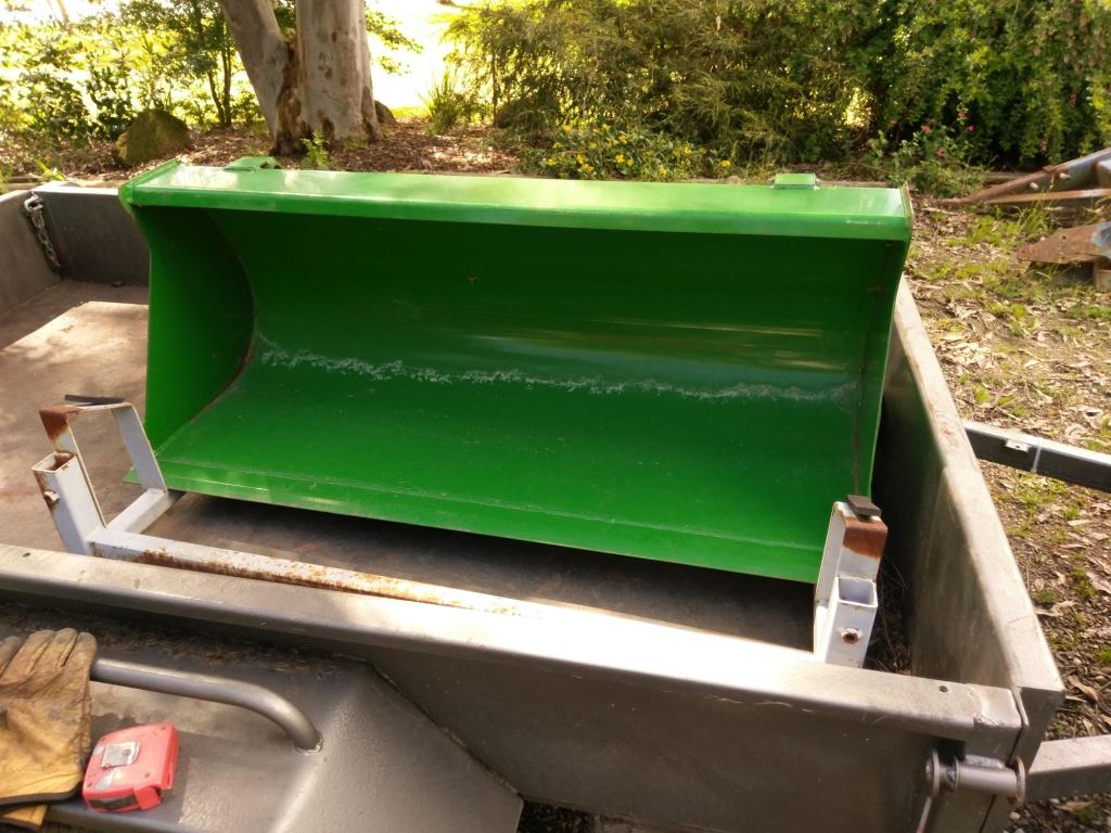

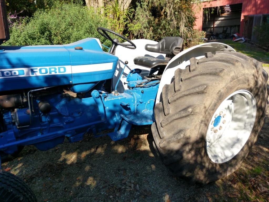

I've had a few family crises preventing much progress on the tractor refurb over the last little while, but I finally got a few things painted, got the tractor back on her feet and officially in a useable state, although there are still a few details to sort out. Also finally got it out of my workshop so that some other projects can get some attention. The FEL overhaul will have to wait until the weather warms up a bit here.

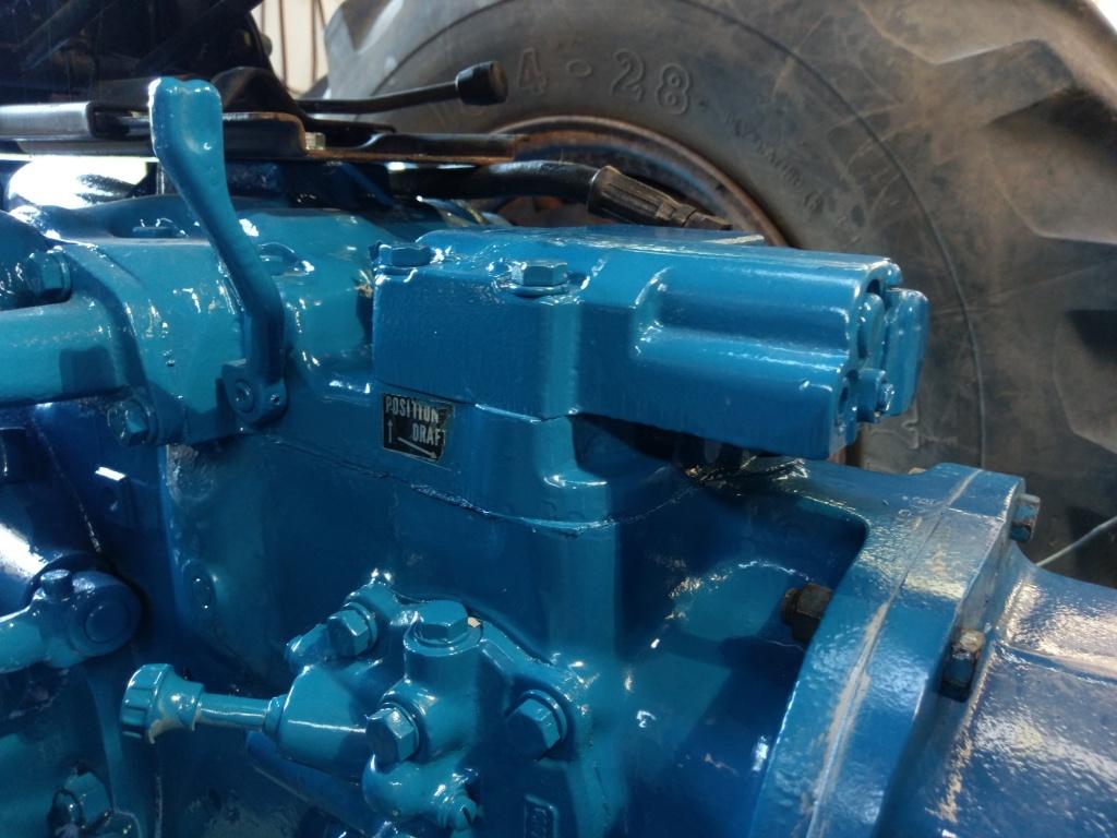

I needed the little turnbuckle assembly on the draft contro arm but it isn稚 made anymore so I had to make one.
   / General freshen up of 1967 Ford 4100 #58

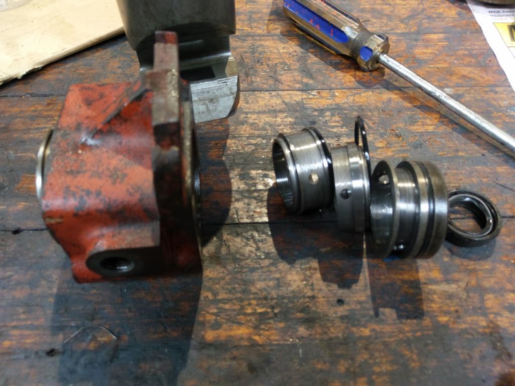

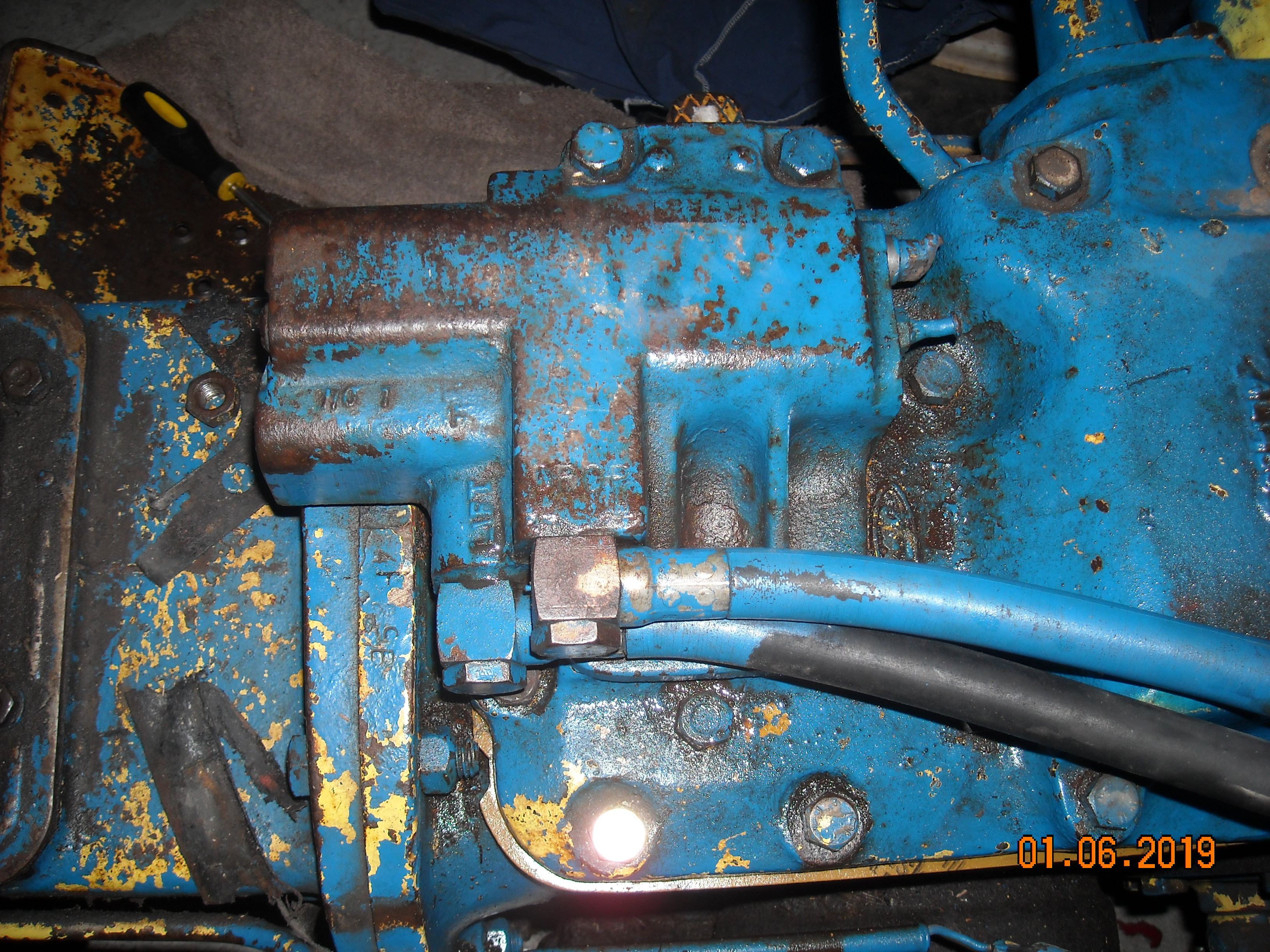

so, you were able to get your selector valve apart? Were there any press type covers on the valve or could you unscrew a cover to get to the Valve? DDSCN0233[1].JPGid your valve look anything like mine?

so, you were able to get your selector valve apart? Were there any press type covers on the valve or could you unscrew a cover to get to the Valve? DView attachment 587021id your valve look anything like mine?
Hi Slim, haven't looked in here for a while so I was surprised to see this thread back on page 1. My diverter valve is the same as yours, I thought I had posted some details of when I dismantled it but I just looked back over the thread and there's nothing on this. It was a pain to dismantle, only because all the moving parts were gunked up and seized just like the rest of the machine. There's a plug / cap in one of the openings at the top left of your photo that has to be prised off, I don't recall what was behind that particular cap but there's a shuttle valve that is supposed to move freely in one of the bores. Mine was stuck solid and I had to make a small expanding mandrel for a slide hammer to get it out. Once it was all cleaned up, the parts slide freely so you may be lucky and be able to dismantle it without having to make any special tools. If I can find any photos of mine dismantled I'll post them here.
