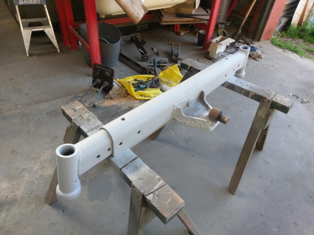

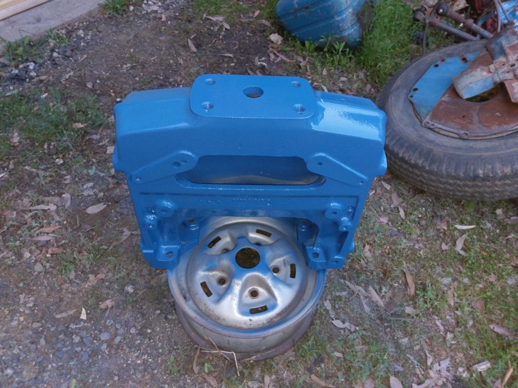

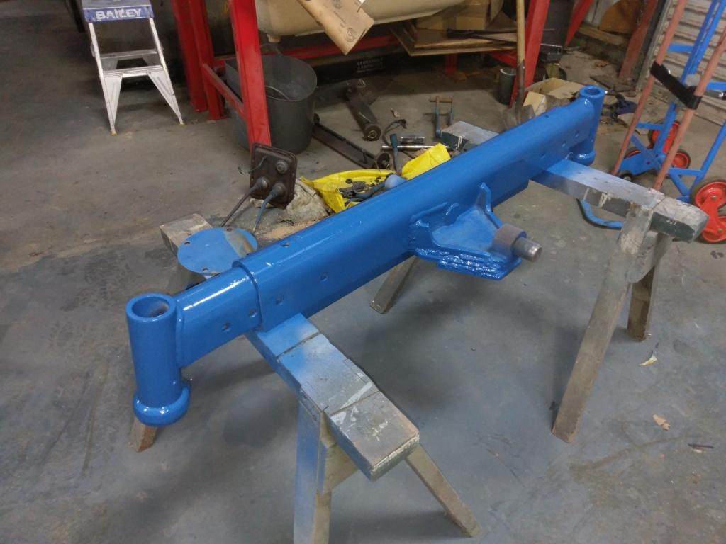

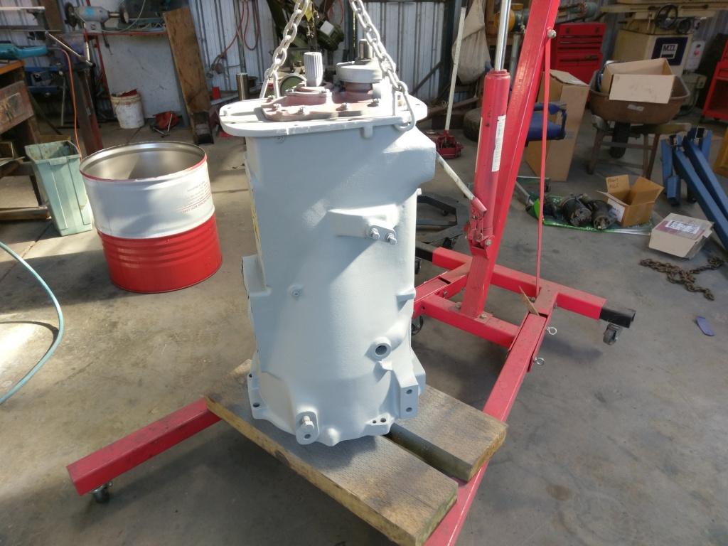

I painted most of the small items today
then moved back onto the front axle. I'd been waiting on genuine seals for the front hubs, having found that generic seals from the bearing supplier won't work. I got the l/h hub and spindle assembled, then started stripping down the r/h hub. Pulled the bearings out and then scooped out the old grease with a gloved hand prior to washing the hub out. Apparently this is not always done- the grease was slightly lumpy. Several loose bearing rollers and a chunk of broken bearing shell were floating loose in the hub. I double-checked the bearings that had come out, yep they're worn but intact. Someone has previously had a bearing failure and has fitted a new bearing without even getting the big chunks of the old one out!

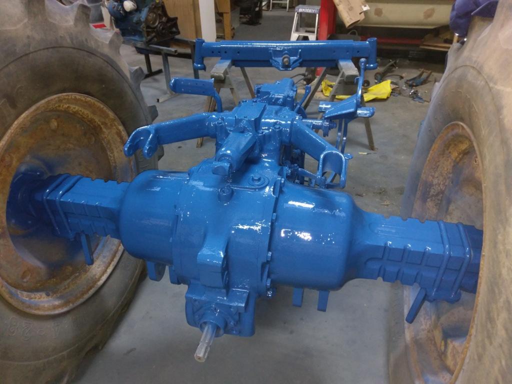

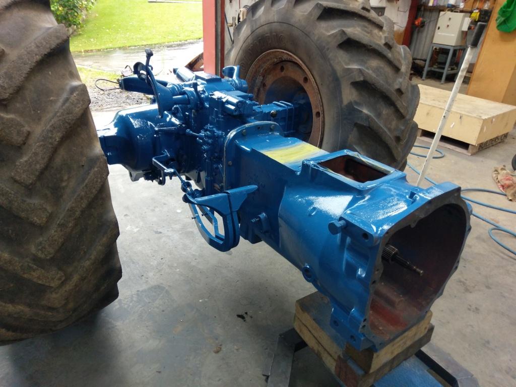

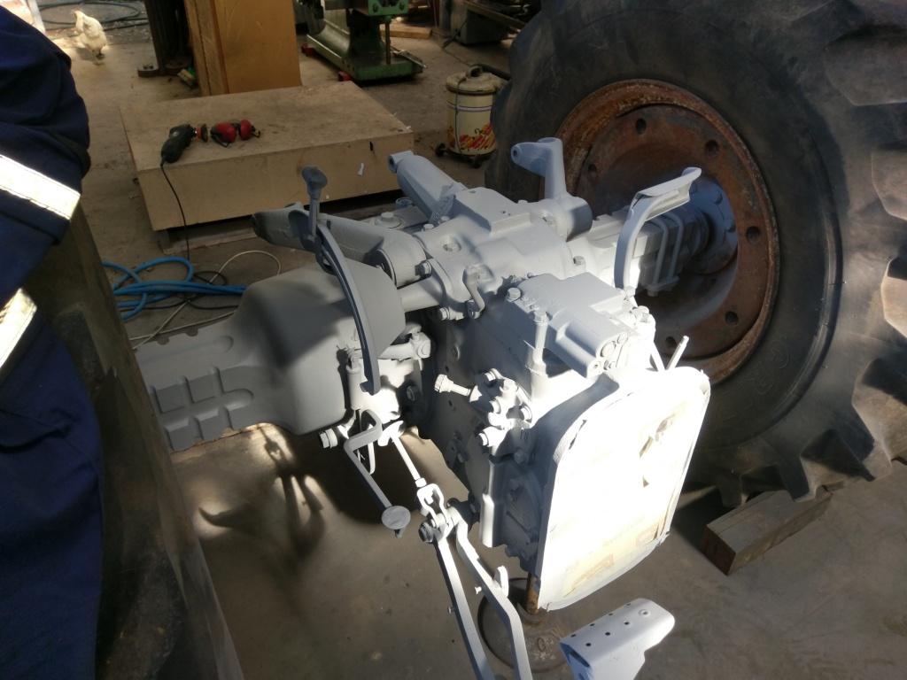

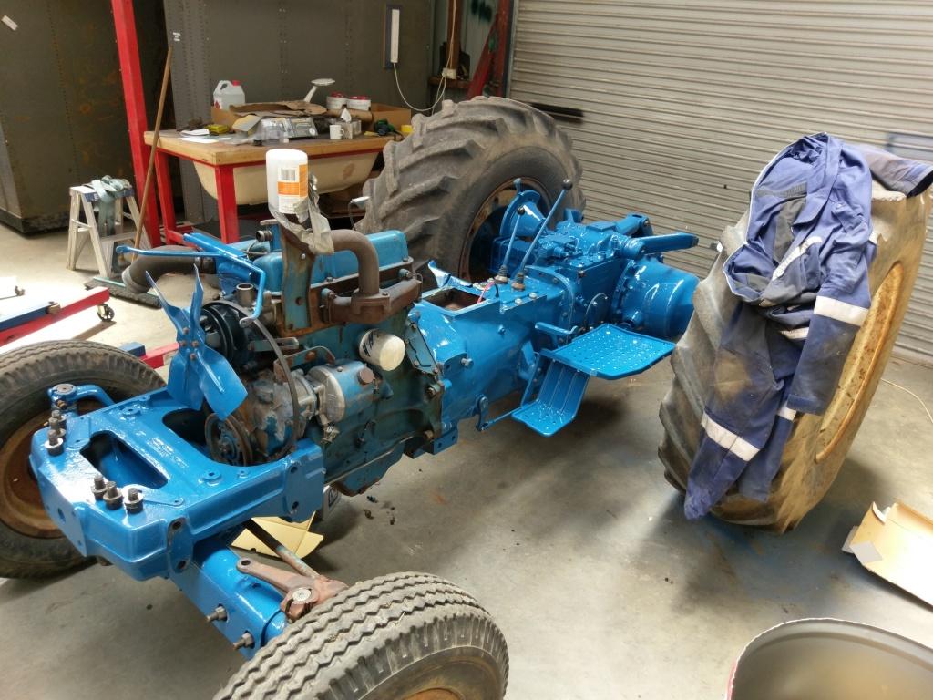

I got the main assemblies of the tractor back together last week. I was going to make a clutch alignment tool but I figured I have always lined up car clutches by eye, I read somewhere once that the human eye is very good at determining concentricity. So I eyeballed the spigot, friction plate and the PTO drive splines in the pressure plate, and rolled the two halves of the tractor together. had to rotate the shafts as it went together to align the splines- the big hole in the top of the bell-housing where the steering goes is very handy for this. Over the past few days I've got a little bit of time to start attaching footplates etc.

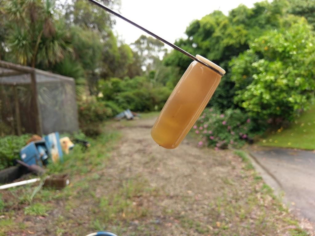

I drained the tank, will fill it with water before welding. I pulled the fuel sender out, the float is half-full of diesel so one more thing to fix. I guess I'd better check whether the sender actually functions before I try to repair the float, everything else on the machine has needed replacing so no reason why the fuel sender should be any different.

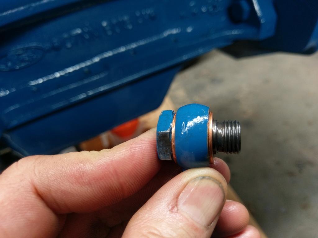

The other leak in the power steering is still a problem; I picked up some new copper washers when I dropped the pipe off, however the non-threaded part of the fitting is too long for the washers to seat. I tried stacking with one of the old washers (annealed) but this solution did not hold the pressure when bleeding the system; as soon as the steering hit lock, oil sprayed out. Might have to stack it with new copper washers but unfortunately I only bought four.

I tackled the power steering leaks again today. New copper washers, stacked to achieve the necessary thickness, solved the leaking pipe banjos but once that was sealed, as soon as the steering hit lock, oil sprayed out of the side cover gasket.

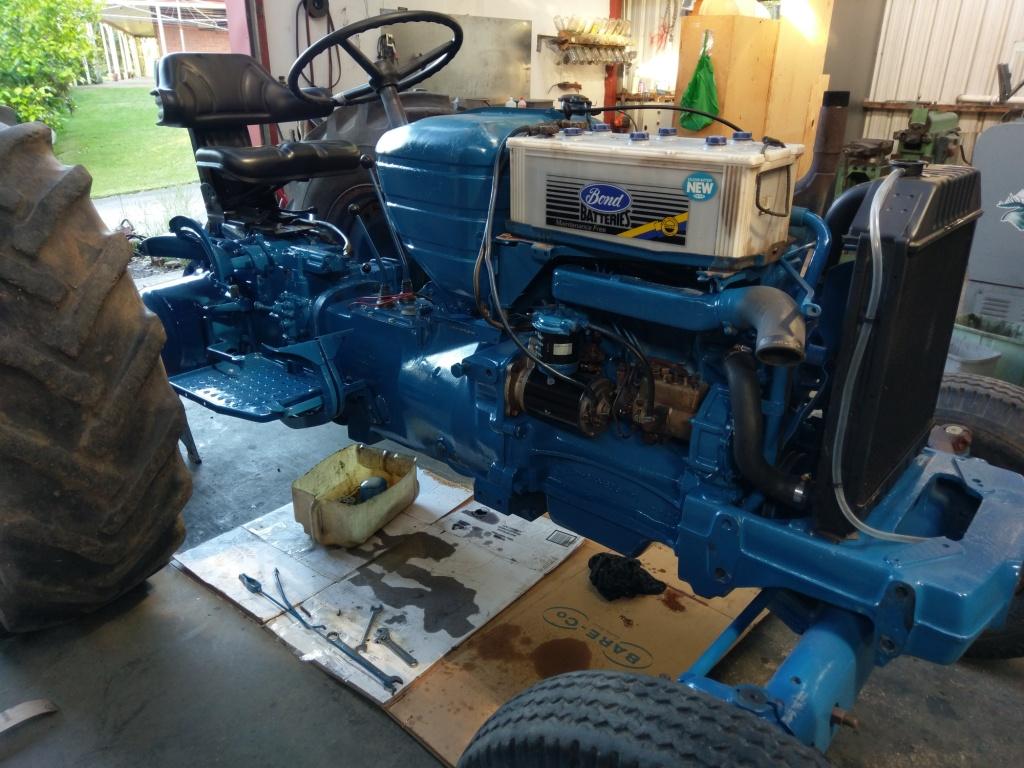

Got the wiring done today, then hooked up the throttle linkages, fitted the cowl, installed the new stop cable and DROVE the tractor out of the shed:D Still plenty to do on it but it was nice to get it out of the way for a while, I gave myself a Christmas present by working on a project other than the tractor for a few hours.

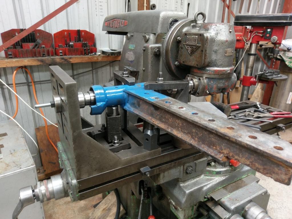

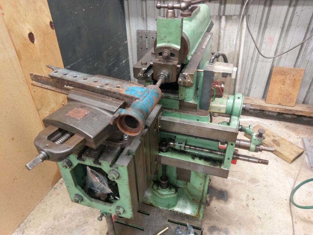

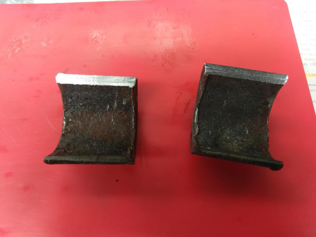

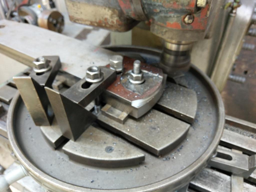

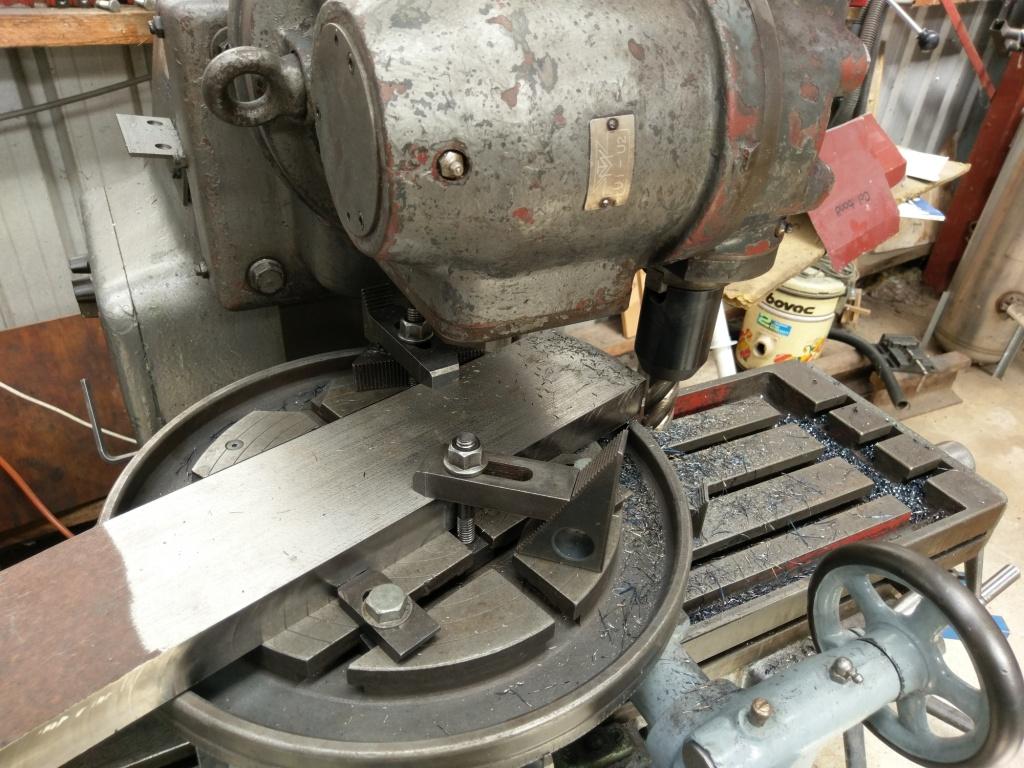

I took a break from panel-beating the badly damaged front cowl (I absolutely HATE panel beating) and whittled a drawbar from a forklift tyne. I've never had a drawbar for this tractor so have always had to pull from the 3pl, this should be much better. Steel other than the 'mild' variety is impossible to obtain here other than in round bar, so I pick up scrapped forklift tynes when I can.
Got the tapered side flat and to the required thickness on the shaper, then radiused the inner end on the mill
Bored a 1" hole at the tractor end, then a 7/8 hole for a standard towball plus a 1" hole for a heavy shackle at the outer end, then radiused the end; I initiall put a large radius on it but then decided to re-cut the radius, centering off the shackle hole so the shackle can swing. Had to taper the inner end as I have made this somewhat wider than the original would have been.
A surprisingly time-consuming job but it sure beat working on that cowl. I had no intention of engaging in panel work when I started this project but having put so much time into it, I can't put a beat-up panel back on the thing.

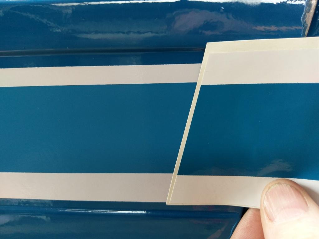

I got the front cowl and the two halves of the engine cover painted and installed. Today I fitted the new decals to the sides.
The BareCo decal kit was really appalling quality, the stripe on each side is in 3 pieces as it goes on 3 panels. The 3 pieces were different widths, the blue was a different shade from one piece to the next and the long white stripes had a crooked edge that looked like it had been cut with plastic scissors by a 3-year-old child.
I used a straight edge and a scalpel to trim the crooked edges, in the first photo you can perhaps see how straight the decal isn't when compared to the straight-edge.
This photo showcases the varying shades of blue, as well as the different widths.

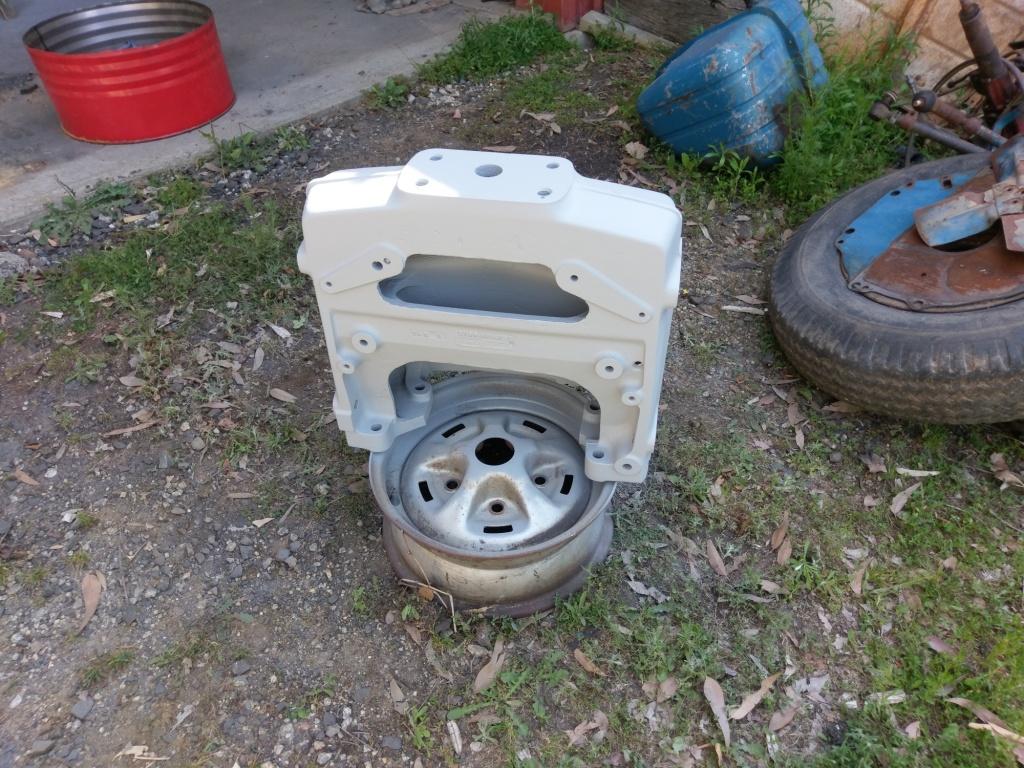

I need to do some work on the mudguards and strip the wheels and then do some white painting, also obtain a grille and an instrument cluster. Getting there.
