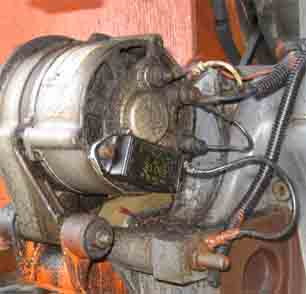

This alternator is on a LUll telehandler, but it is not working. I took a meter and can't seem to get much out of it when it is running , but where would I check?
I assume it would give me 14+ volts between the bottom bolt obviously grounded and one of the top two, but no go.
Any suggestions?
Thanks.

Not familiar with the telehandler but I would check the volts at the battery with the engine off and then running and then with a load like headlights on to see if you get any different readings at the battery.
Looks like it has a built in voltage regulator, (black box). Can you remove it and have it tested by a rebuild shop?
What were/are the symptoms that make you suspect it is bad?
Could be bad regulator, alternator brushes, diodes, winding- hard to say without more info.

From the looks of it the bottom right stud that has a wire going to the mounting bolt is going to be the ground. The center stud looks like it has a heavy gauge wire going to it and is probably the output terminal. The top stud may be a accessory tap for something like a tachometer or may be a external sense/excite wire. With the engine off check the voltage at the + output terminal. Start the engine and it should increase to around 13.5 volts.
Are you having starting problems? Like Coyote machine just wondering what the problem is. If it has been setting for a extremely long time without running it is possible that the rotor has lost it's residual magnetic charge and needs to be remagnitized. Does the voltage increase at all when the engine is started?

with out knowing the specifics of it i cant say for sure.
but most 2 wire alternators (which it looks like it is) require a second 12v source to engergize the feild before it will start generating current. with out that source it will seem as if the alternator is bad (not produceing any voltage)
if you know the connections are good (good 12v on feild wire) then the second most common failure is the rectifier (the thing that takes the AC current and turns it into DC current)

G'day as said earlier i think you need another wire going into the back prob a blade push on terminal it should be running through a light on the dash and if you have got a wire like that near the alt put a test light on it and it should power up with the ign on. Hope this helps:)

usually, an oil pressure switch will tell the alternator to turn on, giving it the 12v needed to make 14v

Too wet to play outside today, but there are some disconnected small wires. I will see if any of those wires power up with the key or if they are always hot. Now where would I connect one of these wires to the alternator? I don't believe this machine has any lights on the dash, but I have an idea of where to start.

G'day a little bit hard to tell from your pic but look in the back of the alt between the two term with the wires on them and look for a male blade term looking at you:)

The problem is the machine wont start after a while due to dead batteries, but it is manageable if I put it on a charger once in a while, but I figured I should look into fixing it up.
Was working on the roof yesterday (I am using the Lull to do this) but poked around the alternator beforehand. The middle bolt has the same 12.3 volts the battery does all the time, so I assume this is the feed to charge the batteries if the alternator was working. The two loose wires that hang around the alternator don't have any power, key on or not, but there is no obvious place for them to connect to the alt.
Turning the key on does get the electric fuel pump clicking, and the oil temp gauge will move, but it wont start the machine due to a bad solenoid so I have been starting with a crowbar(working on that too, any one know where I can get a UNI POINT solenoid, UNI9-11???)
THere ARE some lights on the dash, but they don't work. The dash had been painted and the stickers removed, so I don't know what these lights refer to, but it is logical that one is the charging light as has been previously stated.
So now what? SHould I jump another wire some where on the alt to try to energize the field? SHould I look at testing the regulator? THis is one of those things that is a minor inconvenience so I don't want to spend much time and money on. I have some other alternators laying around, but I want to rule out that it is the alternator first vs some wiring issue.

G'day can you get a better close up pic of the back of the alt along with any markings on it and post?
