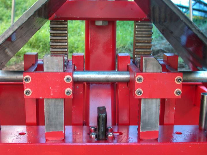

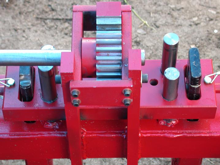

Scott,...I cheated in the lapping process. I gave up with the compound and ended up getting a 60 grit flapper emory cloth wheel Ø1" and shoved it in there and buzzed the heck out of those holes. The only problem with that is if there is too much clearance, and the lift block cocks while being raised or lowered, it locks up. So this is what I did to reduce that problem and it worked out. First, I left the fit a little on the tight side. I was able to move the entire scarifier assembly up and down with the manual handle so I knew the 2 ton hydraulic cylinder would still move the assembly.(another reason I chose the HD 6 pitch teeth) In this way I knew I was still locating on all 4 guide pins. I also installed grease lines with Zerk fittings and an interior woodruff cut to lubricate the guide pin holes.
Then in placing the location of the lifting rack, I put the pitch diameter centerline smack on center of the lift bars. This meant I also had to locate the gear centerline to keep that relationship. The gears are held in position by the bars which I welded to the boxblade. I could not gaurantee those bars that hold the gear assembly would be bang on after welding. That's why I cut slots in the side plates so I could slide the gears to match the centerline of the rack. The key was to have the lifting force in the center of the riser bars so they would not bind up and it worked out. Here's a picture of the relationship. The blue rectangle represents the riser bar from an end view.

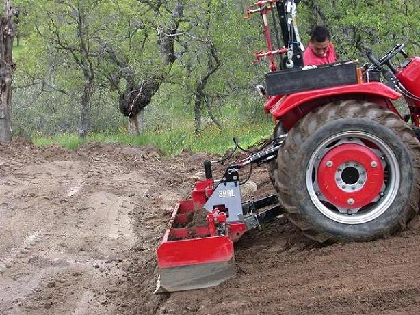

I also wanted to update you and let you know that they work great. You can't believe how fun it is to change the position of the rippers while driving. I finished that pad I was grading for my battery storage building and could cut down the high spots while driving over. Then raise then up so as not to cut too deep where I didn't need to. The added weight to the boxblade and the re-inforcement to the scarifiers showed up when I hit hard decomposed granite. I was able to cut through it and level it out with ease.
I know it was a lot of work, but it turned out too good to be true! I'm not a spring chicken anymore so anytime I can remain in the seat, less jumping on and off the tractor, the more I like it. Mostly, I was so happy that it worked so neat. This one was truly gratifying.

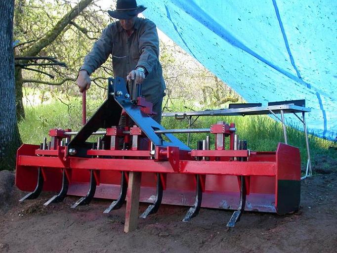

Well, I uploaded a video of the boxblade working all the functions. It's pretty neat to watch the mechanics and hydraulics. It's about 40 seconds long or so and 12MB so it might take a bit to download. Hope you can view it.

Did you sacrifice any adjustment on the scarifiers with the new setup or do you still have the same amount of up and down movement? Obviously you have a finer adjustment with more control, just wondering if you sacrificed any on the up and down?

I chose 4" of travel, figuring that would be plenty of dig depth when the boxblade is level. When tilted forward all the way, it looks more like 6" to 8"? (Not sure exactly.)
I could have used a longer stroke for the system but figured this would be good...and it is. I don't think the tractor would pull much more when they (all 7) are burried all the way in hard ground. The shanks I bought at Agri-Supply are now in the middle top hole, so I could set them one or two holes down more, but as it turned out, I don't need to. That means I can now by the shorter ones for $10 ea. if I need to replace these.
