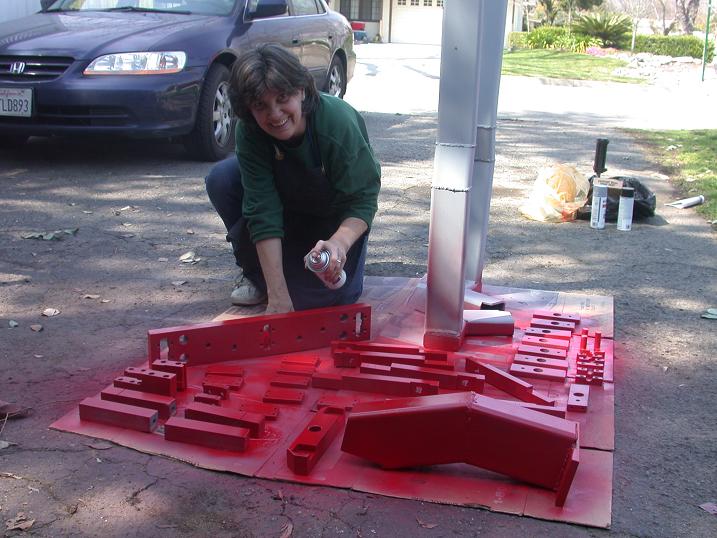

A little paint does wonders, doesn't it?...Thank you Loretta!

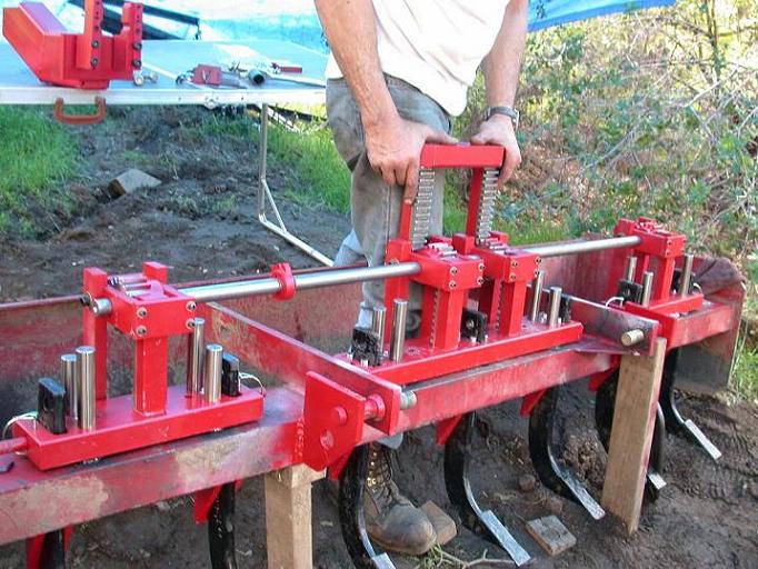

Here it is with the rippers down. I was able to move the system easily with the manual handle for "bench testing" the system. Later when hooked up to the tractor hydraulics, it worked like a dream...way better than I thought it would.

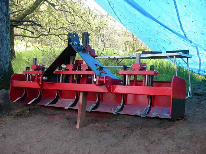

So there you have it.
That's what I did on my vacation last week. Worked my @$$ off on the darn implement improvements. I will say it was very gratifying to have them come out as good as they did. I am sooo pleased. I have a couple of short videos showing the new boxblade in action where am cutting down a bank above a graded area to creat some slope, not such a sharp drop off. So I back up the tractor, lower the scarifiers down, lower the boxblade and take a big rip off the edge. Then I raise them as I pull away form the edge so I don't rip the entire area.
Here's my last picture for tonight showing the boxblade in actions.
Hope you enjoyed the story.

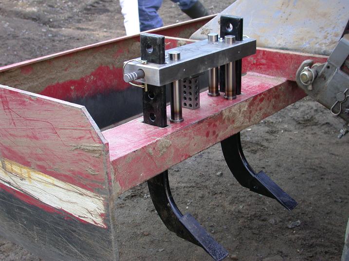

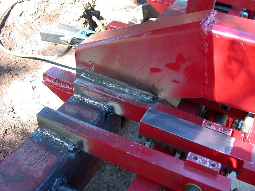

This is a close up of one end riser bar and gear assembly. These end ones hold 2 scarifiers. Notice there are no retainer rings or cotter pins to keep the shaft in place. This is because each gear is keyed and the key/gear/shaft are held between those side plates locking them in place but out of sight. This made for tricky, sequenced assembly. I will also add protective covers to these after the photo session.

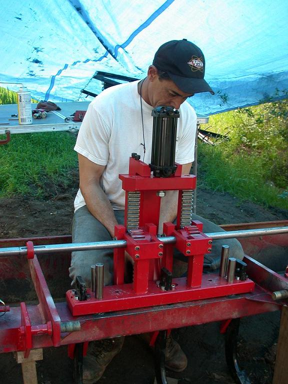

This picture is a close up of the center riser bar that holds 3 scarifiers. It has the same gear/rack relationship as the outside ones except additionally it has the racks coming from the hydraulic cylinder on the opposite side to power the drive train. When the cylinder pushes down, those racks turn the gear which in turn "lift up" the racks that are bolted to the riser bars. The gear acts like an "idler" gear in this instance. I did have to keep the distance between the gears/racks reasonably close to keep the proper running clearance between them and avoid "jumping" off track.

I figured the entire assembly including the re-inforcement for the shanks added approximately 350 lbs to the boxblade. I think the original 7 footer weighed in right at 600 lbs to start.
Surprisingly, the overall cost was not nearly as much as you would think, the hydraulic cylinder was $40 on eBay, hydraulic hose were $25 from Ag supply and the rest was scrap metal and bolts I had lying around in the garage or bought at scrap price...less than $150 and that included the backhoe subframe steel too! OK, so the retro-fit design and machining might be expensive if you hired it out, but in this case I did it all myself so it cost me nothing, except missing a few rounds of golf. It was actually really fun to build this stuff for a change! But you are right, it turned out beautiful for a tractor implement. Thanks.
So here's a closeup that shows the back of the center bar and the support mount for the hydraulic cylinder. You can clearly see the clearance I had to cut into the boxblade brackets for the entire shaft and also when the riser bar and shanks move up. Again, the final assemble required having them on the blade while each gear set was assembled with keys. You can also see the 2 sets of bolts and clamps that hold and position the hydraulic cylinder to it's mount here.

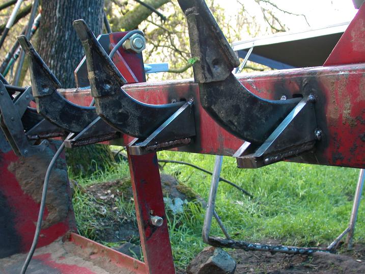

There's no reason you couldn't do it. Just be sure to plan ahead when you measure up your boxblade. What i really like is the added support behind the shanks. They are welded to the boxblade itself and will not give. As opposed to the pivot type, the stress...resistance on its scarifiers is directly translated to its hydraulic cylinder and pivot point...mine is not.

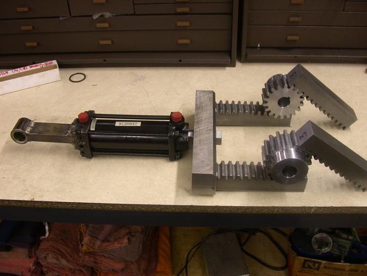

Here's a picture of the hydraulic cylinder bar that holds the racks that activate the system. I pocketed the position of the racks to match up the gear locations.

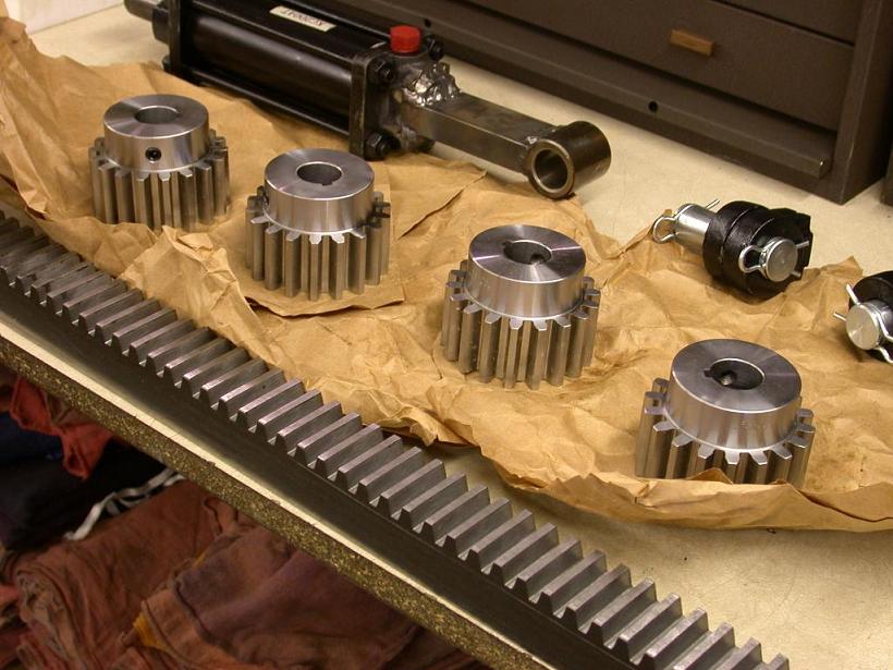

Unfortunately all the spare gears I had were not 6 pitch I wanted so I bought them. I probably should have form ground an involute cutter and machined them up from bar stock using my old dividing head like the old days. But I had my plate full knowing I'd only have one week of vacation to finish this project and the backhoe subframe.

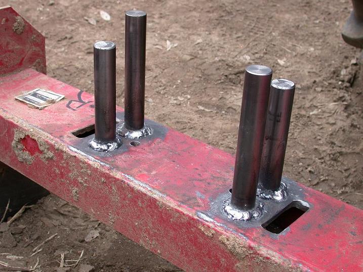

The guide pins themselves are ejector pins that I use in mold making. They have a pre-hardend core of about 36Rc and the outside is a nitrided surface about 65 Rc.
In this picture you can see how I went about positioning the guide pins inside the lift bars before welding. This gave surprisingly good centers but the guide pins still moved and bent from the 2000° welding heat. Keep in mind that the pins are exactly Ø.9995 and the reamed holes are Ø1.0005. If all but one were perfectly aligned and parallel, it would bind up. So I was really lucky to have it come out this good. Heck, I've had guys on my horizontal boring mills do pin and bushing work that did not come out this good at times. /forums/images/graemlins/grin.gif
