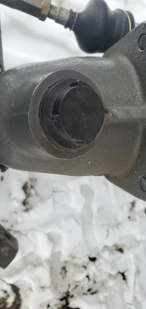

edit, had chance to take pic of 2021 GC1723TLB repo unit sitting here with 125 hrs on it vent.
the black mark is grease from when I messed with it in Nov 2022 waiting for repo. still waiting for that. but whatever.
there is NO hole here on top for vent.
and my personal 2010 gc2400, my neighbors 2021 gc1723, other neighbors 2021 gc1725, and other neighbors 2012 MF1532 all the same.

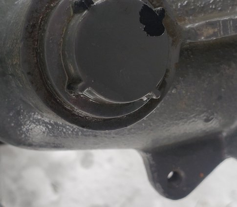

so snow melted on my personal gc2400 (after morning of blowing...35 mph winds SUCK and plow blade going on truck in next 3 months when overstock goes on sale) few minutes ago and I got a pic.
the dab in middle is some silicone from when I installed a block heater in Dec 2020. forgot to wipe it off when fresh. realized I forgot a week later. most gone but a little bit left in center, whatever.
would have thought when blowing out actual vent I would have erased that but...nope. mommy raised an idiot.
