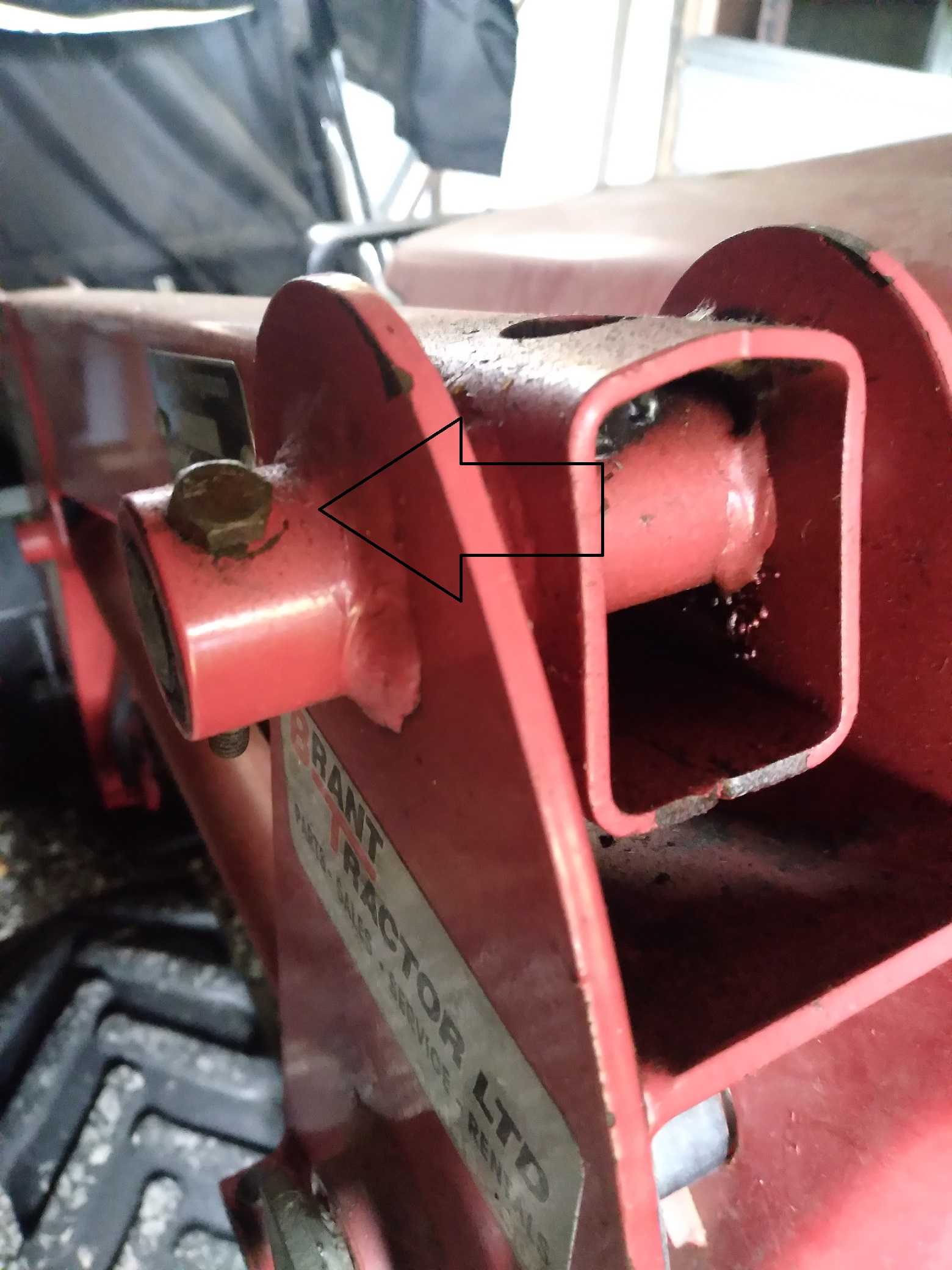

Not sure if this is relevant, but a few years ago the bolt in the loader mount sheared, and the pin started walking out. No visible damage, but no idea why it happened. May be related to frame/loader flex.
