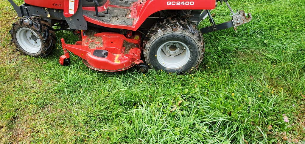

2010 GC2400 (my daily driver, I deal with ditches 36" high on one side and when entering my hood stays down(no actual latch just spring clips) ...as one rear wheel off ground....) , 2021 GC1725M, 2021 GC1723 here.

due to how loader and backhoe brackets mount I really suspect if there is anything loose its the x-member in front of the MMM lift shaft.the backhoe frame mounts actually will not help with side-side flex really. there is no crossover between them. of its a tlb and hoe removed frame flex don't care about brackets on each side. if hoe on the pins prevent flex.

hard to tell but think its item 3, bolts/washers item 4/5 go in from each side of frame to it.
when those are loose/missing there is a bunch of flexing. I know this for a fact.
mine fixed now and...like I said...enter a 36" ditch with one rear tire off ground (yeah 4wd and diff lock used) every time I mow with no flex issues.
hard to tell from pic today (been 3 weeks since mowed) but this left rear tire is 8" off ground. I have to use 4wd and diff lock to orientate myself to mow here.
and no real frame flex.
hopefully it wont rain more this week (like last 2+ weeks) so I can do final mowing for year. grass is 9-15" tall under that rear tire.
