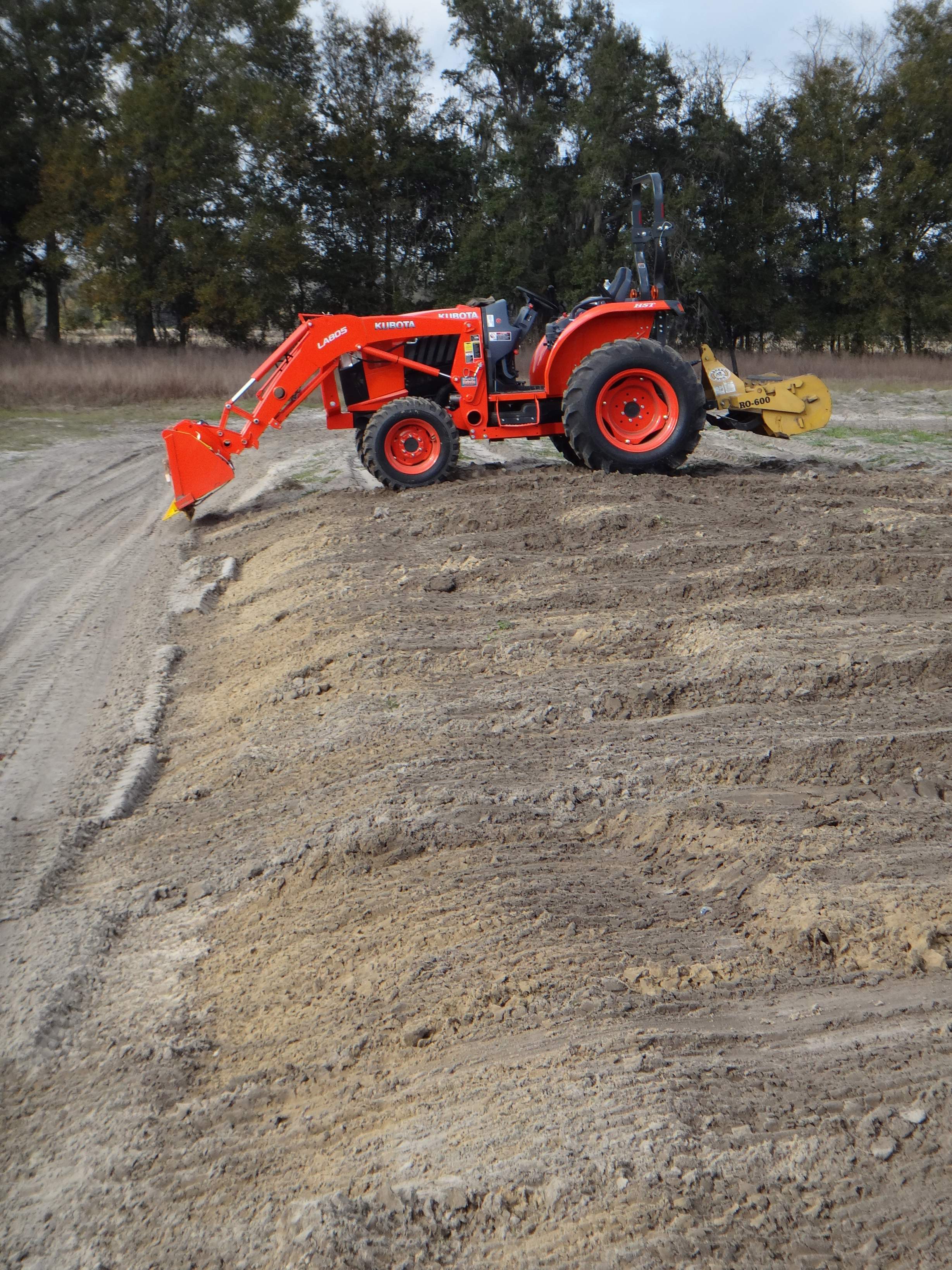

Make a reasoned decisions about your tractor-loader and Box Blade. Put in some hours with the tractor-loader and Box Blade. Then consider what your next equipment purchase should be.
Respondents have different conditions from you. Respondents experience will vary from yours.
In Florida, I am always trying to increase the organic content of my sand based soil.
