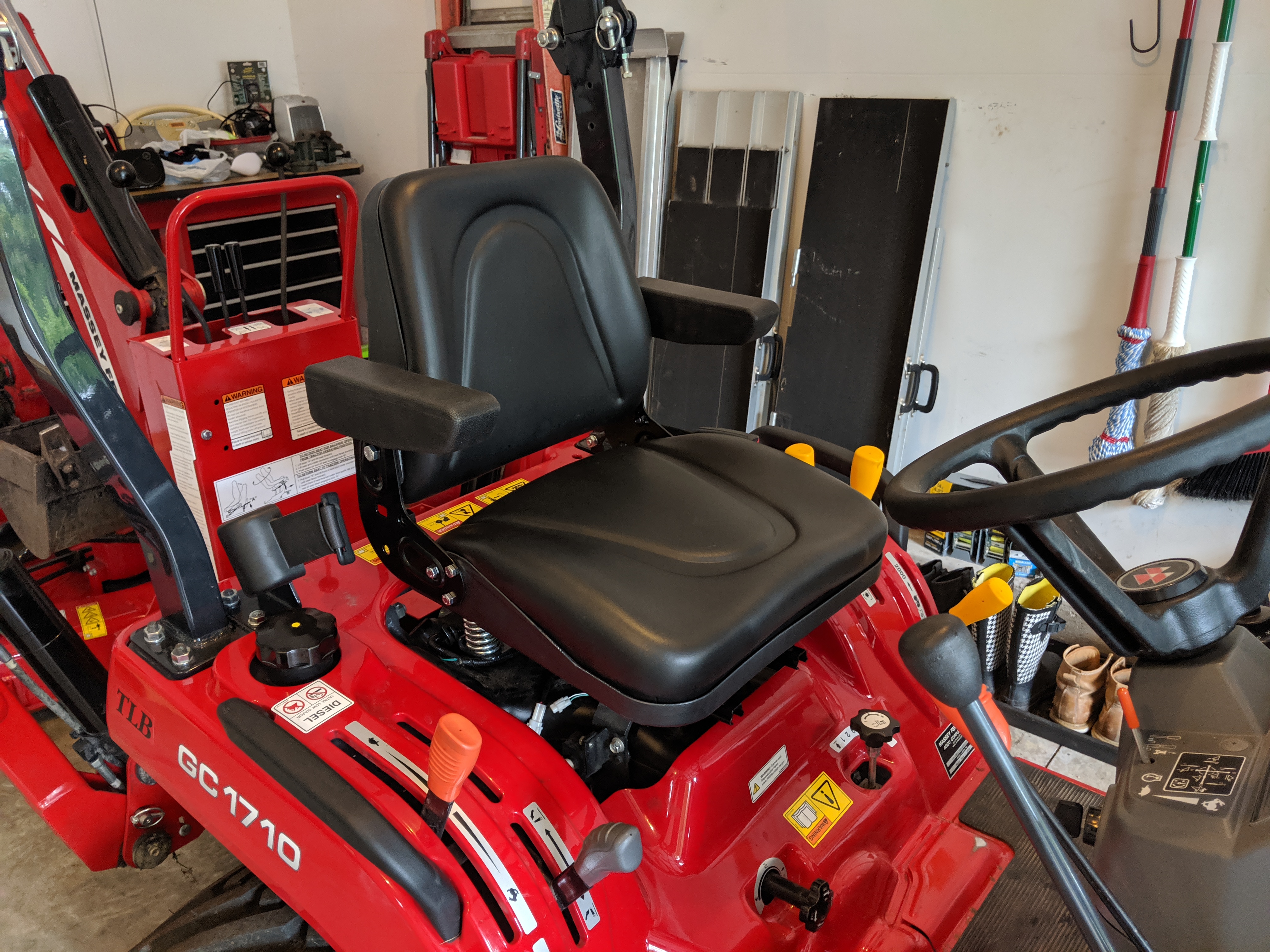

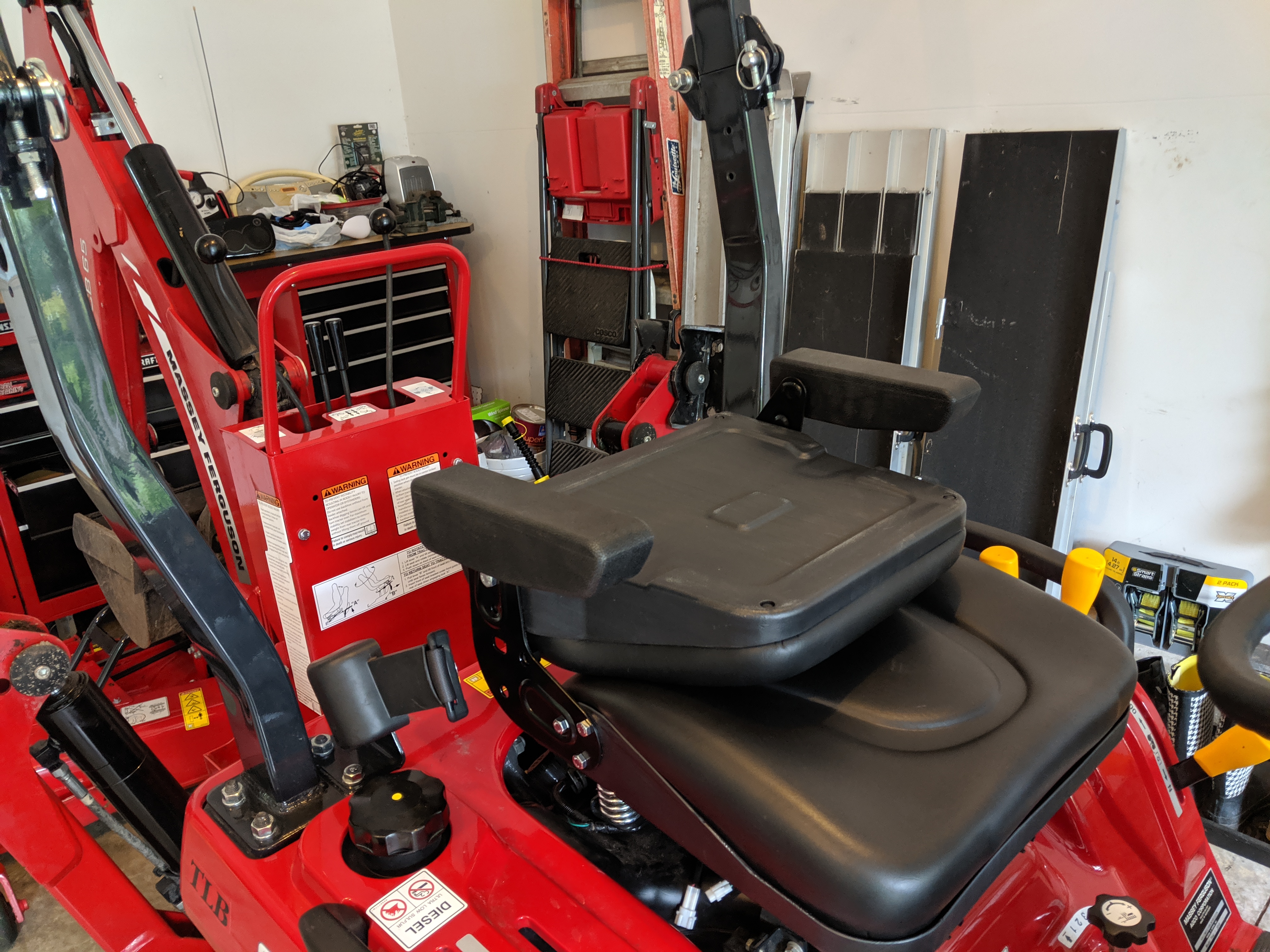

I did a few things. I swapped the swiveling seat for a fold-down seatback one. Now, I flip the back down and sit on it when working with the hoe.

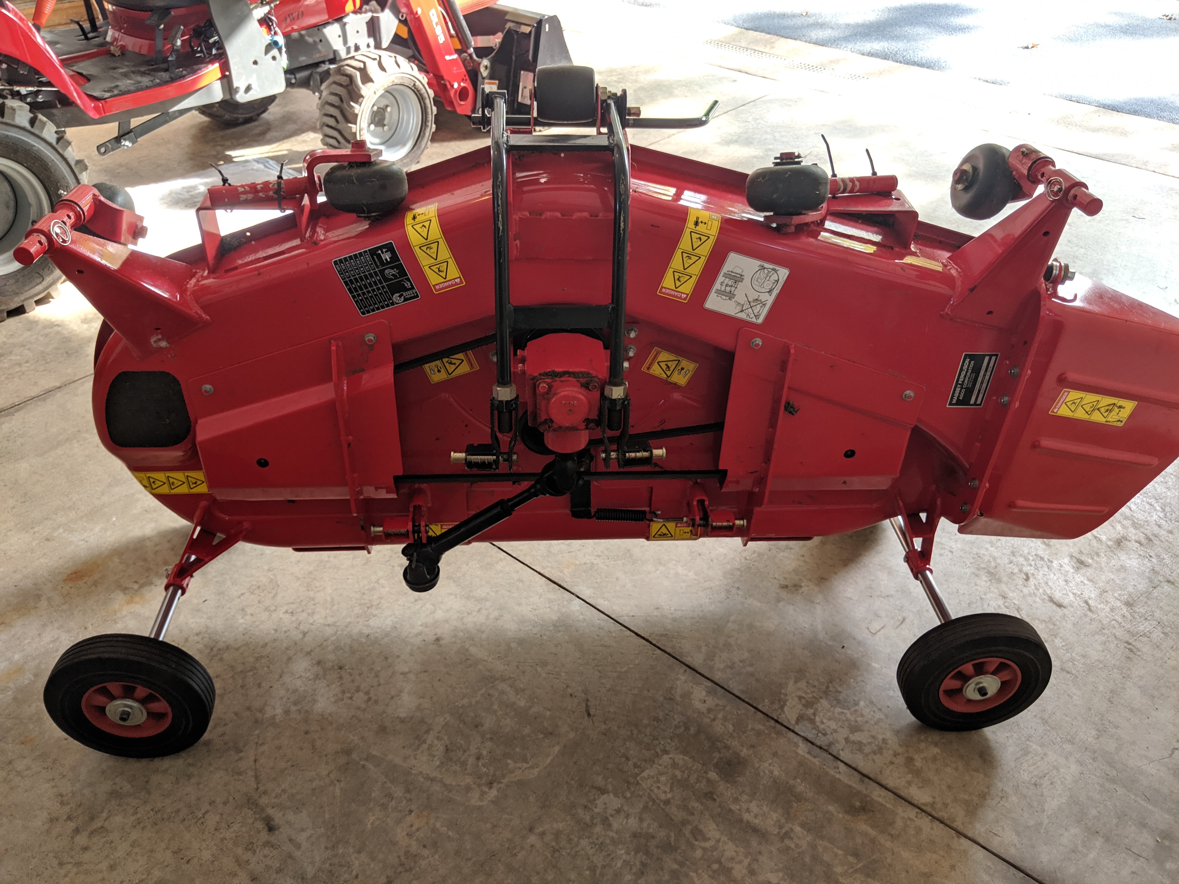

I build a mower deck dolly.

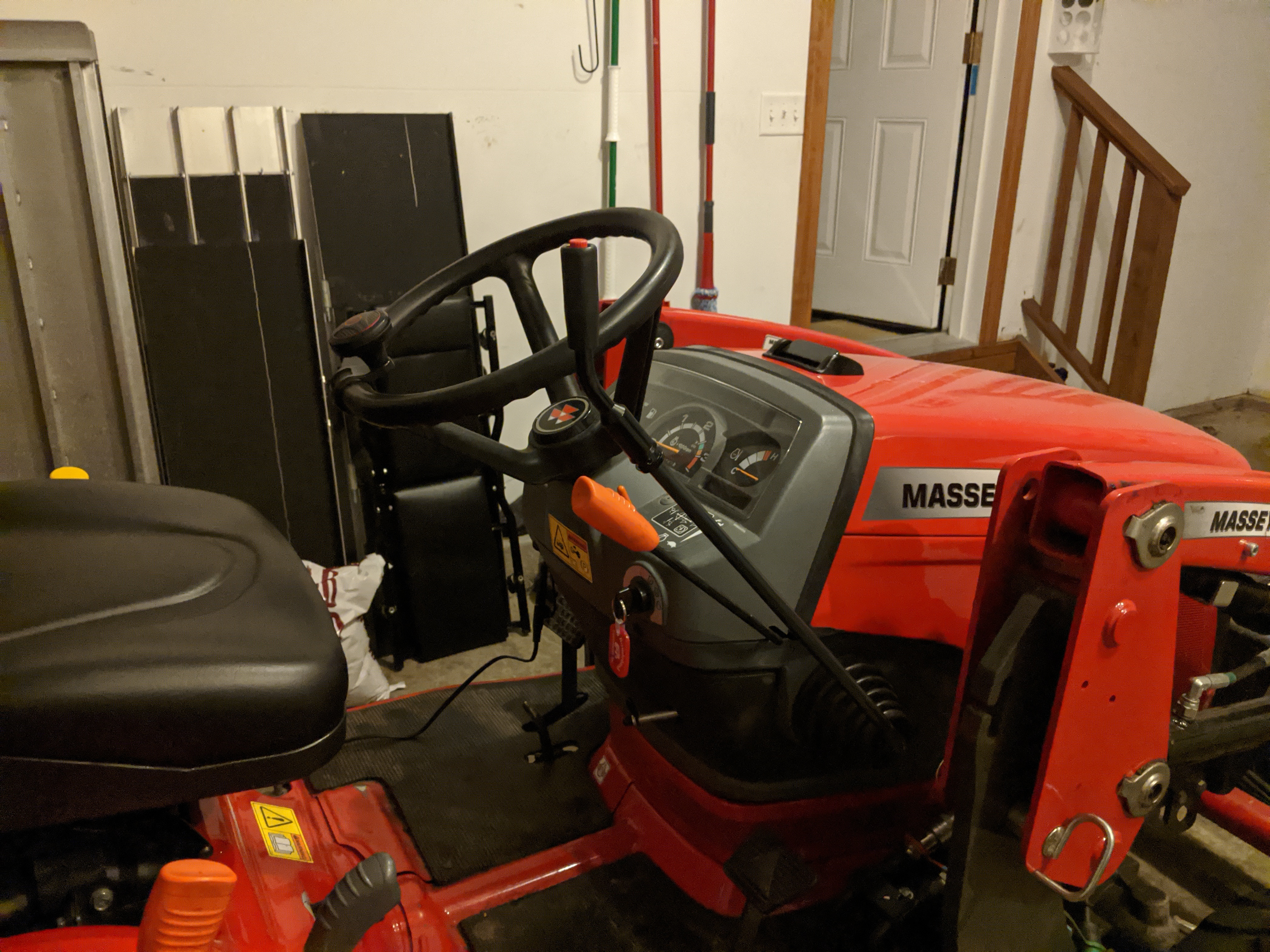

I built a loader joystick extension to bring it closer to me.

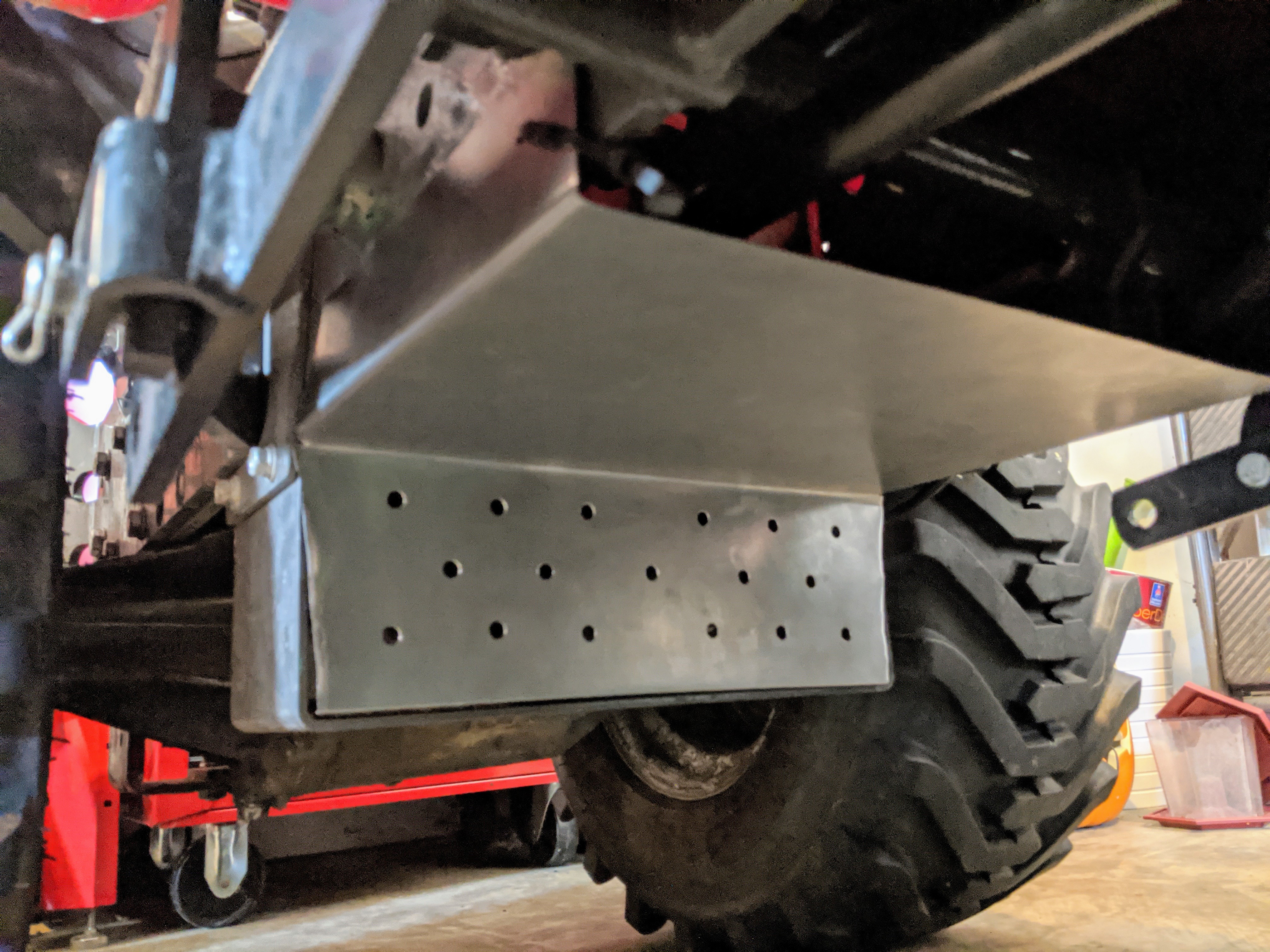

And I build a skid plate.

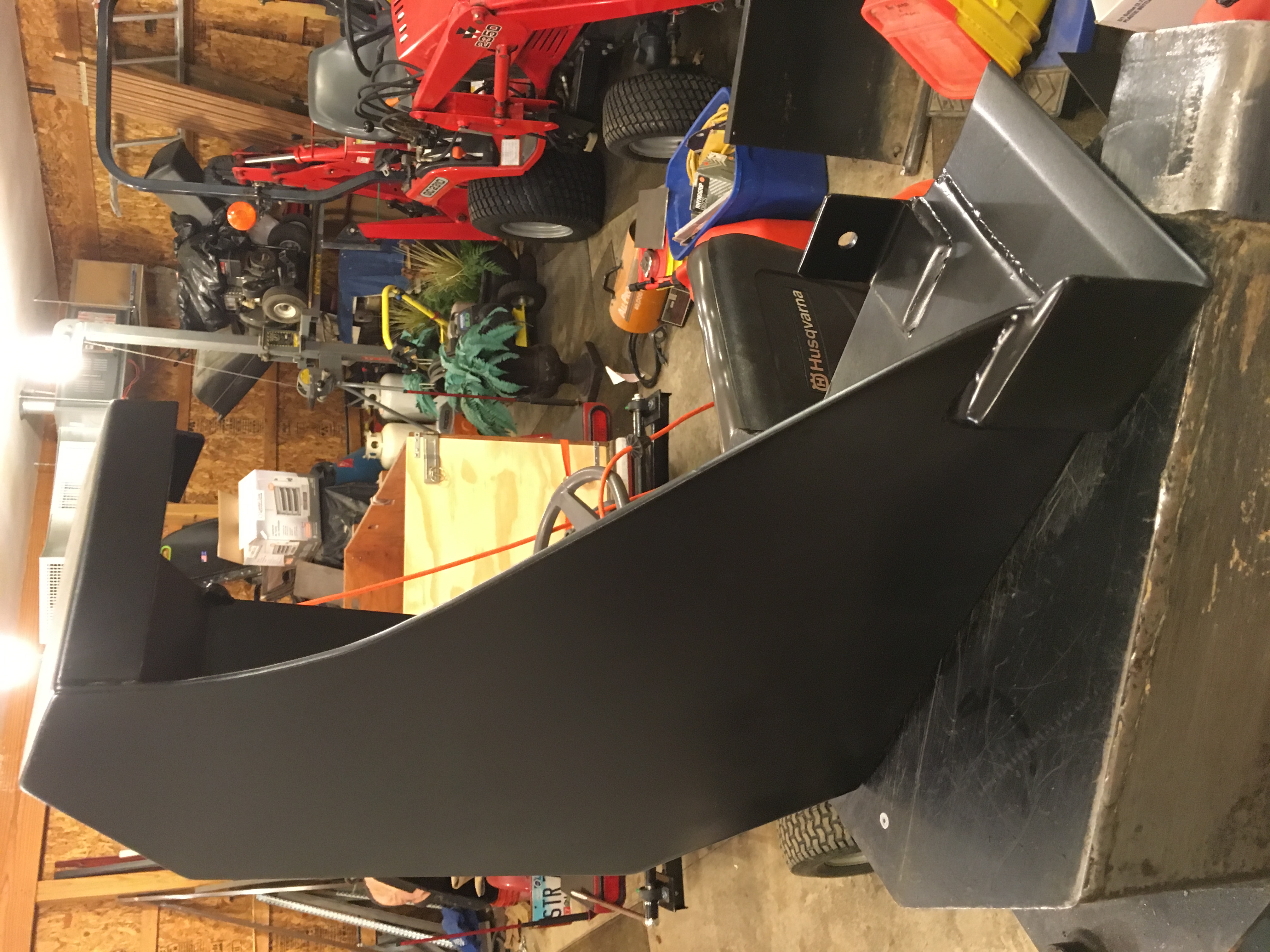

My latest upgrade:
Last year, I decided I was tired of trying to shovel mulch from a 48" wide trailer, in to a 47" wide bucket. And, since I just finished making a "load handler" style roll up mat to unload my trailer shovel free, it was time to address the bucket size problem.
Rather than make some sort of funnel to add to the top of the bucket, I decided I would rather just make a bolt on bucket extension.
So here is my 7" front bucket extension:
I can now crank the mulch right into the oversize bucket, smiling the whole time.
   / GC Series Owner Upgrades And Modifications #86
So that bolts on the outside of the side of the bucket, then?
Is that seat more comfortable then the OEM seat? After the first year, I have not turned the seat around to operate the backhoe, I just stand next to the backhoe, real close.
What's the red button on your joystick extension, an ejection button, ha.

Yes, we the pioneer 2300 series owners had to take some arrows, so the current model owners could enjoy their "upgraded" 2.0 and 3.0 versions of the GC series.
My latest upgrade:
Now that's a real clever attachment, thinking outside the box, I mean thinking outside the bucket.
KC
Oh that fires the cannon, I got it mounted ssqa when the bucket is off. :D Naw, it's just a plug for the hole at the top of the handle.
Yeh, this seat rocks. Without the spin mechanism, there's no wobble when driving around. Also I sit a little bit lower now. And it works great for the backhoe.

Could you provide the brand/model #, I'm tired of the wobble.
