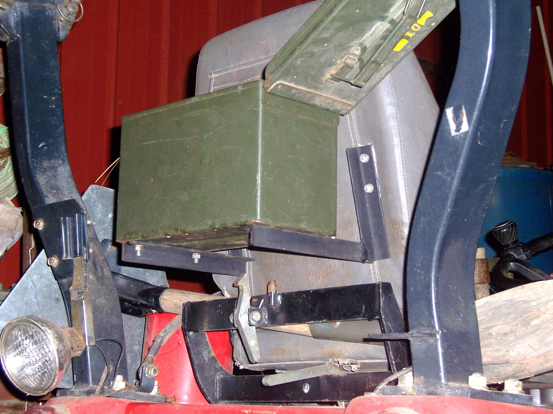

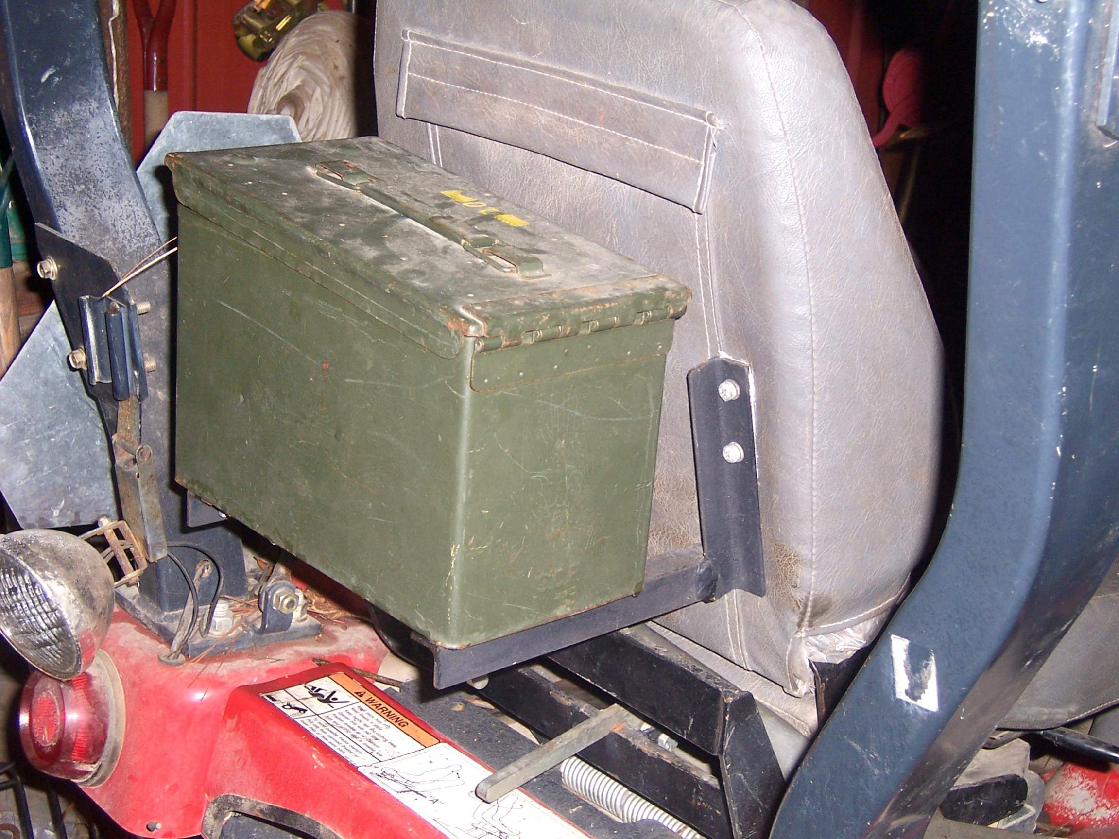

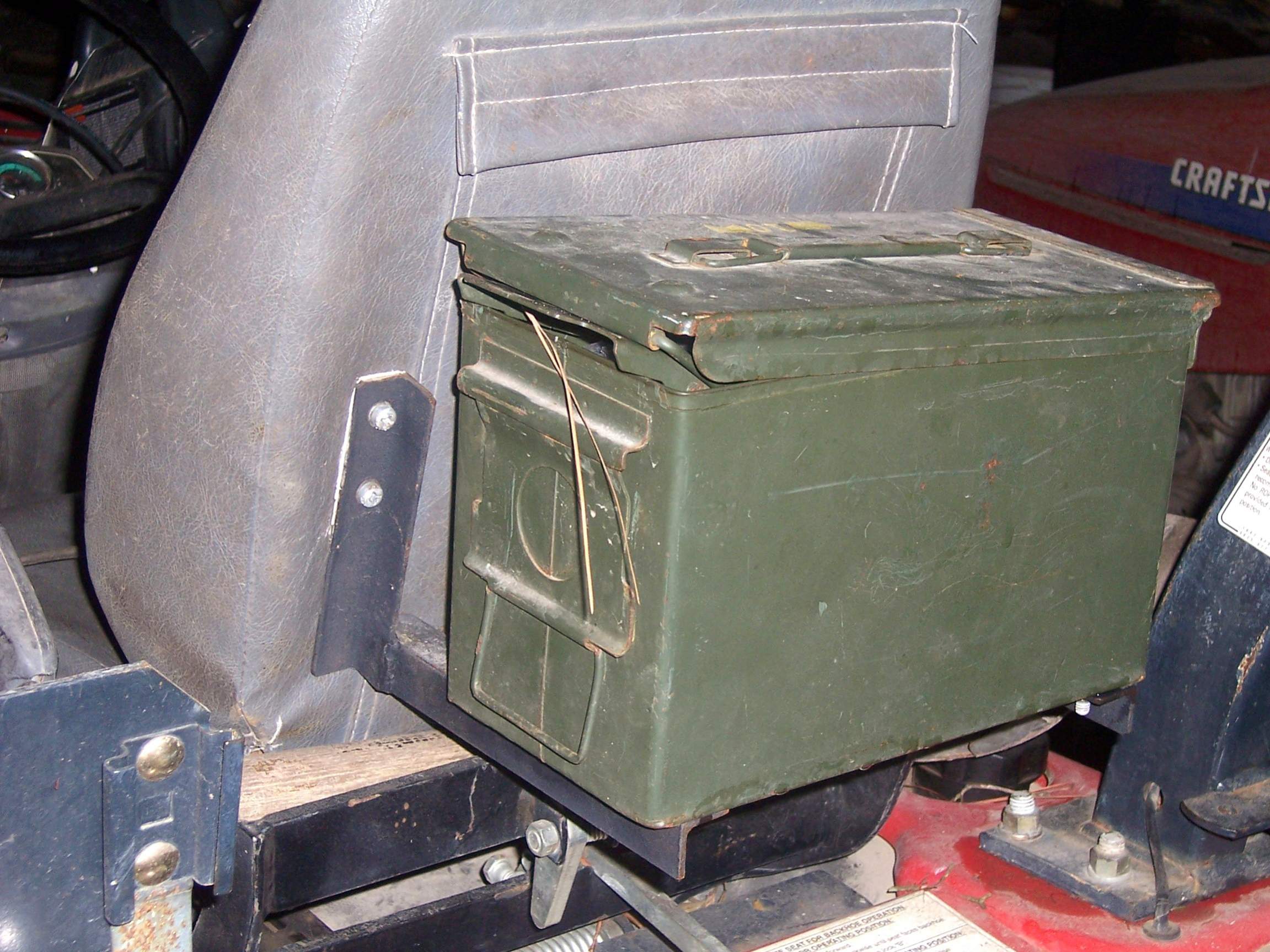

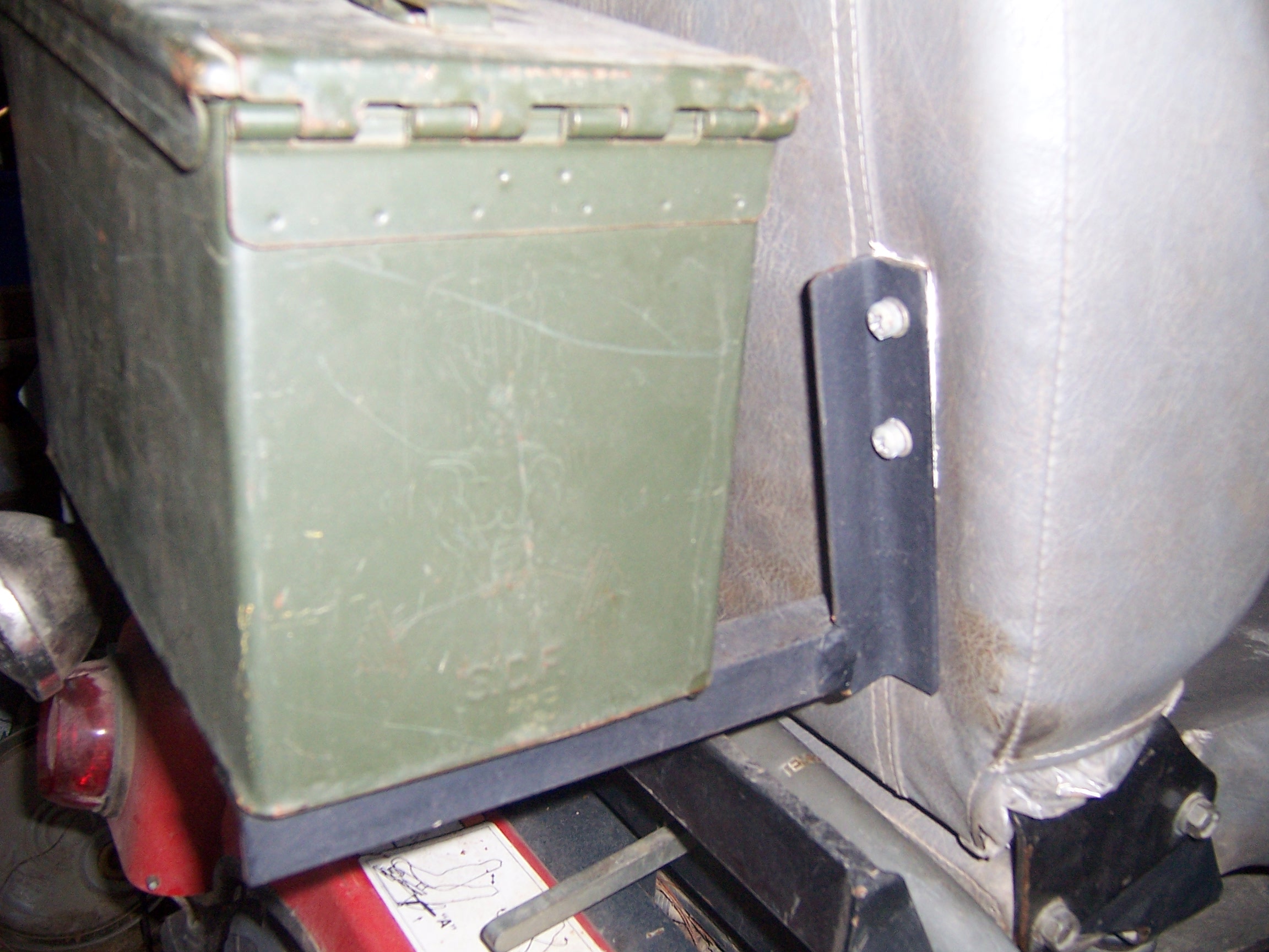

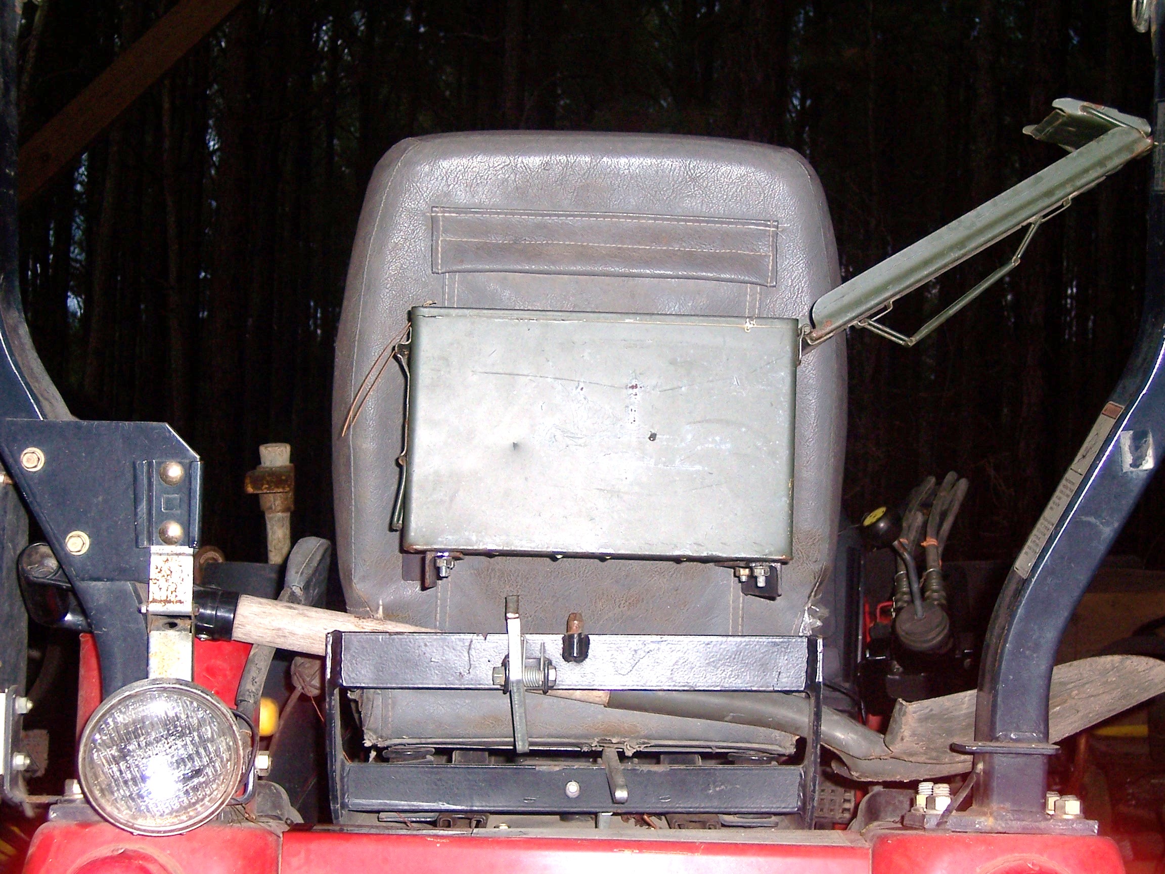

This is my solution to having a tool box on my little GC 2310.If you peel of the seat cover off there is a bracket with threaded holes in it(sorry no pics). I simply bolted some 1 X 1 angle to those holes and welded two more pieces on as level as I could eyeball. I then bolted a 30 cal. ammo can on and there you go.The seat rotates for the BH with no trouble at all. 100_5020.jpg100_5021.jpg100_5022.JPG100_5026.JPG100_5027.JPG100_5028.JPG

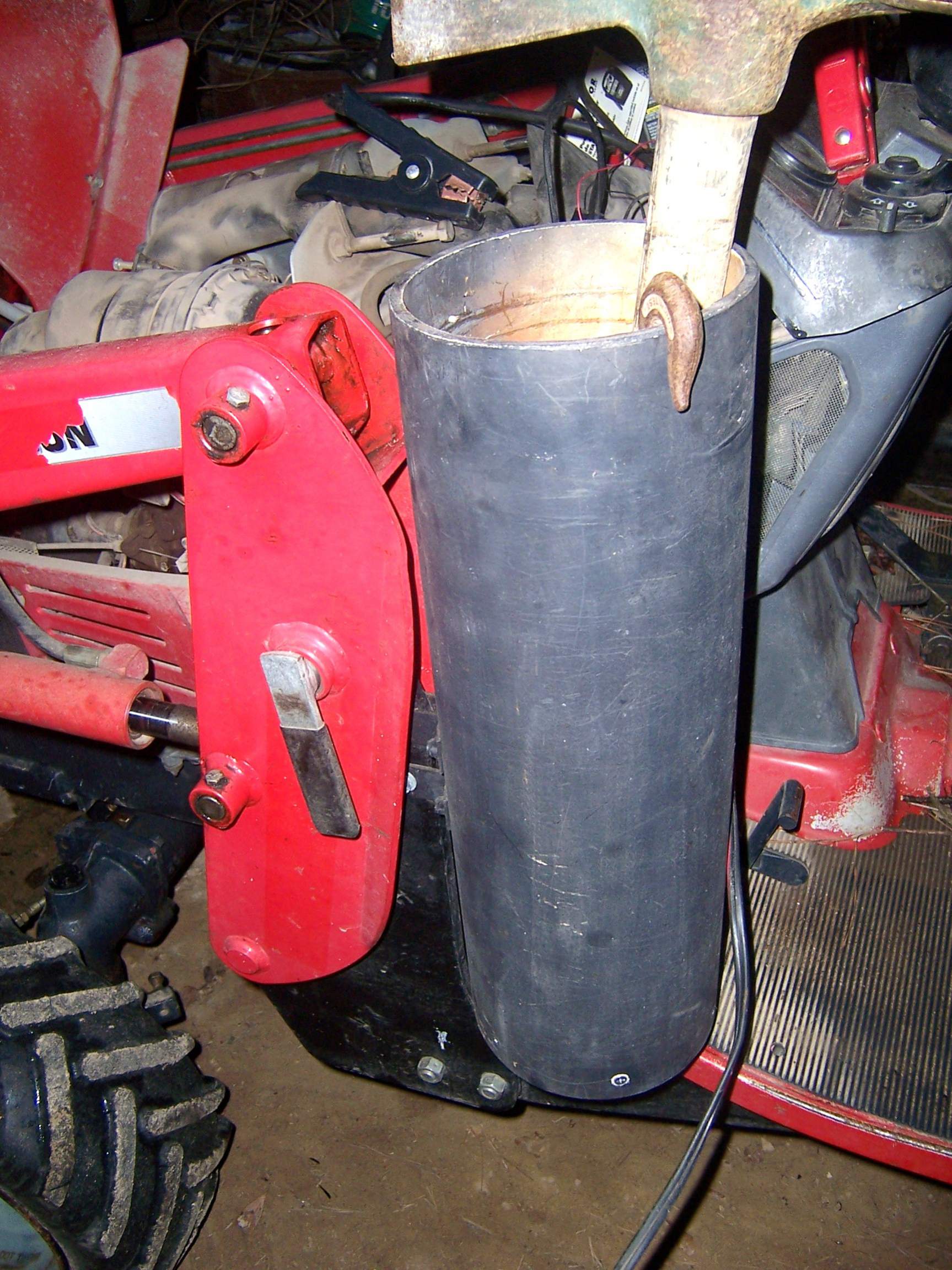

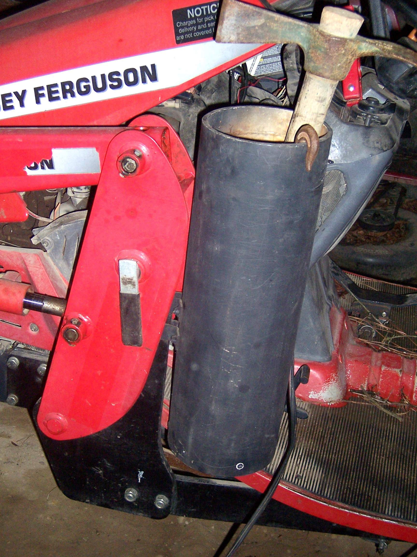

I also added a piece of 6" pvc,attached by a homemade bracket using existing holes.It can hold way more chain than I need. It also holds small tools.It's not as nice as most of the modifications posted here,but they serve my needs. 100_5023.jpg100_5025.jpg

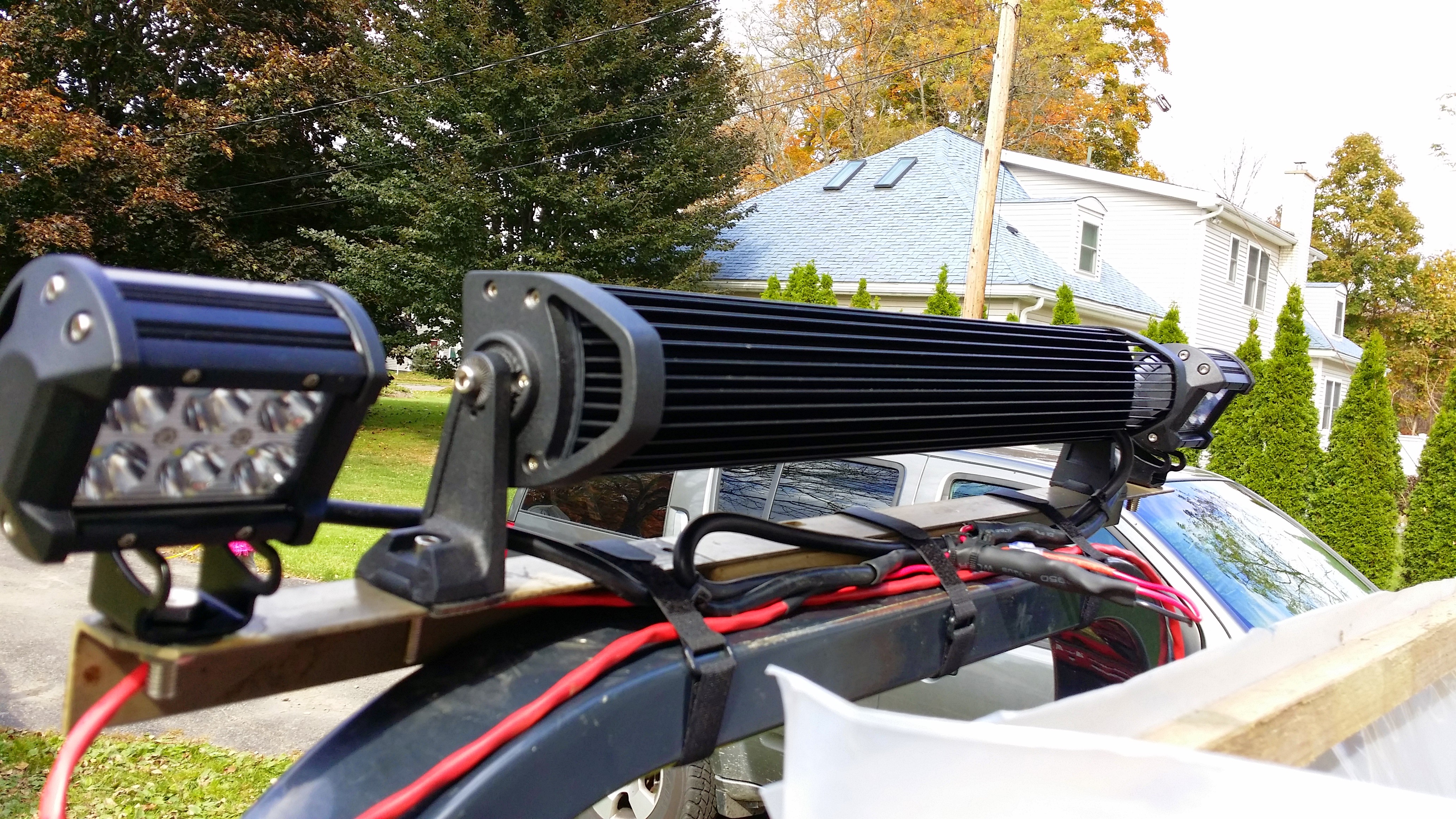

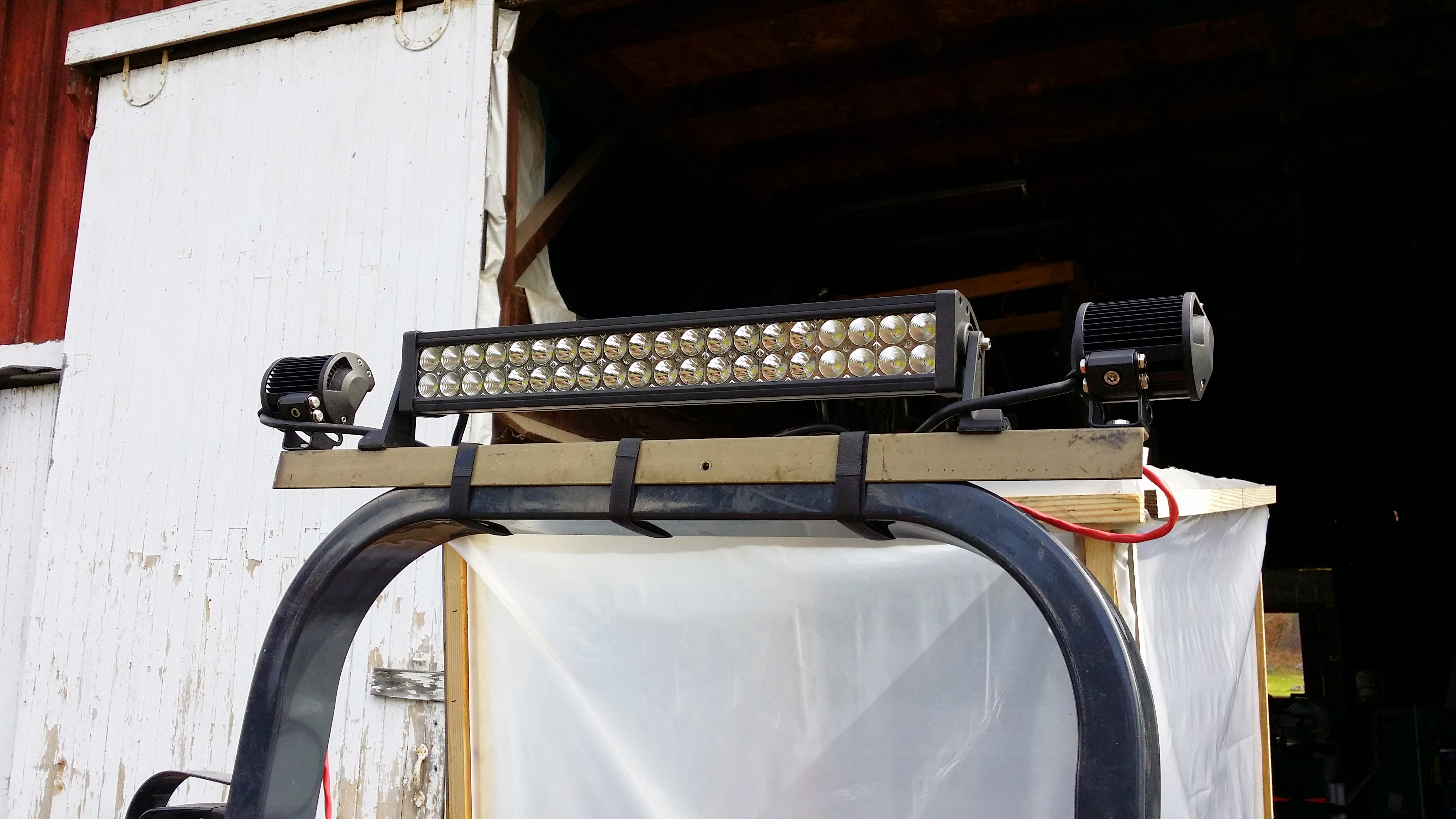

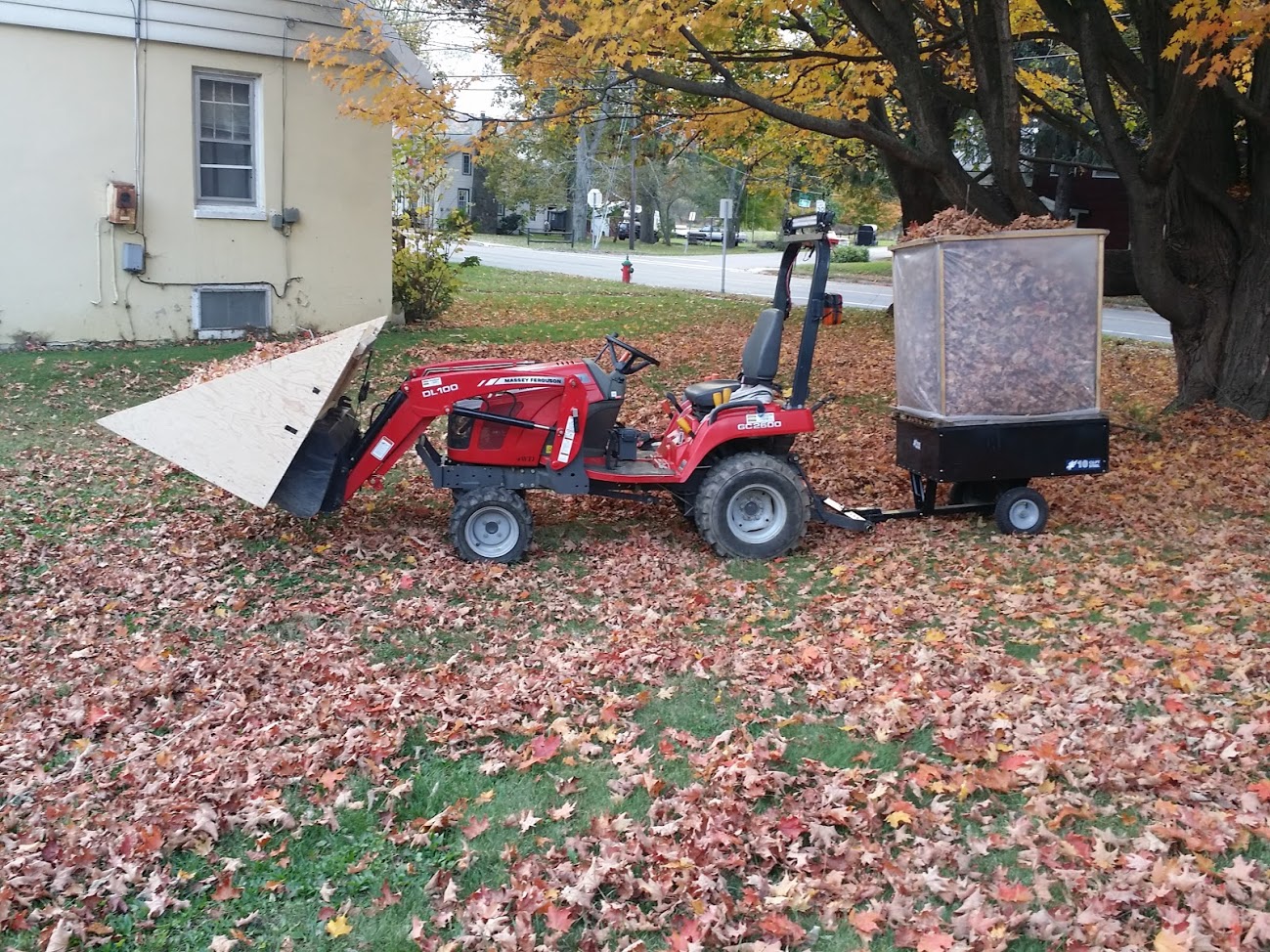

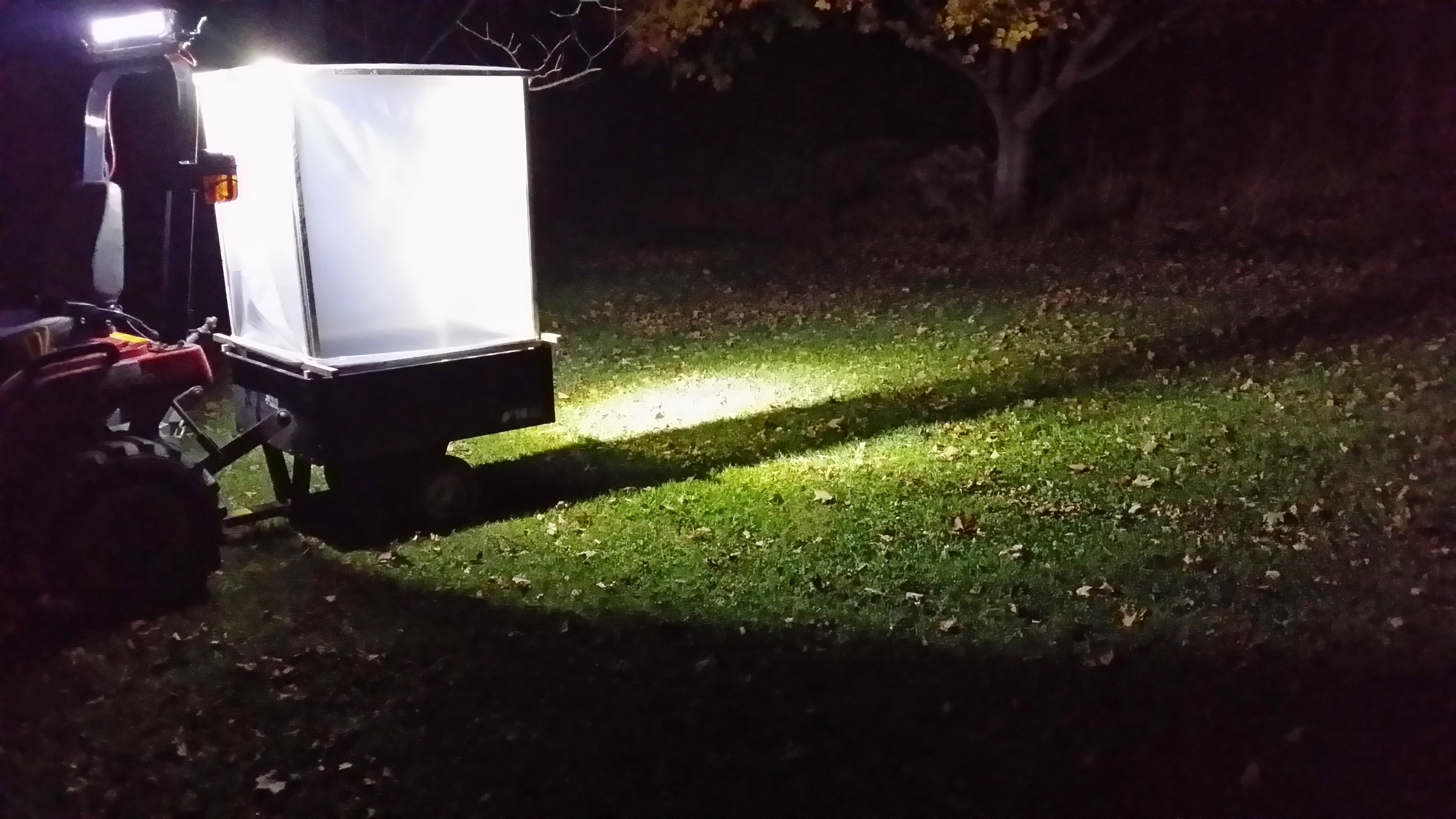

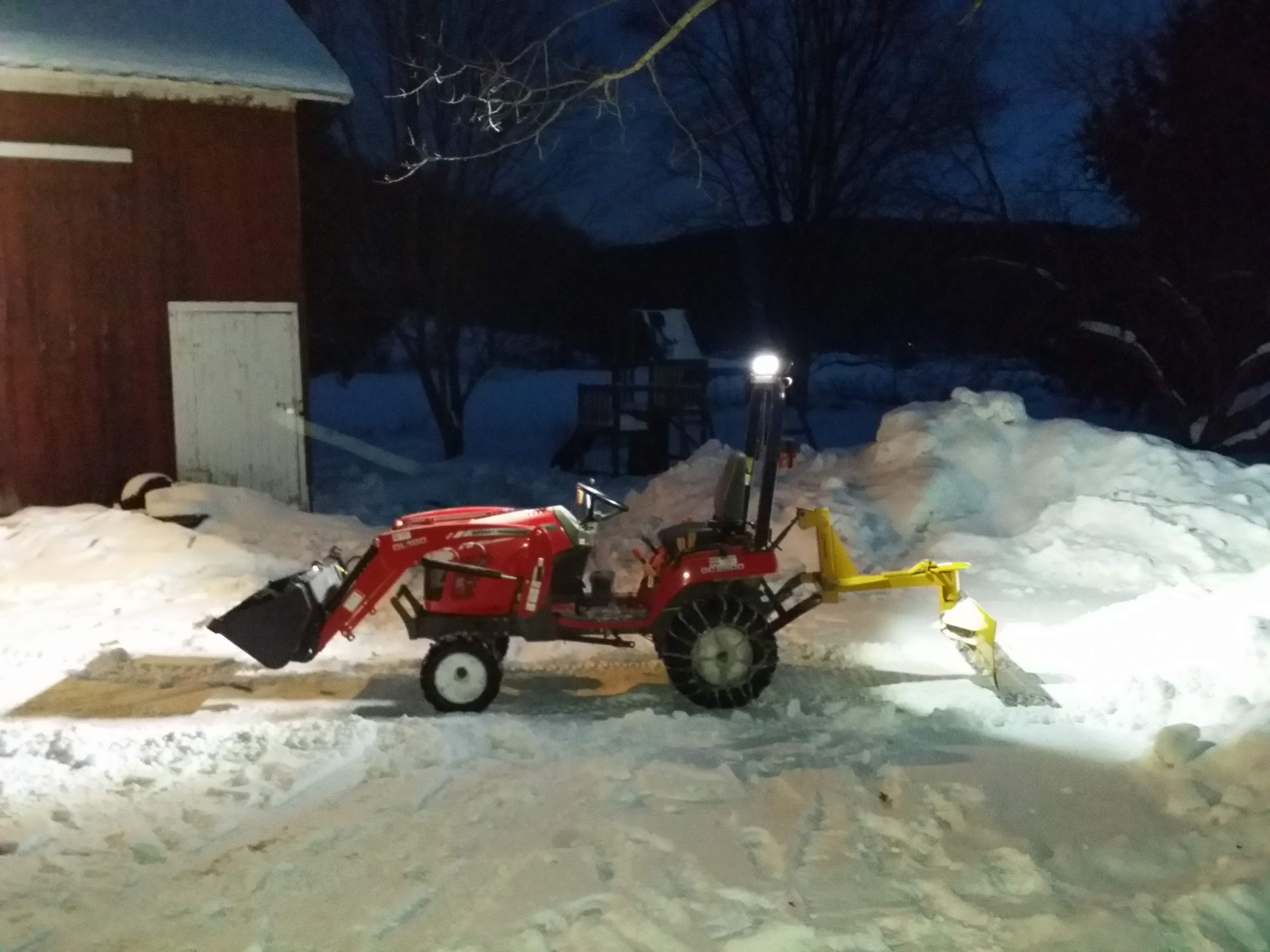

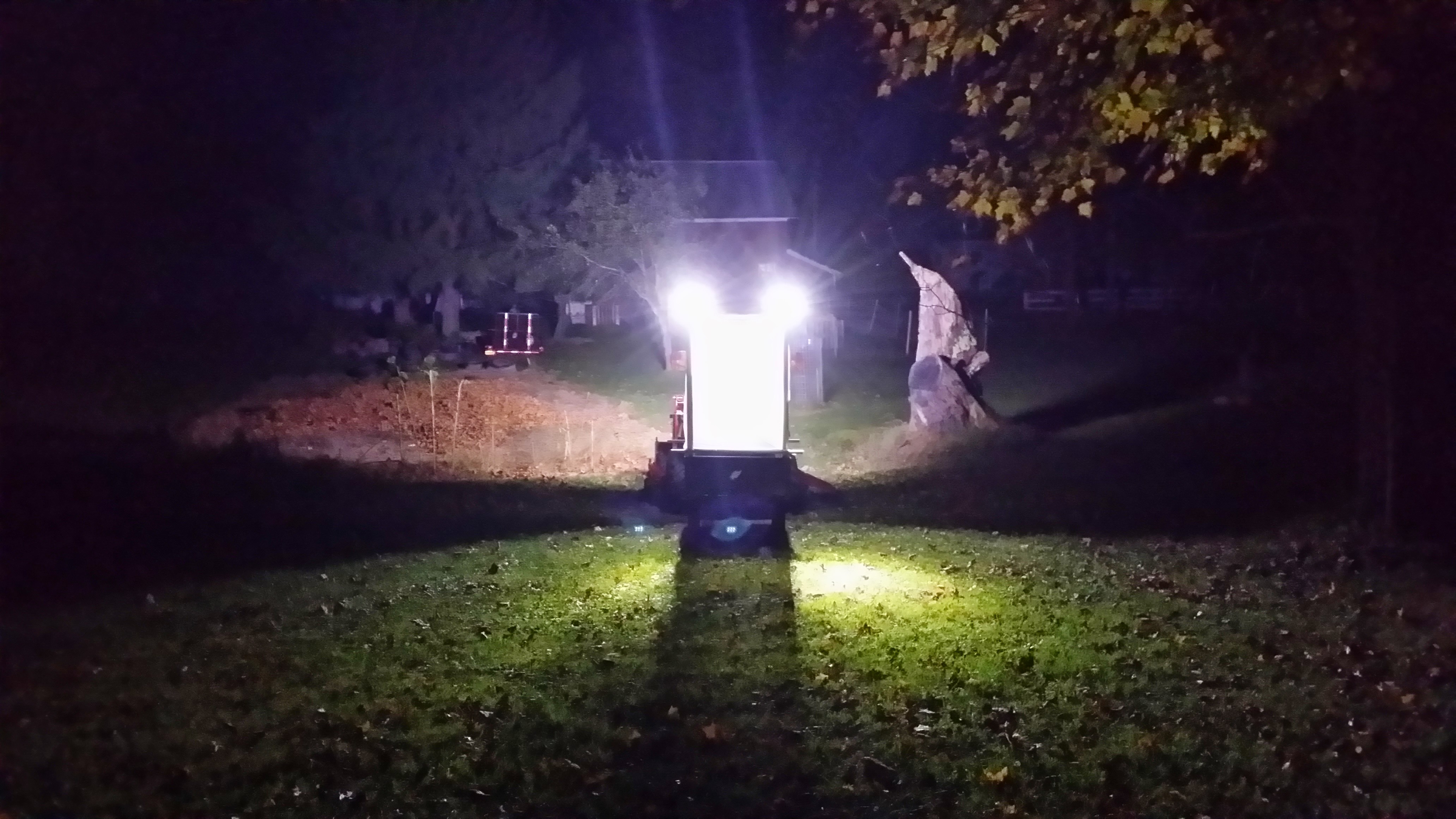

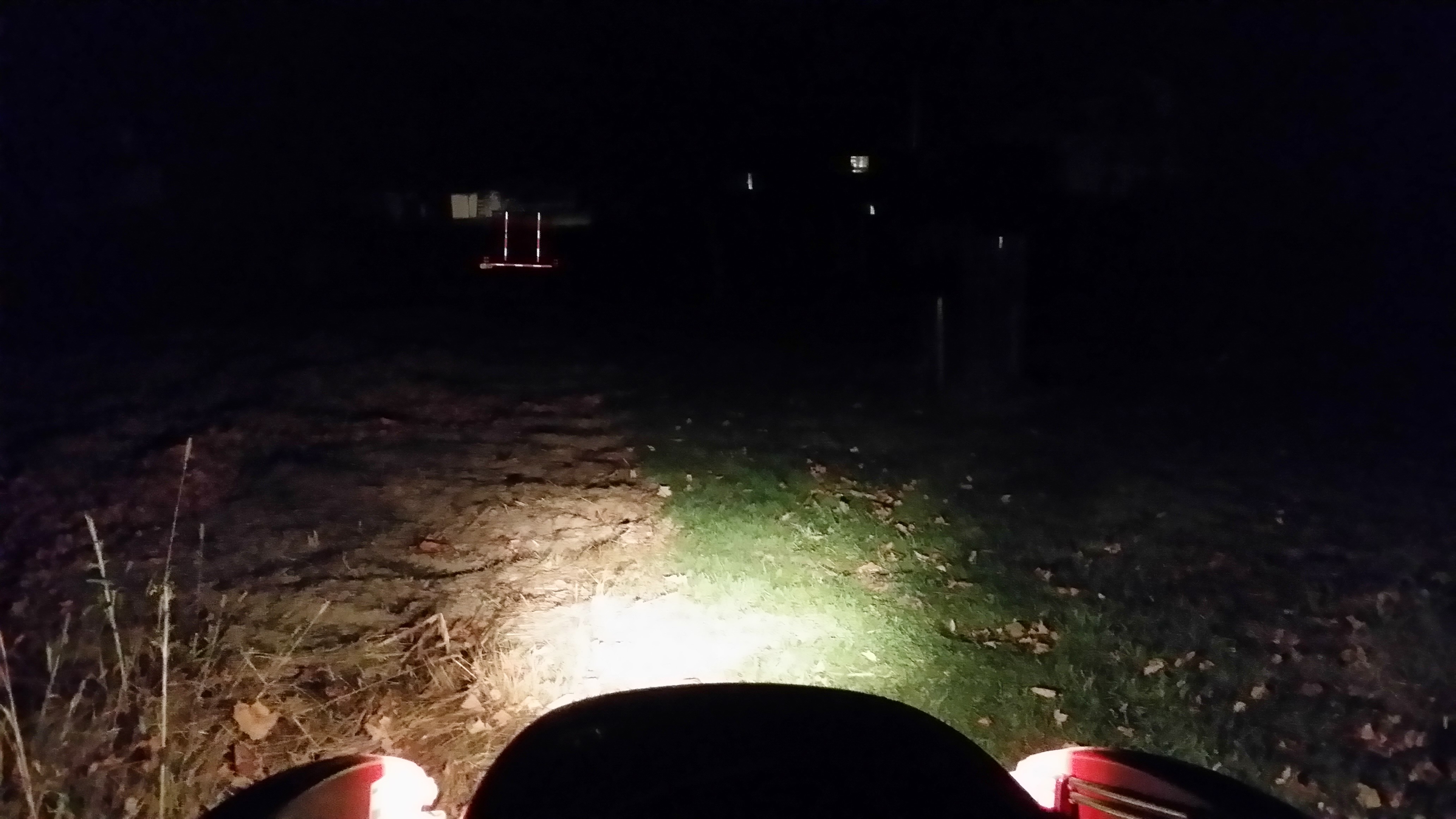

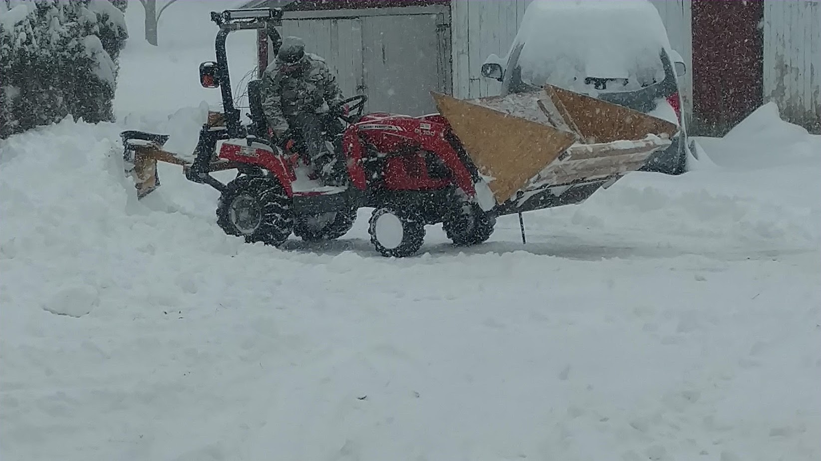

I added a few things to my 2600.
-3 chain hooks to the bucket
-forward facing 20" LED bar with 2 rear facing 4" LED pod lights on the ROPS
-forks made from 4x4 posts
-quick hitch from Harbor Freight
-rear tires loaded with 10 gal of washer fluid, about 80 lbs each (local rimguard dealer wanted $250 for all 4 after taking the tires to them, washer fluid was $40)
-wooden bucket expander for light materials, soon to be replaced with a custom bucket (5ft wide, 33" deep, 25" high with an expanded metal top) for snow, compost, barn clean out, leaf gathering
-upping hydraulic pressure to 2100 or 2200 PSI thanks to this thread: http://www.tractorbynet.com/forums/.../350009-how-adjust-pressure-relief-valve.html
