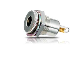

Another useful upgrade, was a 12 volt power jack, to allow me to plug in a float charger without opening the hood. My GC has the original brush guard, which must be lowered separately, before you open the hood, so it's not very convenient.
I used a Radio Shack panel mount jack like in the photo below, and mounted it low on the part below the dash that curves downward. This is to keep water out of it. It is simply connected directly to the battery. Then, I just added the compatible plug to my float charger.
Anyone who does this add, please be sure to add a low amperage in line fuse to the positive side. I think I used a 2 amp.

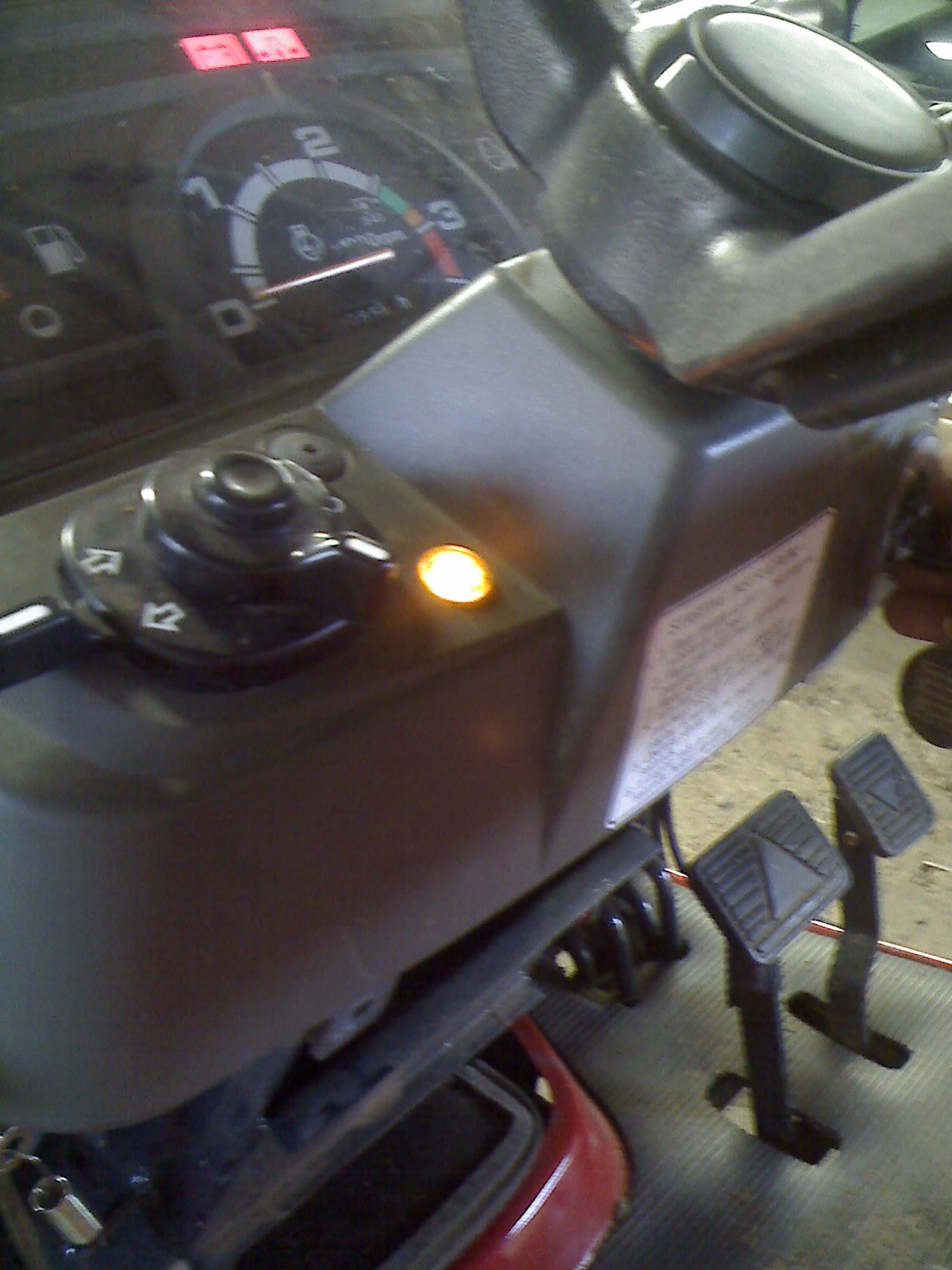

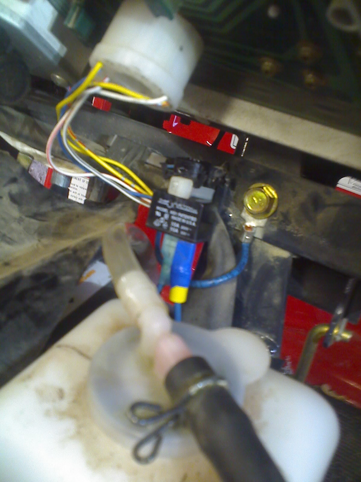

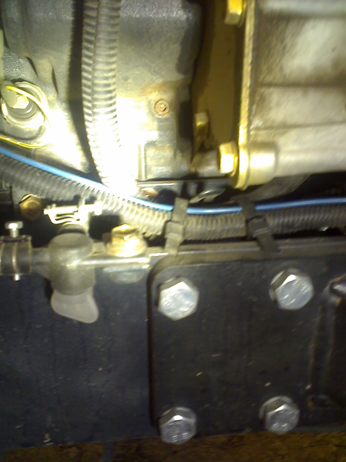

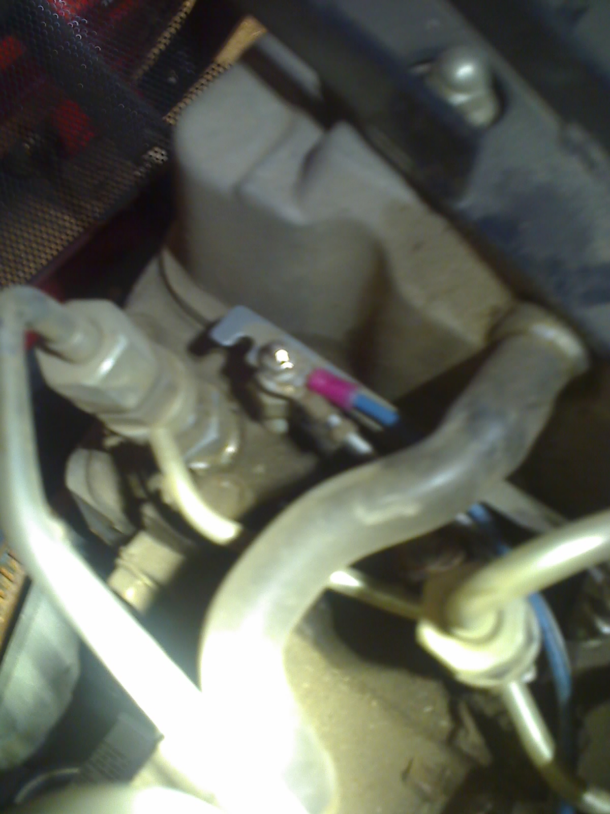

Finally got around to installing an indicator light for the glow plugs:cool: Connected the blue wire to the bus bar for the glow plugs, followed the existing wiring back to the dash, install a curcuit protector and installed the light that comes on when the glow plugs are actuated.:thumbsup:
