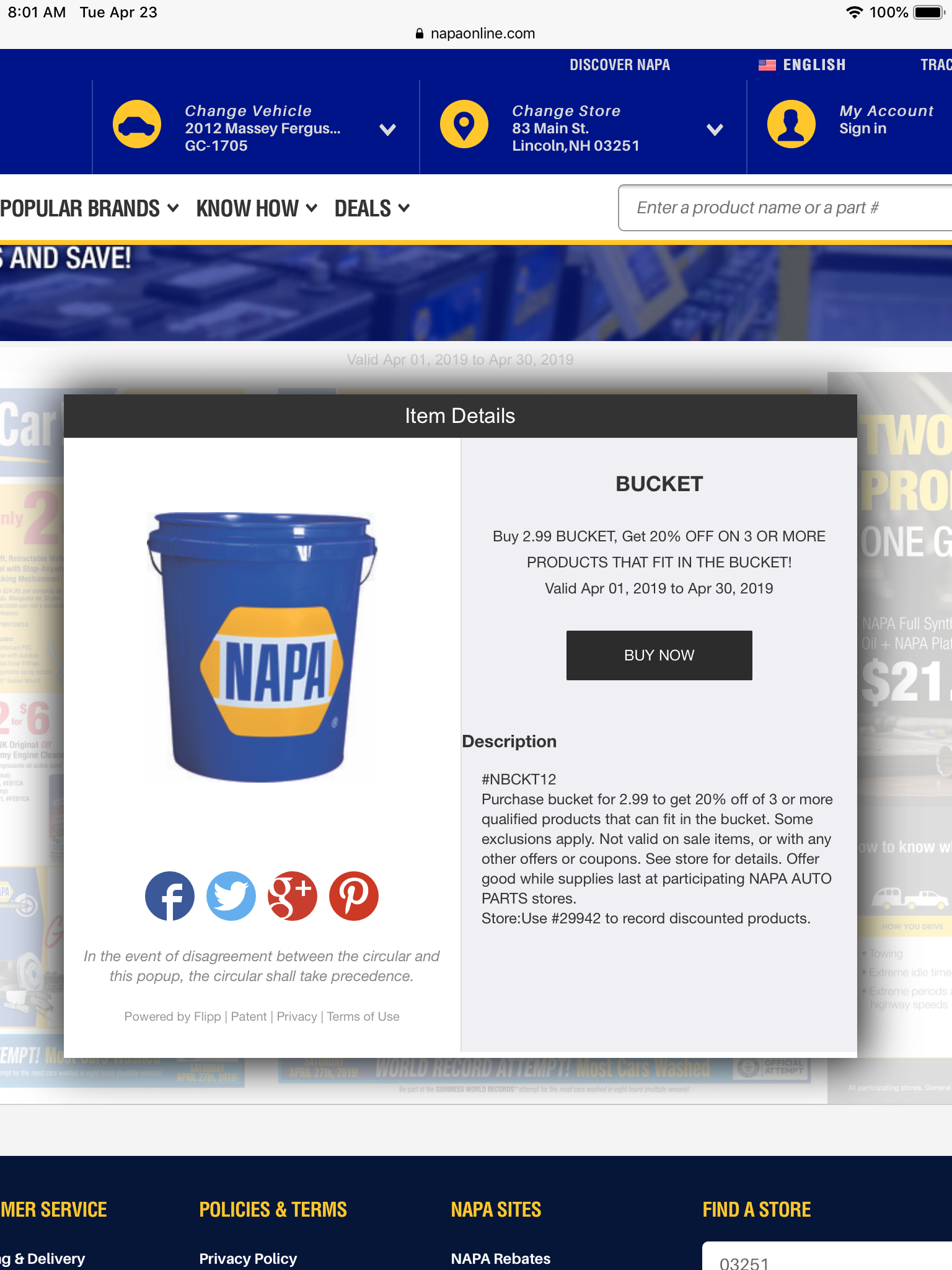

Hi Pixguy,
Yes, I am going to stock up on filters when they go on sale at 50% off, sorry I did not make myself clear on that.
KC
Wasn’t the date the filters going on sale starting the 22nd? I’m not seeing the 50% sale, just the 20% after buying the bucket.
   / GC Series Filters, OEM And Aftermarket Part Numbers #67
Wasn稚 the date the filters going on sale starting the 22nd? I知 not seeing the 50% sale, just the 20% after buying the bucket.
I have relooked at the card (postcard size) from my local Napa Store that says the filter sale is from today, 4/22, until 4/27, and I don't know anything about buying a bucket.
It says "NAPA Filters Farm And Fleet Sale" and "All NAPAGOLD Filters On Sale!"
This is a locally owned Napa Store, and the salesman at the counter told me that the filters for my tractor would be at least 50% off, so I thought all the Napa Stores are having this sale on the same date?
I am very sorry if these dates are only for my Napa Store, I am going tomorrow to purchase my filters and I can ask about the sale for other Napa Stores.
KC

Purchased my MF GC2410 Napa Gold air filters, #9691 (40% off = $24.98), and my MFGC2410 Napa Gold fuel filter, #3262 (60% off = $7.13) yesterday.
The fuel filter is $8.87 at Jack's so I don't know about Napa's 60% off sale price?
The hydraulic filter for my GC2410 is still listed (Napa Gold #400361) with no price and Napa says it is still being developed to sell in the future.
I asked the owner if other Napa Store filter sales are the same dates and she told me it's up to each store to set the dates in the month of April.
F.Y.I. I purchased my MF GC2410 oil filters from Amsoil, Wix #551360, when I purchased more fluids, but Napa says they are the same as their #1360.
KC
