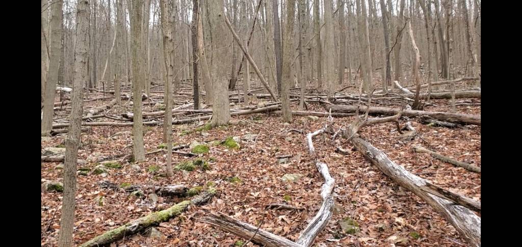

I see on here where a lot of folks utilize their tractors to retrieve firewood with a lot of creativity, and very successfully. I figured this may be a great source of information since I know very little on this subject. Here's the deal...
My father has about 26 acres of wooded mountain ground that we use for hunting and general recreation type stuff. It will be mine someday, hopefully not for many more years, of course. But naturally I treat it as my own, just the same. I also have access to another lot roughly the same size,, owned by my aunt. This was all part of my grandparents family farm at one point. There is always fallen trees all throughout the properties. I have spent the past 20 years clearing whatever falls across truck and atv trails and the like and typically bring some wood home for the fire pit for picnics, parties, and whatever. The rest we let lie where it falls. Since I have had my tractor this chore is much easier, of course, and I'm considering getting into using this firewood to help heat my home also.
We have an oil furnace and will continue to use it for the main level of the house as needed. I am only interested in a wood stove for the basement as a secondary heat source. I have no desire to cut down healthy, live trees. But we have a lot of fallen timber just laying there cluttering up the woods and going to waste. Utilizing it would kill two birds...cleaning up our woods and providing a heat source.
I'm not new to cutting up the logs but I am new to using firewood for a home so I would have a lot to learn and it would be an investment to get started. Of course I need to buy a wood stove and get it properly and safely installed. I also considered a grapple for my tractor to help move logs. Mahindra Max 26xl. This property is about 3-4 miles from my house, but I have a trailer to transport the tractor, or could drive it, and I have a dump trailer to haul wood home with. I actually enjoy the work involved with firewood, but then again, it is completely recreational at this point, lol.
So I need a wood stove, a grapple, a splitter, and an education on firewood. So from you more experienced folks does this sound like something worth getting started with or not worth the money, time, and energy involved?

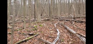

I would love to clean up areas that look like this and keep them cleaned up, and utilize the wood.

If the wood is rotted it's not good for fire wood.. Maybe make small burn piles..

Also think about the wood you want to harvest. Any wood that has started to rot has very little heat value in it compared to good solid wood. You might be farther ahead by salvaging used pallets for firewood.
When hunting we always would look for a standing tree that had been killed by lightning. They were dry and not rotted.
IF wood is rotted best thing you can do is move it into a pile to either burn (if it will) or rot and clear the ground for access and new growth..... But keep in mind rotted wood breaks down to return new life into soil....
A lot of the wood on the ground in that picture is going to be rotted and not much good. It'd be better for the health of the forest and the remaining trees to just let it finish rotting and feeding the soil. "Cleaning up the woods" is actually unhealthy for the forest, unless you live in fire country. Any logs that aren't rotting can certainly be used for firewood, although it looks as if you have a lot of elm, which sucks to split.

It would appear you have enough down wood even if only 30% is not rotted to yield enough decent wood for years, then maybe select cut those live trees that are crooked or not a timber quality to thin out the forest leaving the good trees.
Do you have a BH for your Max? That would make cutting and loading into your dump trailer easy - raise over the bed, cut and let the rounds drop in, or load the log lengths into the dump bed then take home to process.
Do you have an existing / spare chimney flue in the basement? If not - the expense of a insulated flue needs to be factored. Is it a walk out basement, do you have storage near the basement and as others have stated - think about how you will get wood in there - maybe thru bulkhead?
I would also do as DL Meisen says - get a used equipment, a wood stove - $3-500 range, and a used splitter and go for it. But if you need to put in a flue, and make a place to store wood its a lot of $ investment upfront, with not a great ROI, but enjoyment of being active and outside, as Moss Road points out.

1. Interest in cleaning up downed wood. Some of it may be usable to burn, some may be too far rotted to fool with, but depending on your objectives, you may still want to selectively remove downed trees from your woods simply to clean them up.
2. Firewood - no greater pleasure than a crackling wood fire on a cold winter evening, which is much different than using wood as your primary source of heat for the winter. Many on TBN fall somewhere along that spectrum. I tend toward enjoying fires fairly often, but am not 100% dependant on it for heat in the winter, plus I find it rewarding to work outdoors in the woods and to process firewood.
Unless you have heavy demand, firewood may be collected simply from cutting live trees which may be in the way when clearing trails or when reclaiming land.
Another method is to target dead - yet still standing trees before they fall or get too rotted to use. It's easiest to spot the dead trees in the summer and fall, when leaves are still on the living trees.
It looks like there may be a few leaners in your photo. Those may be dead and potential candidates to start with...(get some tree cutting experience or assistance before tackling the leaners).

Just a guess but any of the logs lying directly on the ground will not make good firewood. We burned wood for the first ten years we were here. We quit because - 1) firewood brought dirt, bark & bugs into the house - 2) my ancient pines were really big and a real chore to work into acceptable firewood - 3) wood pellets became very cheap and avoided all the negatives listed in #1 & #2.

Also, as many have noted, fallen logs are often rotten logs by the time they get around to falling. Dead trees can stand a LONG time before they fall. I have some white pine that died in the late 90's that are still standing....by the time they finally fall, they will be mulch.

Around here (avg 50" of rain a year) if wood is on the ground it does not dry out inside. More than once I have cut into a log that's been on the ground less than a year and had water pour out. Depending on the species it can rot and get bugs pretty quick. Wood here needs at least a year to dry after being split and stacked. Maybe 9 months if that's over summer and it was stacked so air and sun can get to it. Two years is better.
