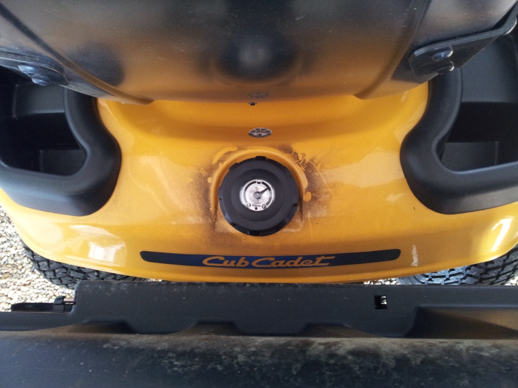

I finally got my fuel gauge. Works great and now that I disabled the seat and reverse switches I can mow much more easily. It registers level from full to empty smoothly as the float moves up and down. I hope the float continues to float per the previous discussion.
