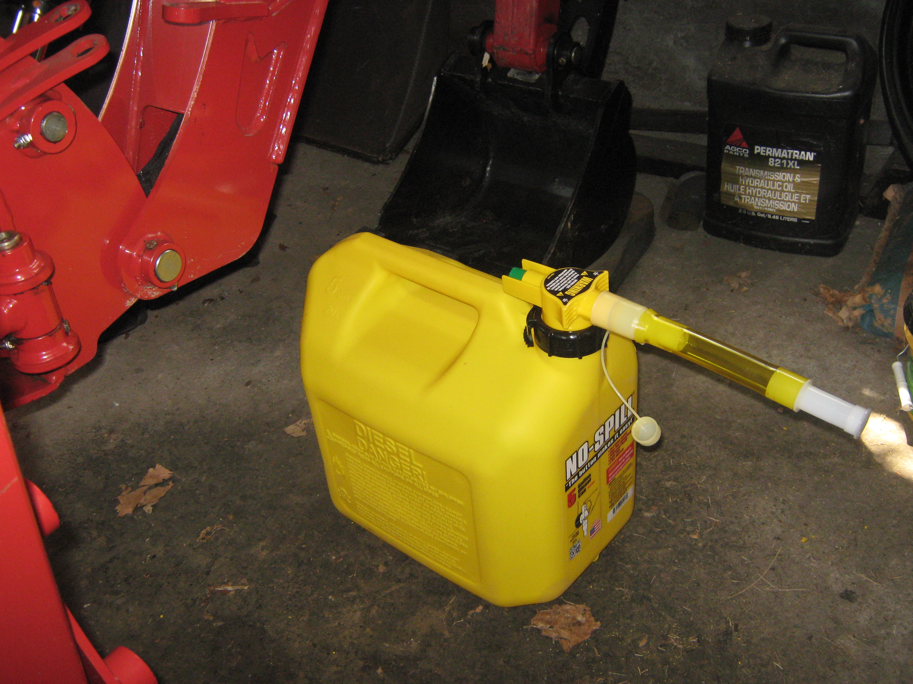

I have a diesel mower (JD 455) and a diesel tractor (JD 4320). This is the best way I have found to fill up the tractor and mower. IMG_1547.JPG
I just drive 1/3 mile down the road and fill up at the gas station lmao, I have a diesel can but that’s for the cattle, not tractors.

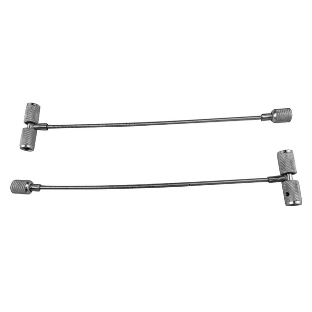

- You drill a hole in the back top of the plastic can.
- You put the tire valve core installation cable into the hole, fish it out of the gas can filler.
Doesn't everyone have one of these tools? :confused3:
- Screw the new valve stem onto the core installation tool and pull it through the filler and out the new hole that you drilled.
- It snaps and seals into place, just as it would on a tire rim.
- You remove the core valve with the slot on the valve cap, no tools needed.
(you all know that the little slots on the top of the cap are a valve stem removal wrench, right?)
- Now you have a screw cap that you can remove for a vent.... until you drop it! :laughing:
Yes, the little plastic yellow snap in cap is much easier and you won't lose the cap. I agree. But this is much more complicated, costs more, and looks much cooler. :thumbsup:

I put one on my 3 gallon sprayer cause I got tired of pumpmping it up. Drill the hole where you want it. I fished some multi strand wire into the hole and out the fill opening. Remove the valve core , thread it on the wire and tie a knot so it can稚 be pulled through the stem. Pull the wire and valve stem out the hole. Little silicone or dish soap helps.
