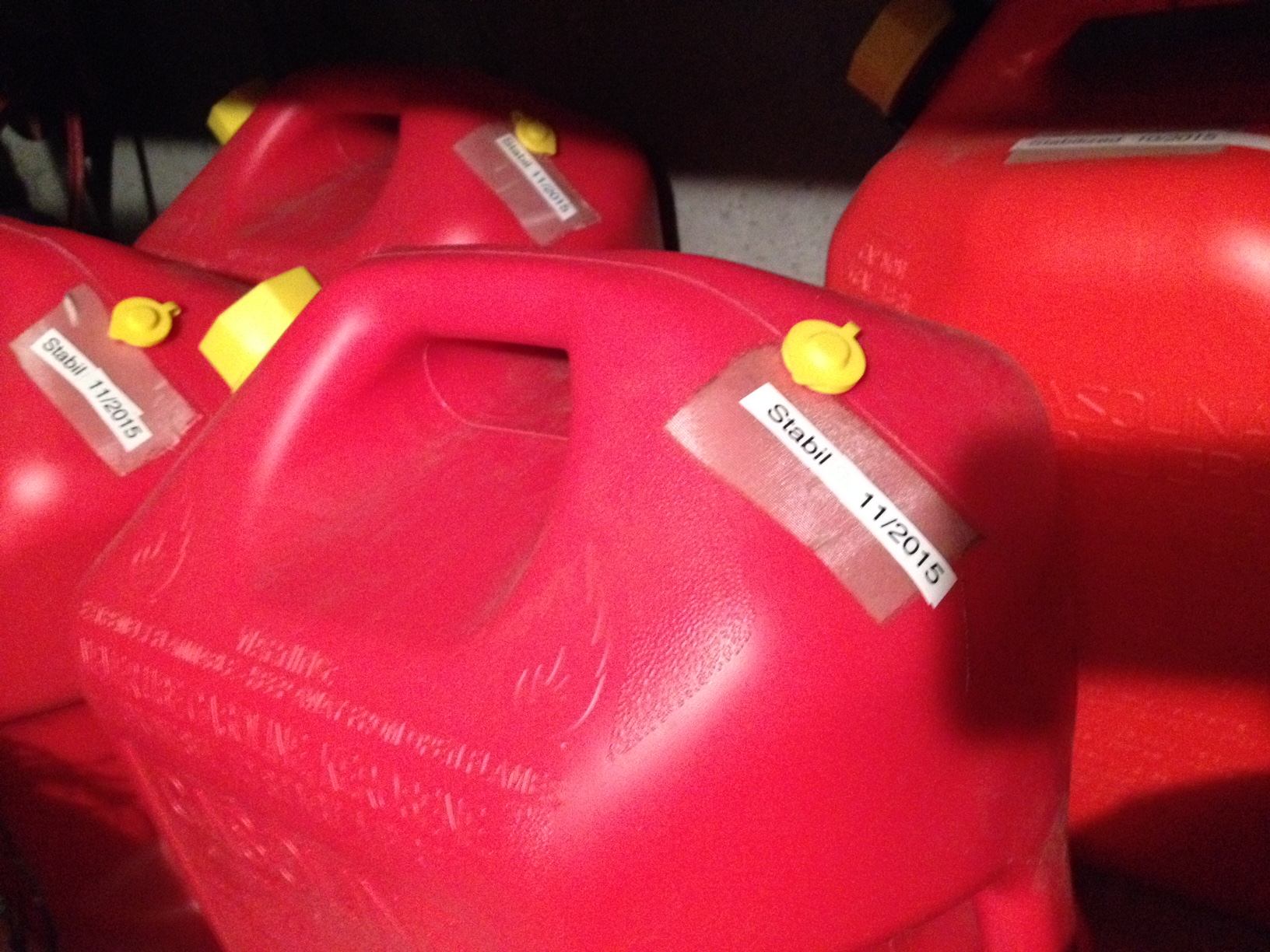

The Blitz video has more to it. When all of this was going on did anyone notice that the price of the low cost plastic gas containers doubled - no doubt for liability insurance. Kind of like the cost of lawnmower blades - much more cost in insurance than there is in making them.
/ Gas cans - really #62
The plastic container if stored indoors out of the sun might last 16 and 20 years, but are you saying that the junky plastic spout lasted that long, how many times did you replace the spout. Do all states have that non spill spout or is it only California, do you have a quality spout. All the plastic spouts on my plastic cans never make it over a year, they always crack.
I have an old school plastic can wo all the new carb stuff. It has always been stored in a garage. No problem w the spout. Both can and spout are 17 years old or so.

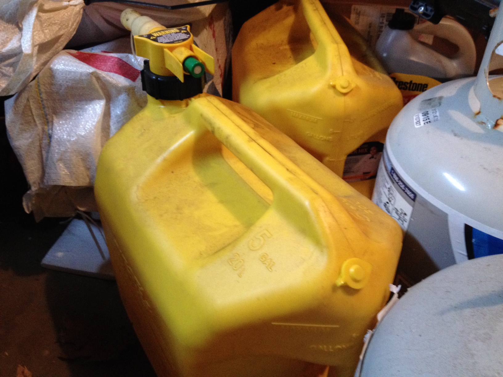

View attachment 499417View attachment 499418View attachment 499419
Add a vent (multiple sources on ebay) and I can pour 5 gallons in under a minute. The No-Spill diesel cans are the bomb. I put in the vent, and the pour time went from maybe 4-5 minutes to under one for 5 gallons. Highly recommend. The red cans, I have the vent, and bought a couple of the EZ-Pour nozzles. Solves the BS Govt. problem.
You are a godsend! I ***** everytime i use my red or yellow can. My thumb goes numb. I'm searching on line now! :thumbsup:

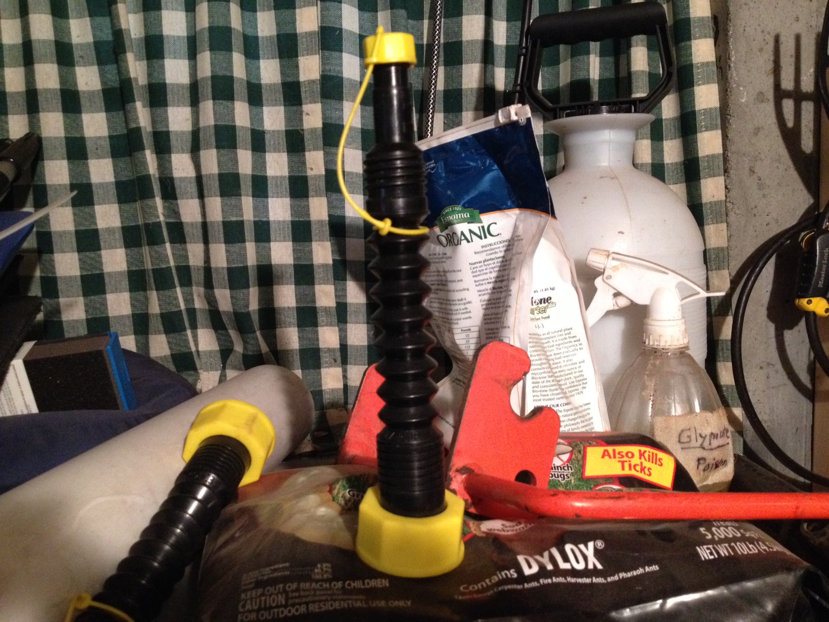

Here's another source if all else fails Replacement Spout Kit. Supposed to fit most of the plastic cans out there and retrofit the new style. I have three of the original Rubbermaid cans with one original flex spout intact. Wish I'd had the foresight to pick up a few replacement spouts when they were on the shelf for .99 or so back then.

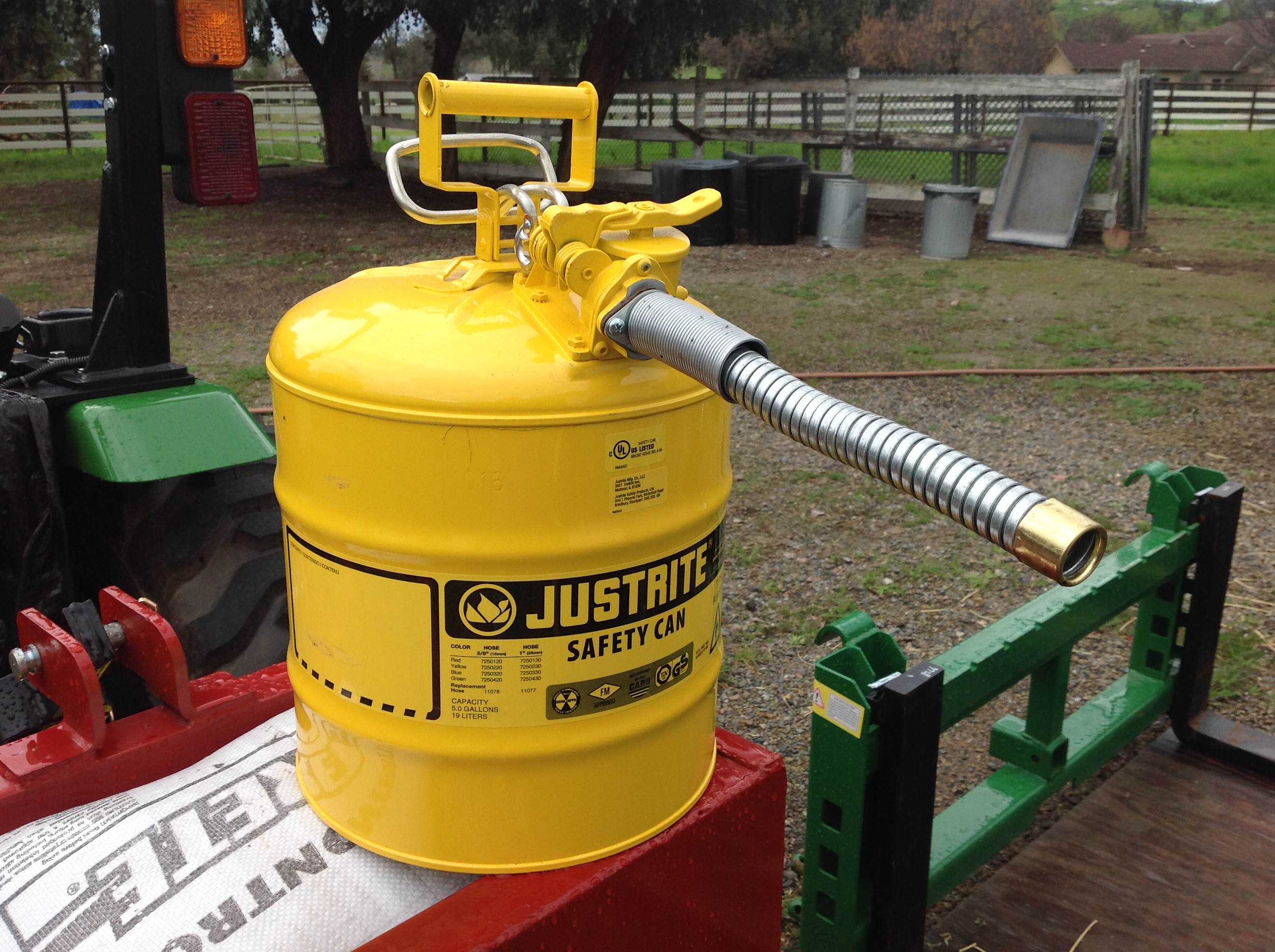

We've been using this very same, class II safety cans. They work great and should last for years. Here it is on Amazon
Justrite 72523 AccuFlow 5 Gallon, 11.75" OD x 17.5" H Galvanized Steel Type II Yellow Safety Can With 1" Flexible Spout: Lawn And Garden Tool Gas Cans: Amazon.com: Industrial & Scientific

These class II steel cans do cost more, but the plastic ones that last a few years and leak all along, just isn't worth it in my book. We have around 10 Justrite cans here. They're not perfect but pretty darn good.
