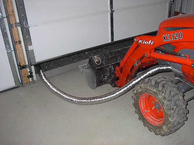

I saw a rig at a Newark fire house to solve that problem. The end of the hose had a flange with a bunch of magnets on it, the exhaust on the equipment had some type of similar ring. The hose was attached to a pipe fixed to the wall or ceiling, a few feet of slack. When the equipment pulled out the hose dropped behind.
Should be easy to rig up something like that, maybe run the hose out a dryer vent thru a window.

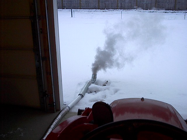

I've used a 5" diameter piece of aluminum duct, approx 24" long with std 8' length plastic rain gutter black ribbed tubing connected to it to route exhaust gases out of my shop for yrs without any appreciable notice of fumes lingering around. I screwed a couple of those metal duct straps onto the end to make hooking it to the vehicles/tractors/small engine's exhaust possible. It doesn't fit snug at all but it seems to route the fumes away OK. There has been times when I've had to connect two pieces together which would be around 16' of tubing to route the fumes out. In this case I didn't run the engine very long.
I've tuned engines up, troubleshot them and just ran them during the cold of winter (in the warmth of the ole shop) to circulate the oil, coolant etc., and charge the batteries like this. Sometimes I crank 'em up just to hear 'em /forums/images/graemlins/grin.gif
My garage/shop is detached so it's not on my homes hard wired smoke detector system but I do have a stand alone out in the shop and it doesn't set it off.
