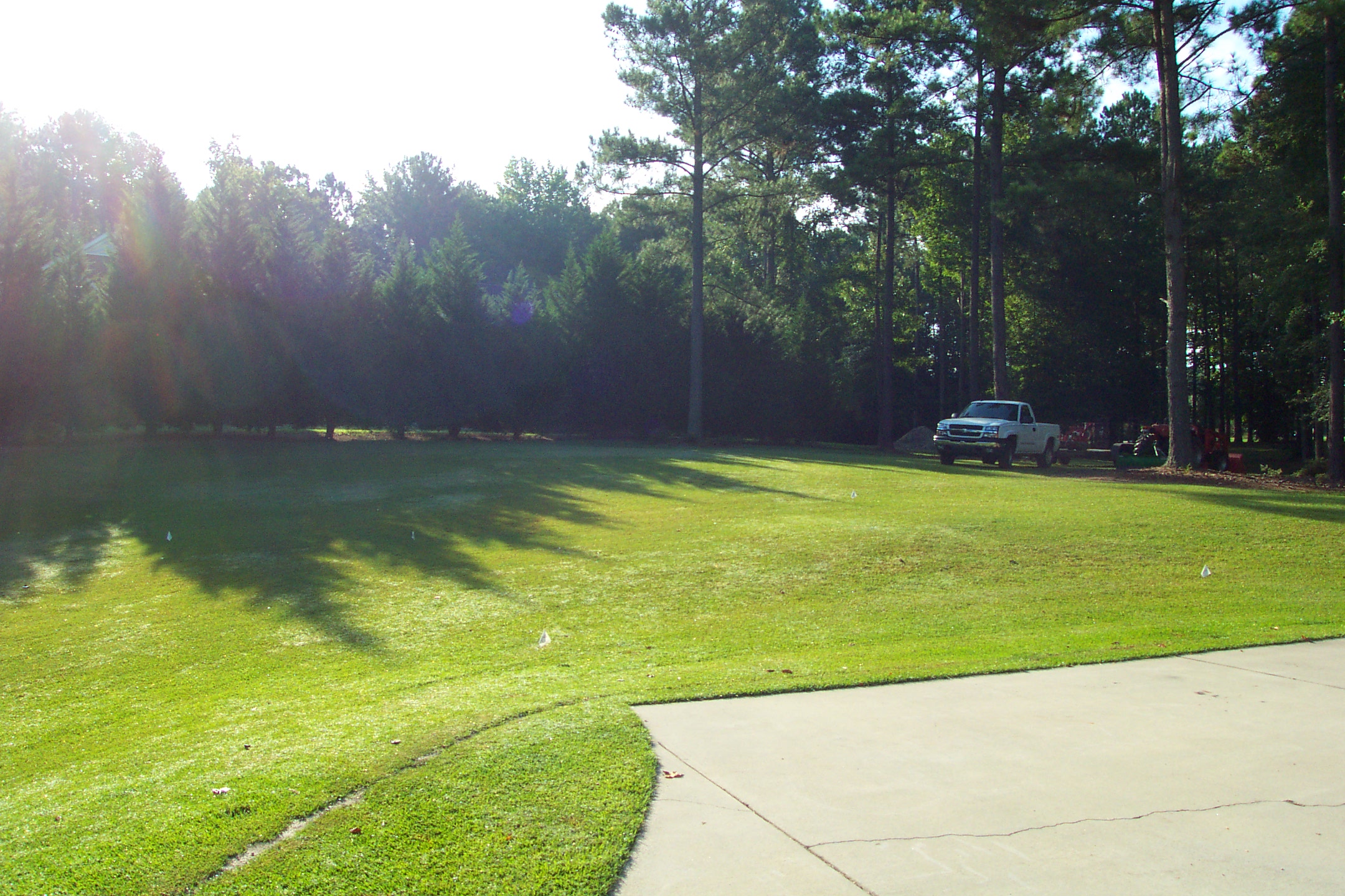

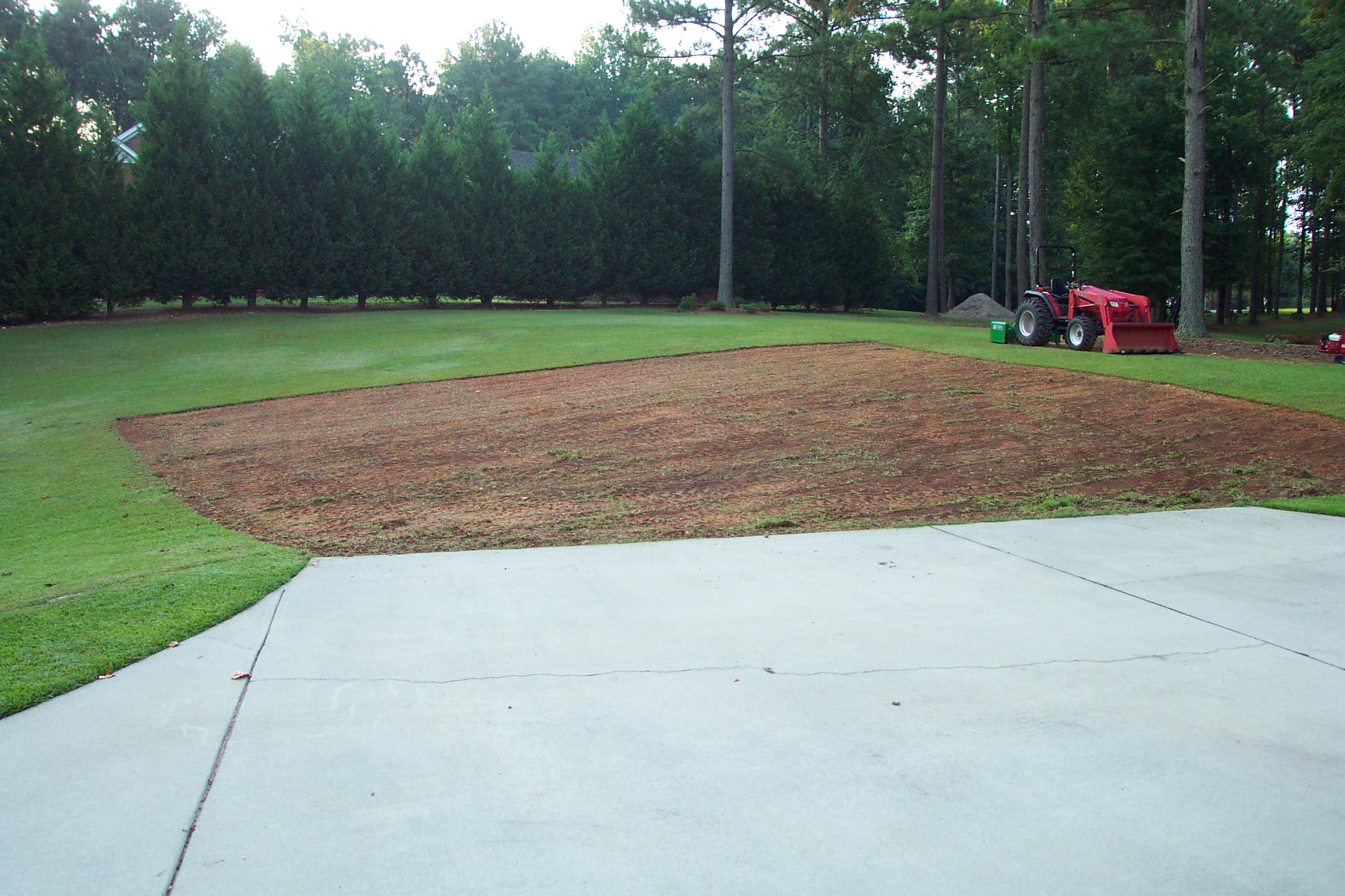

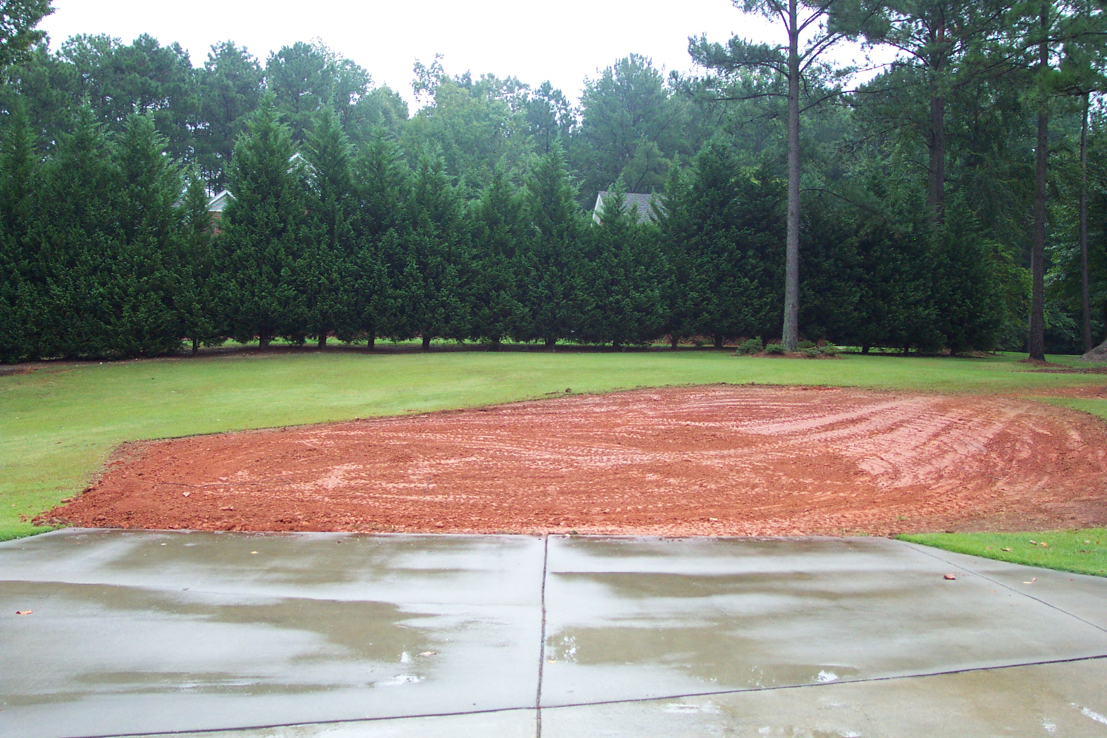

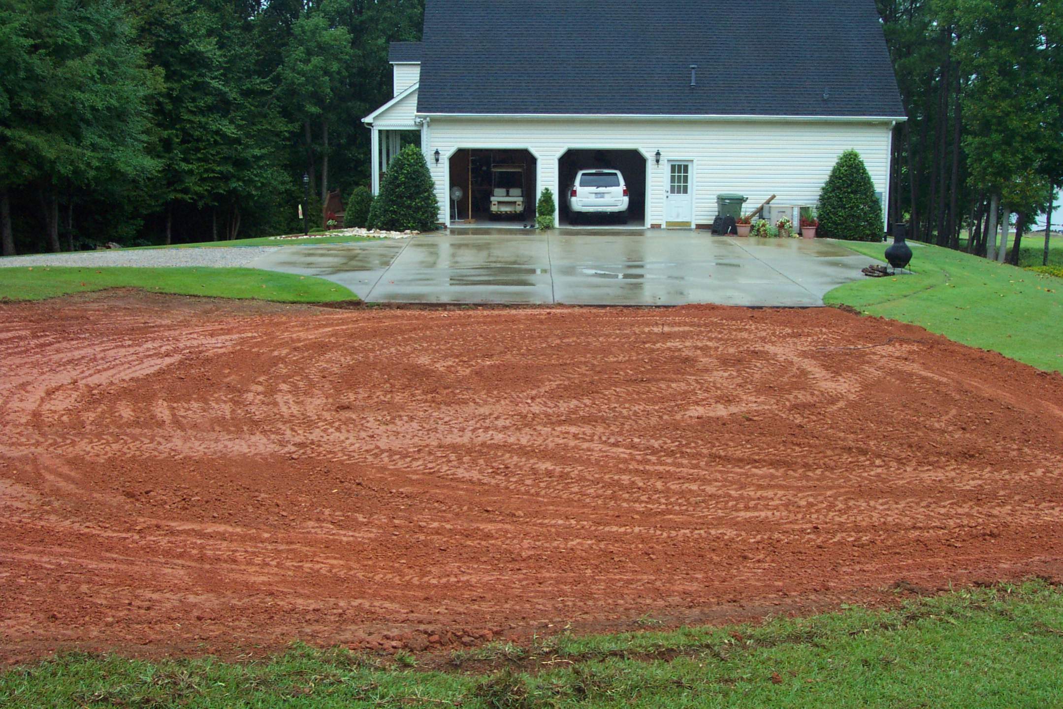

Centipede plus a sod cutter, a long hard day, a red tractor and a much more enjoyable day results in this big red hole.
Snared a bobcat today. Foundation digging starts as soon as things dry out a little. More photos as I go.

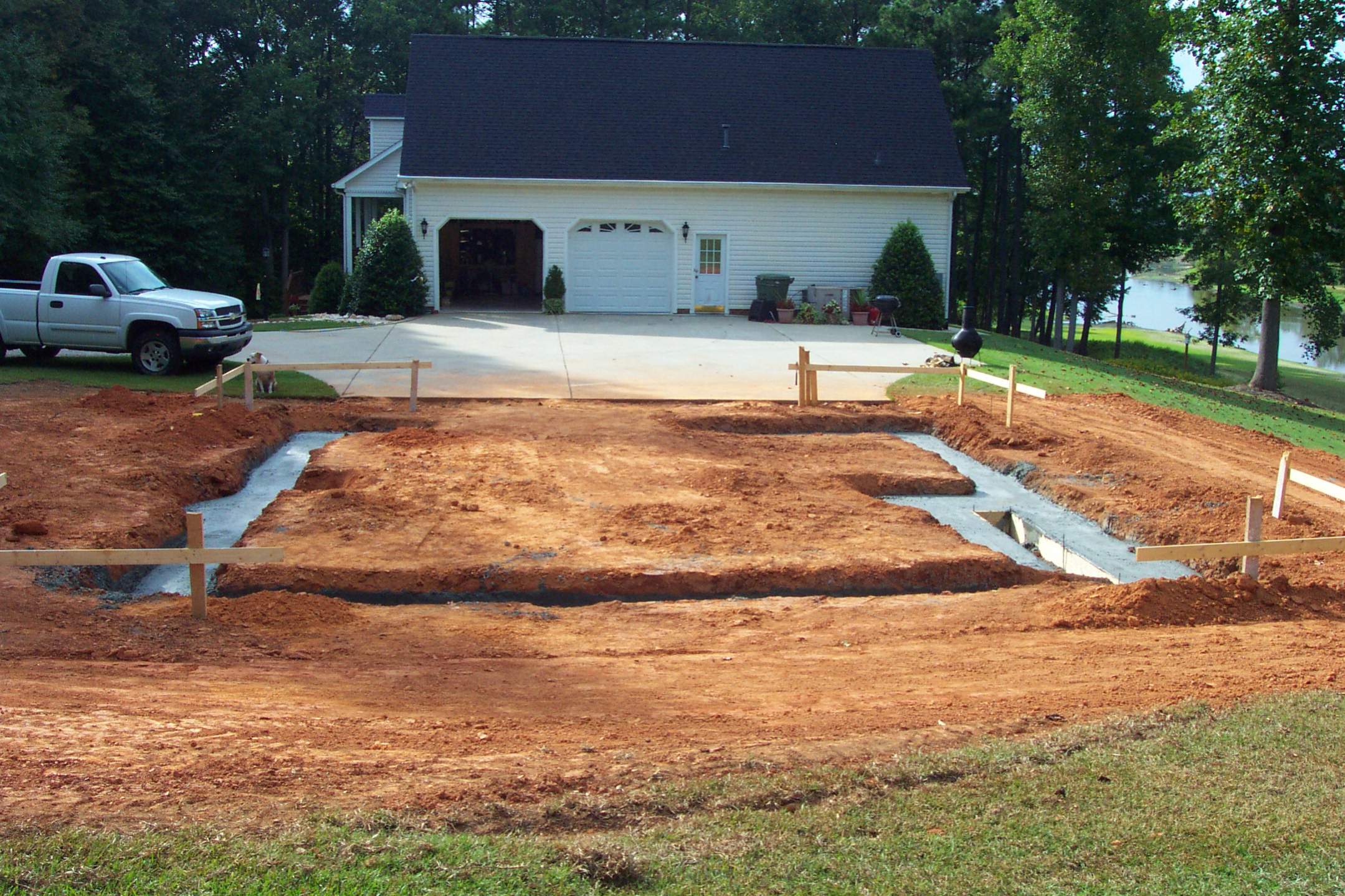

Thanks whitedogone. 96" was my error and was corrected to 72" on my approved plans per our wind zone's requirements. I submitted engineering statements on both LVL's so that's all good. I'e got a 2" fall from back to front of the garage pad and a 6" rise on it's 8' apron. My plans were marked for "lug footings" under both ends of the OH door LVL, no specs, so I increased the foundation footprint to 36" square under each side. Also increased to 36" sq under each end of the center LVL as well. Batter boards are up and one side dug after work today. Progress.....
I picked up a Dewalt laser level yesterday (Lowes $90) and am very impressed with it's performance. It's advertised at <.0625" in 20' and according to my builders level it's within tolerance. The beam is easily visable 30' in bright sunlight. I laid a plank diagonally across the batter boards on on end and shot down the length of the trench. Made it easy to step off the backhoe and check the depth at any time, a good trick if you're working alone.

Dug and poured. Boy i'll be glad to get this thing out of the ground. PLumbing rough in, kneewalls, slab and apron to go.
