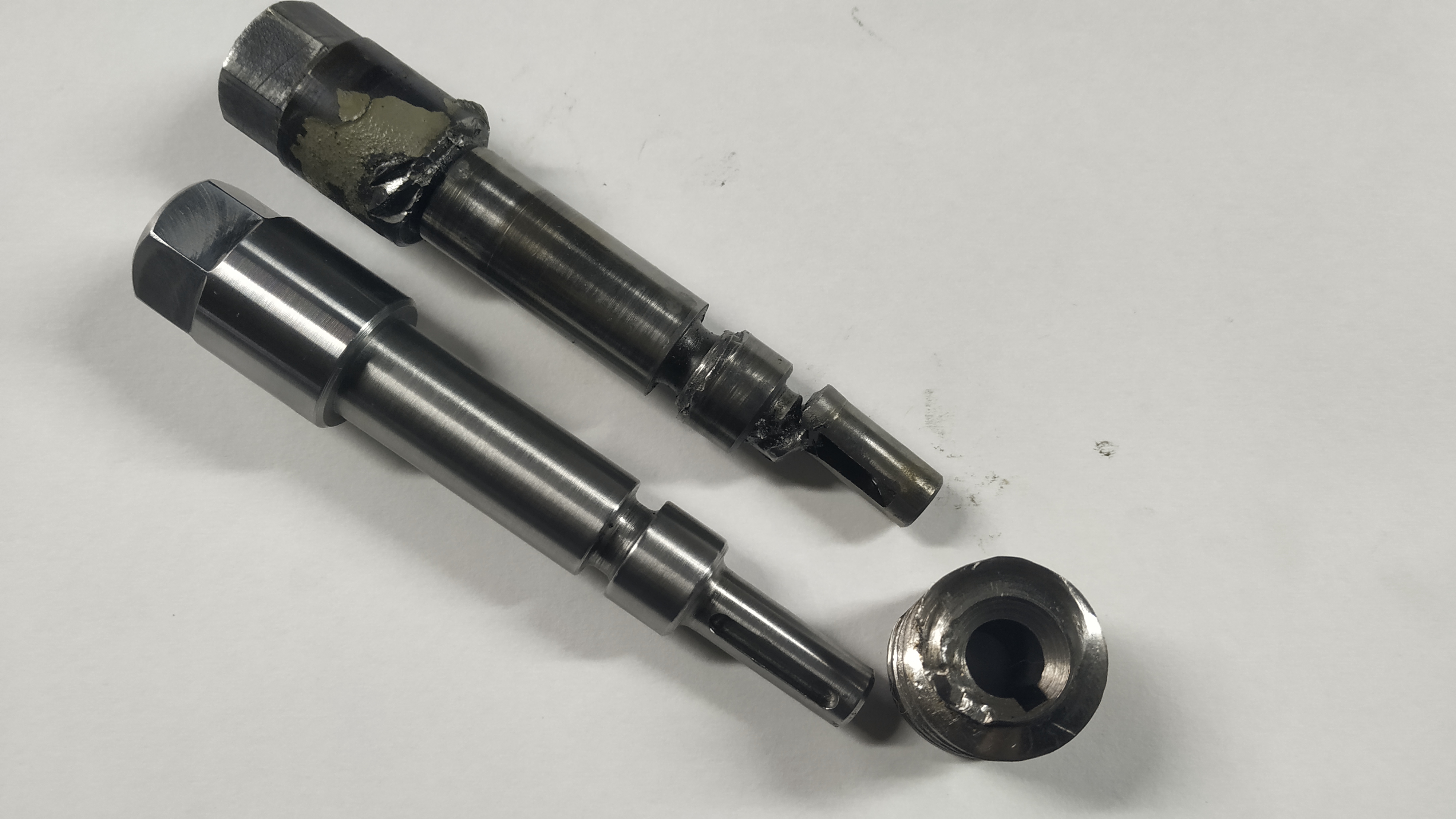

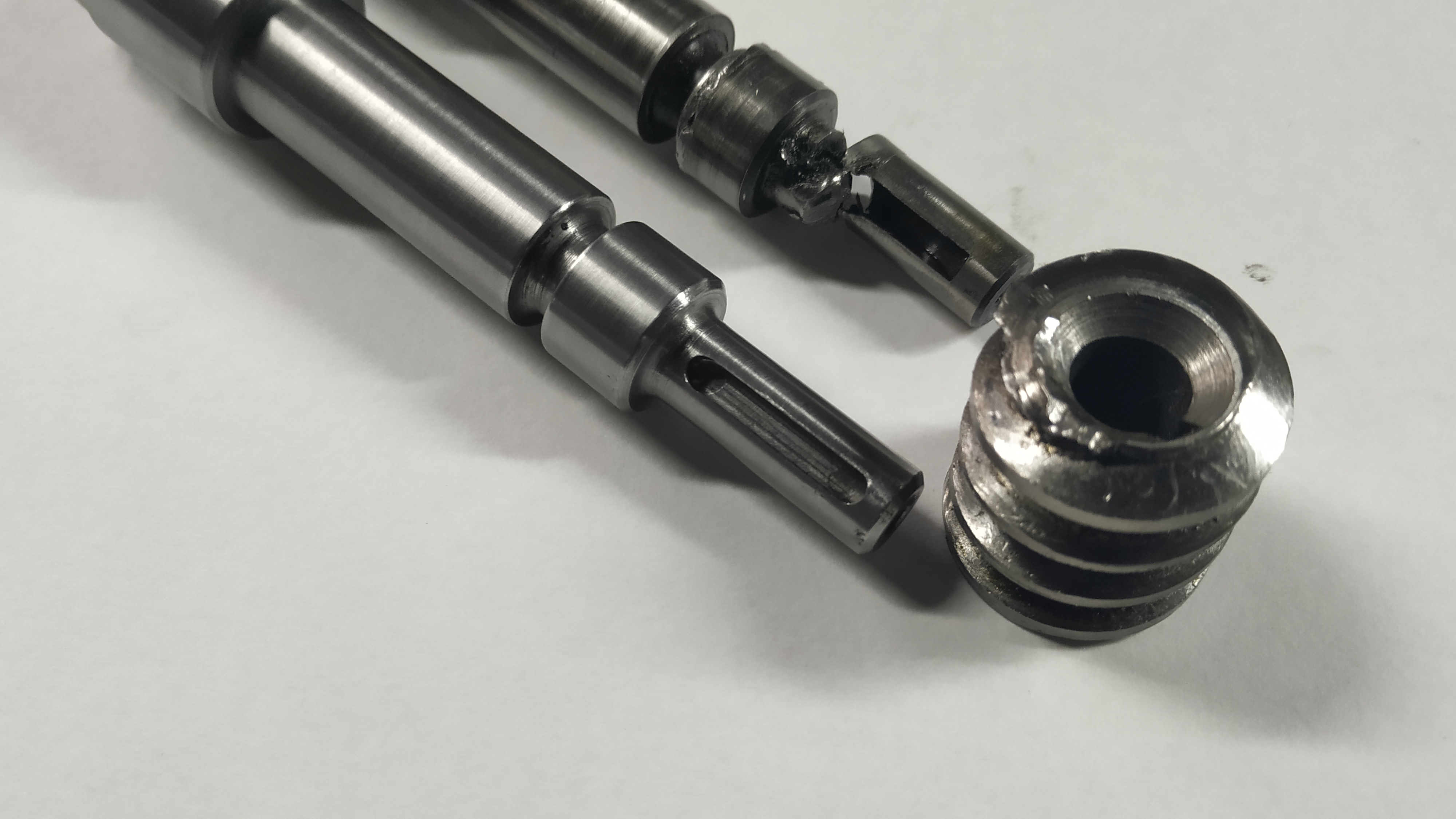

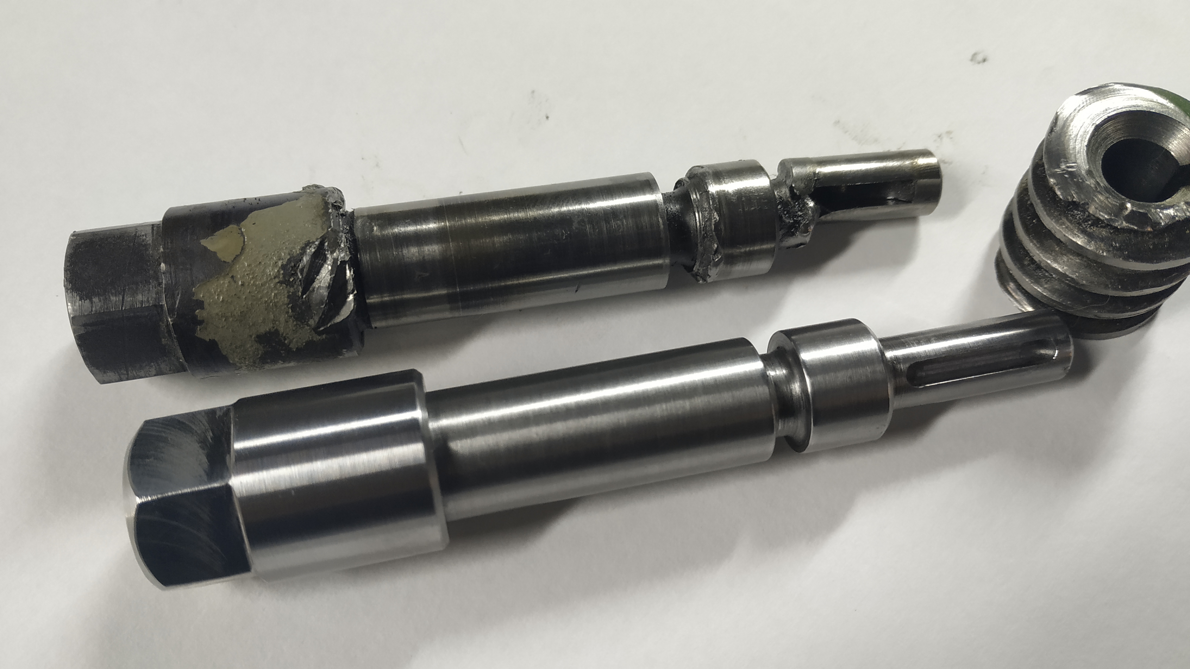

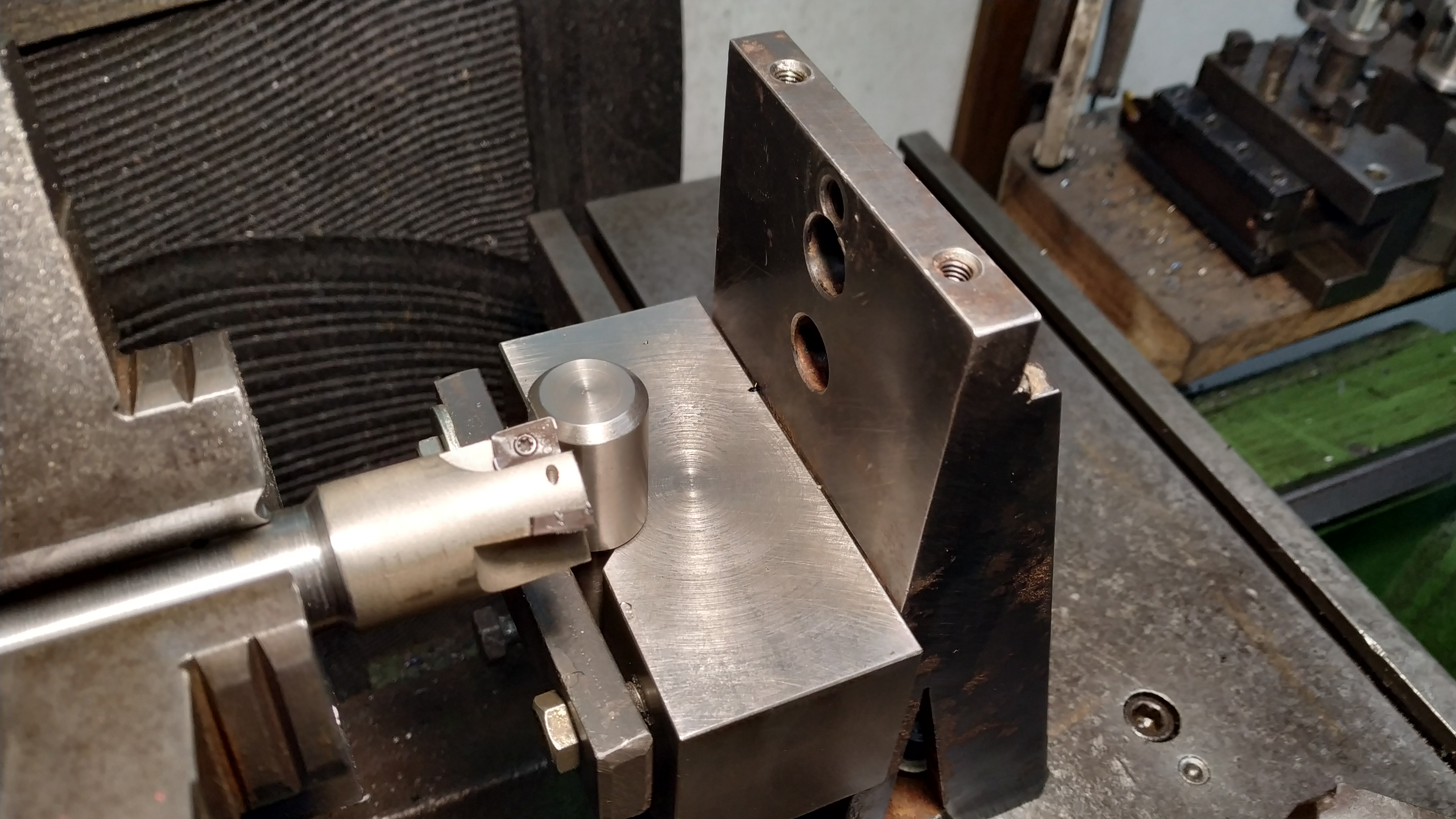

I just finished assembling the head of my 1971 Bridgeport after I took it all apart for a general maintenance (check, clean and lubricate all the internals) and to fix about the only flaw on the machine. It broke the shaft of the worm drive that tilts the head left/right.
So I fully machined on the lathe, including the hex for the wrench and the key way. It was a first for me to do a milling operation on the lathe.
For the key way on the shaft, I just held the part on one of the toolholders. For the hex part, I used a V block I made some time ago, attached it to another 90 degree fixture I had from completely unrelated machine. It worked perfectly.
You can also see the destruction on the original shaft. It does have a couple of faults on the design from factory. The smallest diameter, which will hold the worm and therefore have to deal with all the forces, only gets supported on one side (shaft side). I really don't understand why they didn't just drill the hole a bit further on the head of the milling machine, extended the shaft past the worm a bit, so it had support on both sides. The fault was that they used a woodruff key on the original shaft, this means that the slot is much deeper in the shaft, causing a weak spot.

Very nice fix, so using the tool holder vice, clamped on V block to hold shaft from moving is what I'm picturing, other wise I see no other way to hold round shaft from moving.
Is there a way to drill the hole deeper in the head so's to support the small end of shaft?
   / Garage hacks, adjustments and annoyances......... #77
Yes, it could be done. It would involve a crazy fixture setup on the lathe though.
I'm not expecting for it to be a problem again for a couple of reasons. One is that I used a much better grade of steel and machined radius instead of sharp corners along with using another style of key.
Another reason is because this machine doesn't see a fraction of the use it used see back in the previous owner, which was a tool and die shop and it would work 8 to 12 hours, 5 to 6 days a week along with 8 or 9 more milling machines.
The last reason is that, we all know that some employees won't care at all about equipment or tools, so they wouldn't release the locking bolts all the way, neither help lifting the head with one hand, so imagine the stress of rotating an already heavy head while the locking bolts are still creating an huge drag. Something is gonna give.

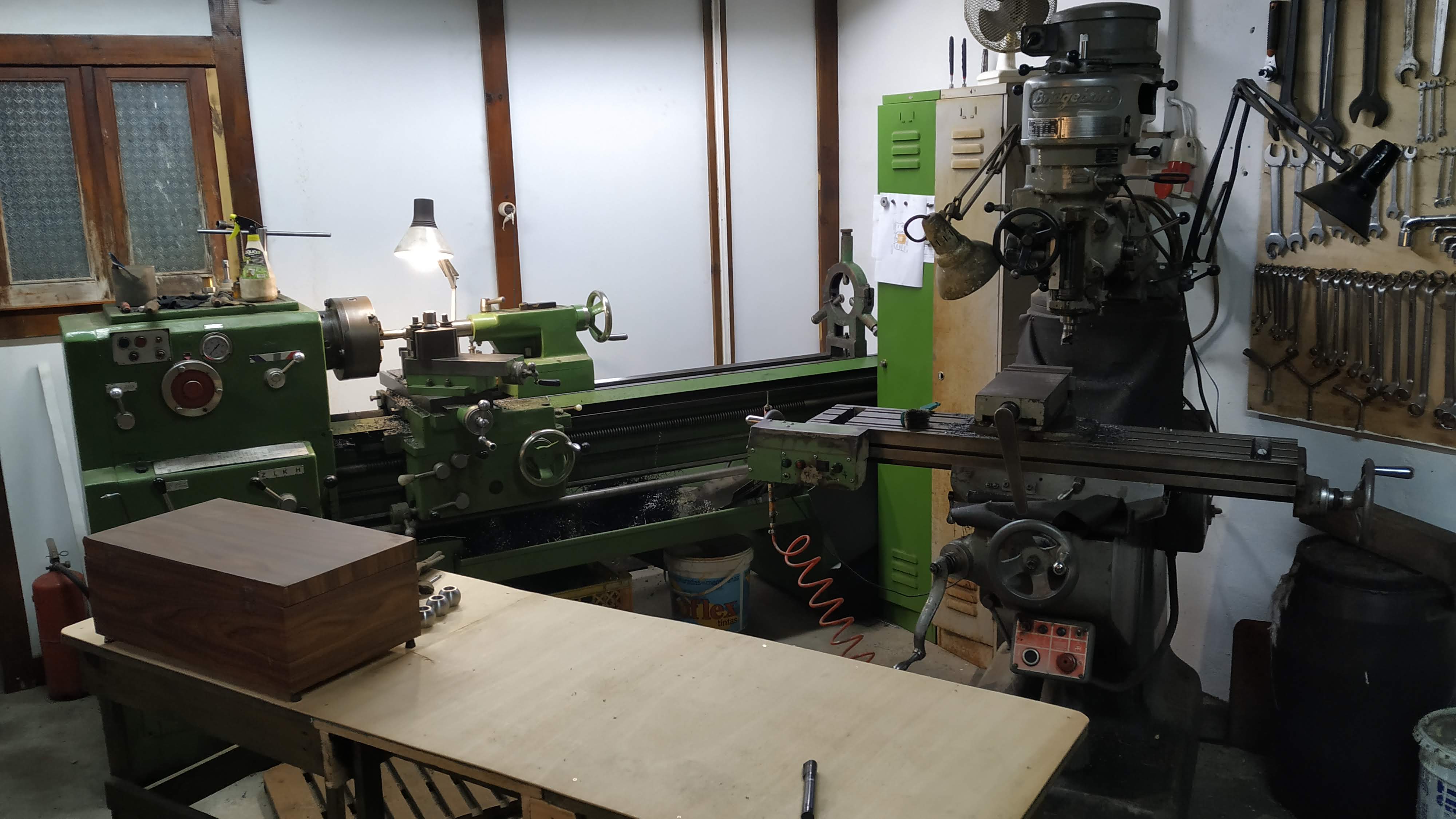

:thumbsup: Can you post a picture sometime of the milling machine when all up and running?
   / Garage hacks, adjustments and annoyances......... #79
Sure :thumbsup:
Here is a picture of my little machining corner. It's about a year old picture from when I completely re-organize the shop, hence the still clean bench. :)
I've since upgraded for a much heavier and bigger bench and the milling machine is slightly different as I build a power feed for the Z axis and re-designed the X axis power feed, both not pretty but work very good. Anyways, it's on the paint job waiting list along with it's cabinet.

Very nice, clean work! That setup musta been fun...NOT! I take it you did the key way like that too...flipped the setup with the v-block 90 deg? Yessir, a proper dude works with what he's got on hand and get's er done!
