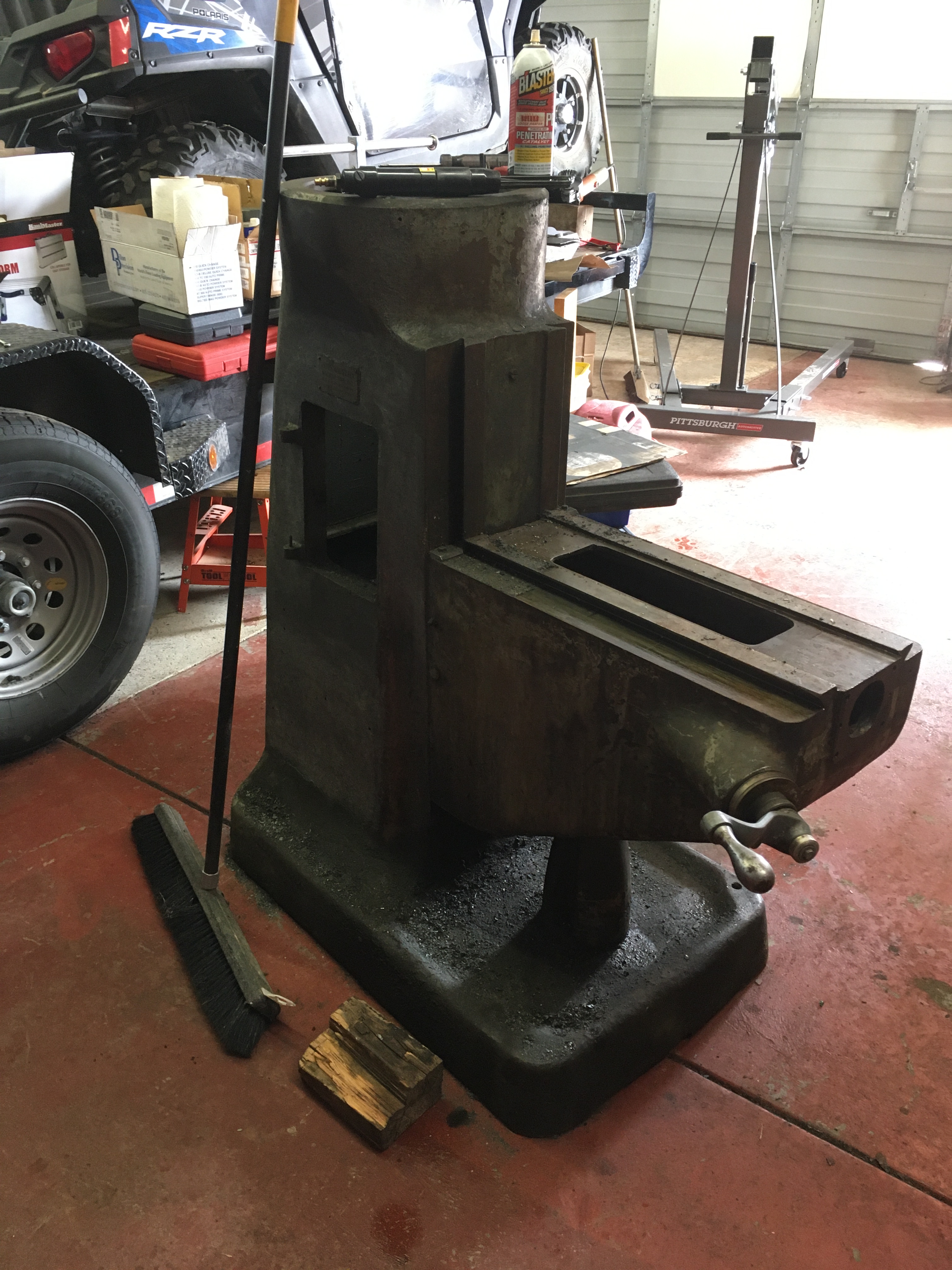

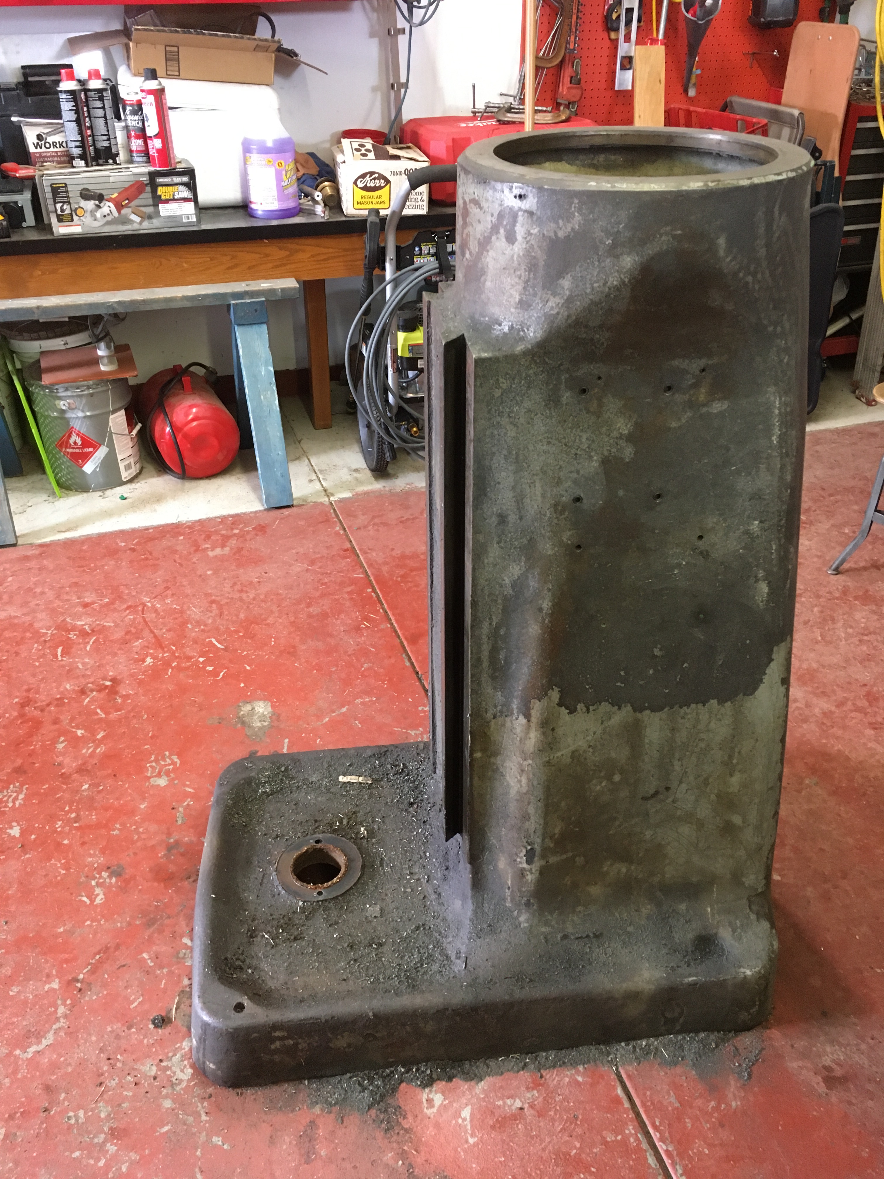

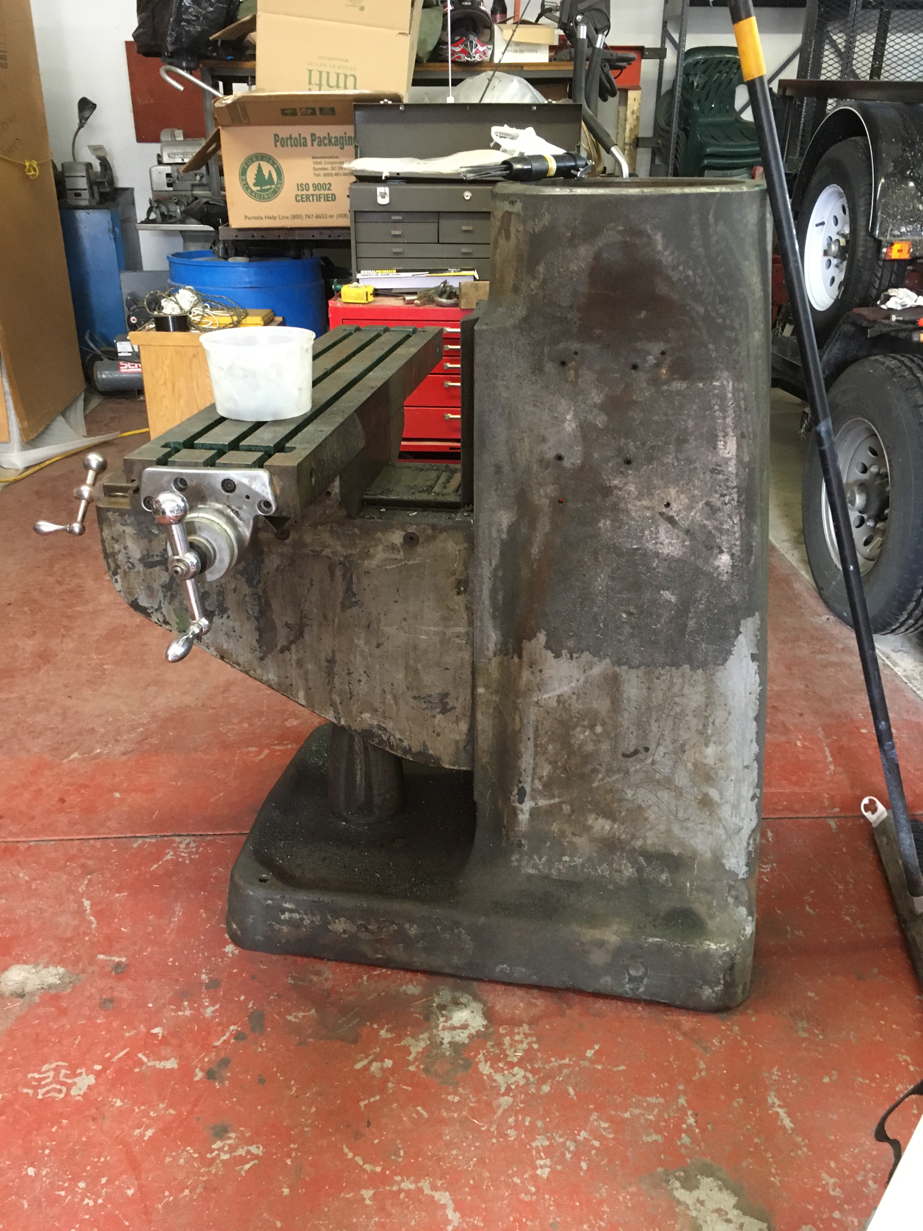

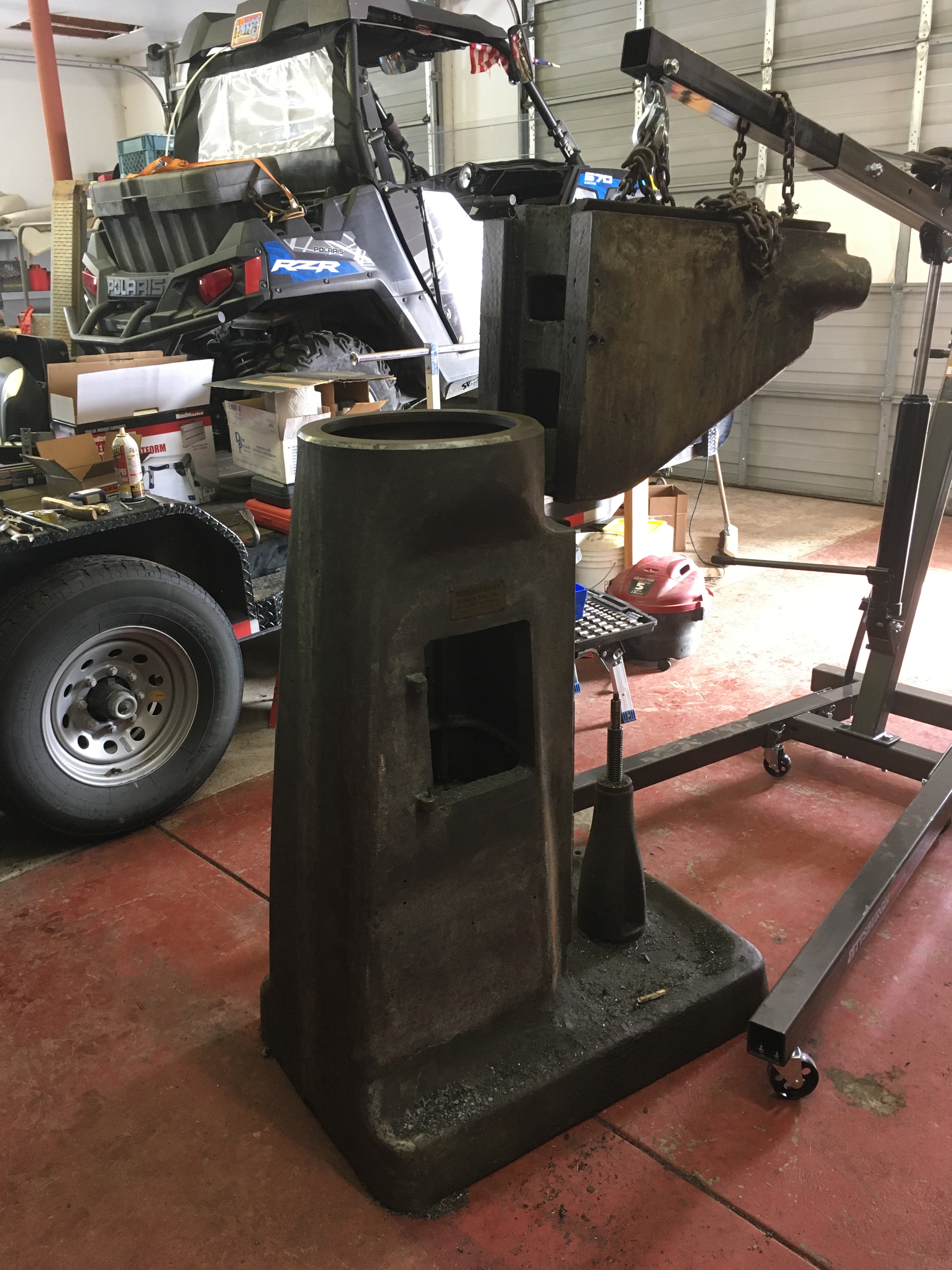

Made a bit of headway on the mill yesterday. Removed the table, saddle and knee so now it is ready for cleanup, removing any paint/rust and painting.
I have been considering putting it on caster wheels which might be something you should consider for your lathe/mill. First thing will be to find some casters up the the task, about 2500 lbs.

I just went on the Grizzly tool site and their casters are cheaper than I thought, they might be up for the task but then the leveling feature I guess has to be invented on. Shop Tools and Machinery at Grizzly.com
   / Garage hacks, adjustments and annoyances......... #70

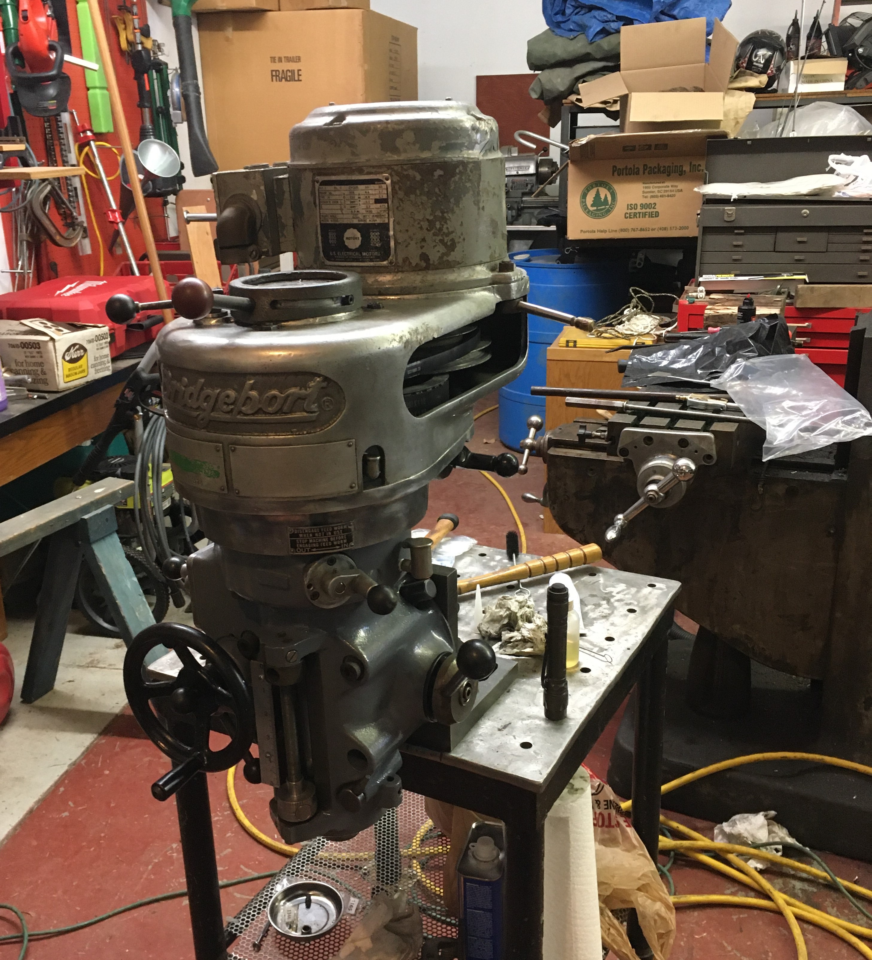

That mill is the same brand as mine but it has the variable speed head where mine has step pulleys to change spindle speeds. Other than that they are virtually the same.
I found my model of lathe was built from the late 60's to the mid 70's and my mill was built in 1967.

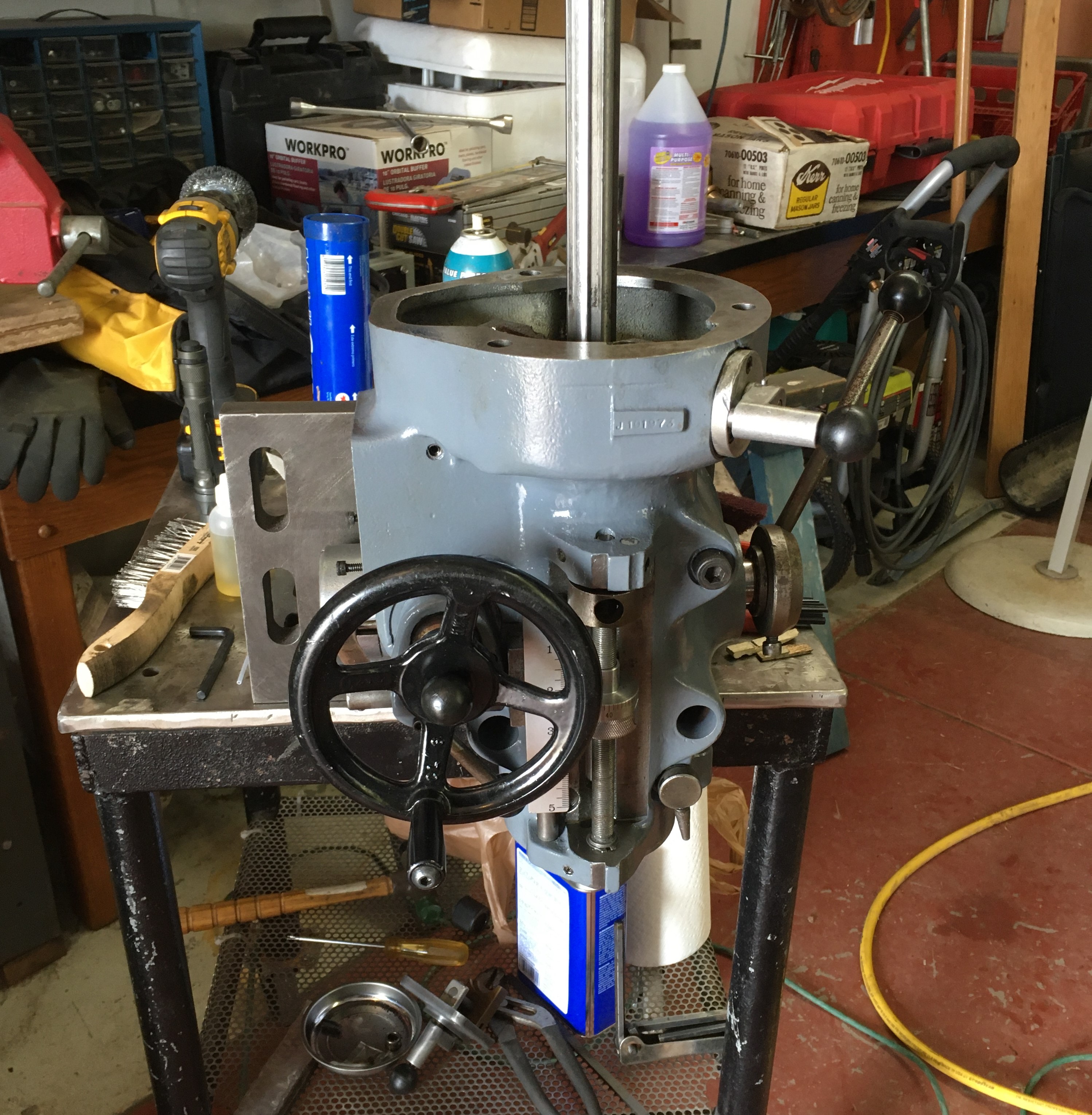

Here is the mill head as of Saturday morning. View attachment 646885 Then by Sunday morning it was pretty much done. View attachment 646886 Notice in the sides of the upper head you can see the step pulleys where on the pictures you posted the sides are closed.
ETA just depends on how much time I have to work on it but I expect to take several more months as I am completely disassembling the mill, stripping off all the paint, repainting it and fixing any problems.
Nice. I got a Taiwan clone of the step pulley Bridgeport, Precision Matthews brand. I went new because I needed it for work, was worried about getting a clapped-out machine. However, as soon as the Matthews arrived, could see right away it ain't no Bridgeport.
