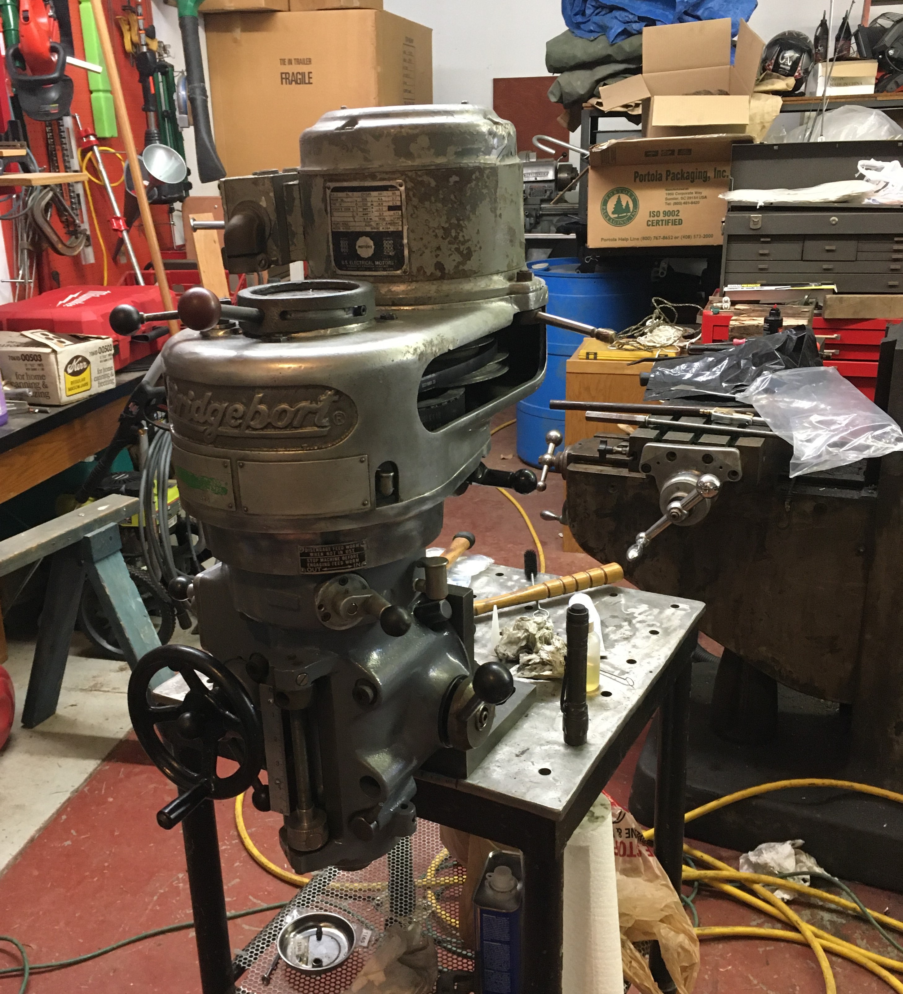

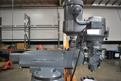

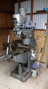

Looks like now your even further back in time to maybe 40s-50s on that super duty milling machine, it just has that antique look about it. Whats the ETA of getting all up and running? Tried to find pictures of it and heres the closes I found.
View attachment 646335 View attachment 646334
That mill is the same brand as mine but it has the variable speed head where mine has step pulleys to change spindle speeds. Other than that they are virtually the same.
I found my model of lathe was built from the late 60's to the mid 70's and my mill was built in 1967.

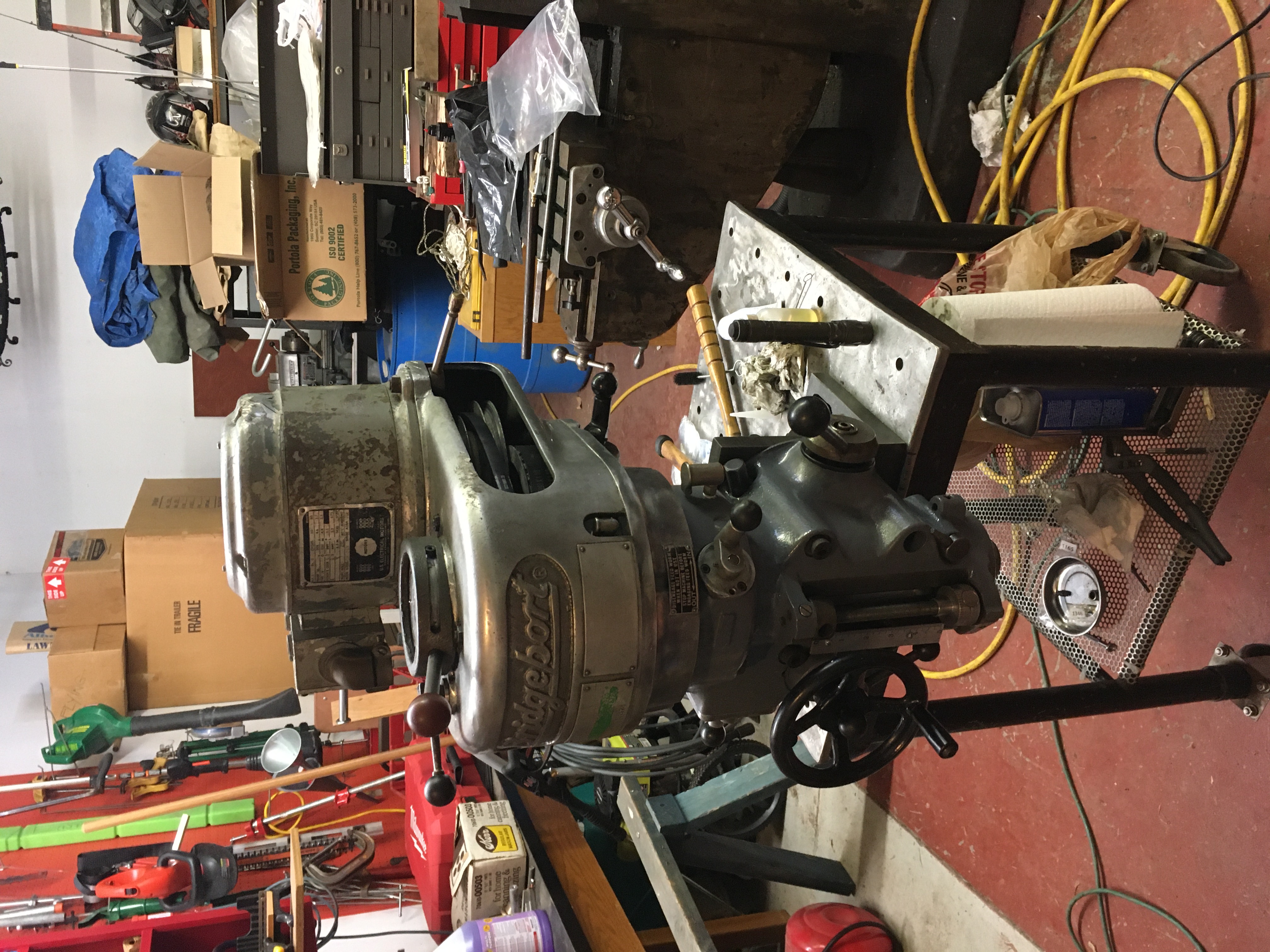

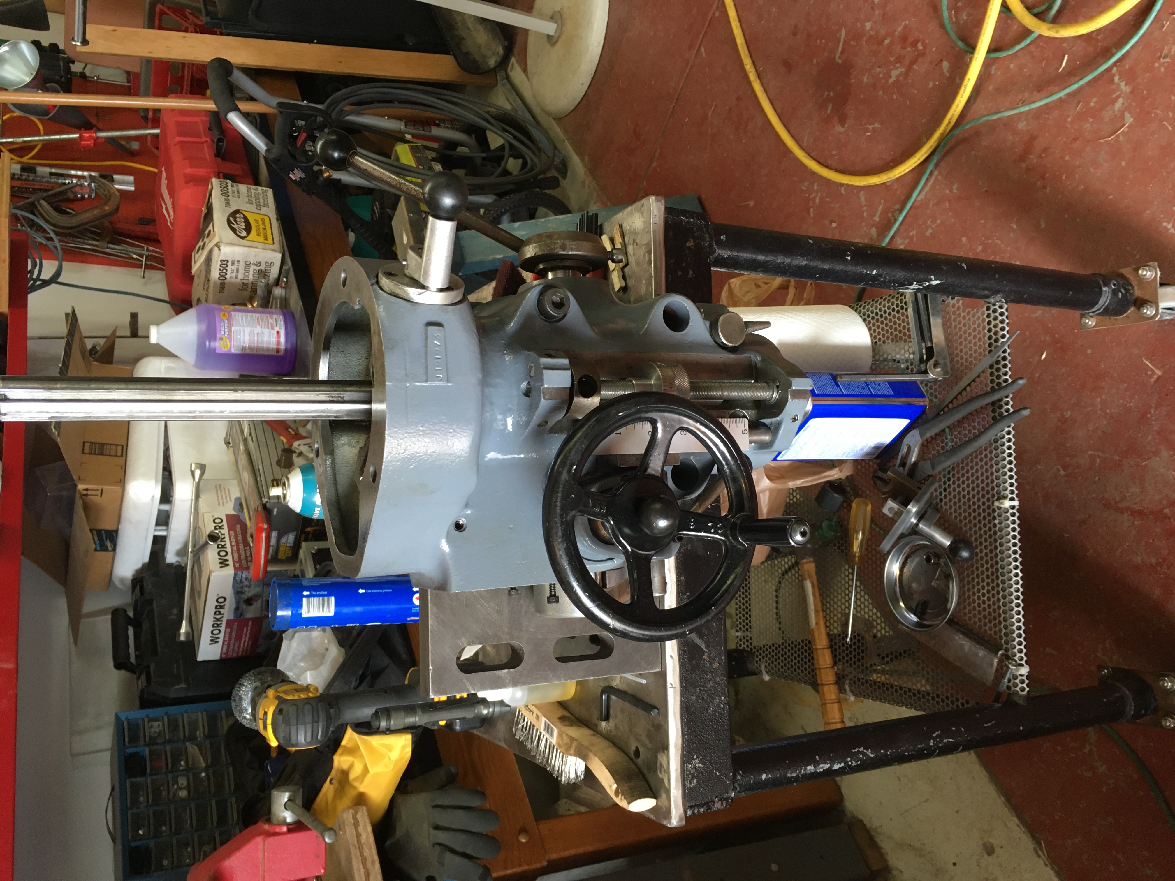

Here is the mill head as of Saturday morning. IMG_0391-2.jpg Then by Sunday morning it was pretty much done. IMG_0396-2.jpg Notice in the sides of the upper head you can see the step pulleys where on the pictures you posted the sides are closed.
ETA just depends on how much time I have to work on it but I expect to take several more months as I am completely disassembling the mill, stripping off all the paint, repainting it and fixing any problems.

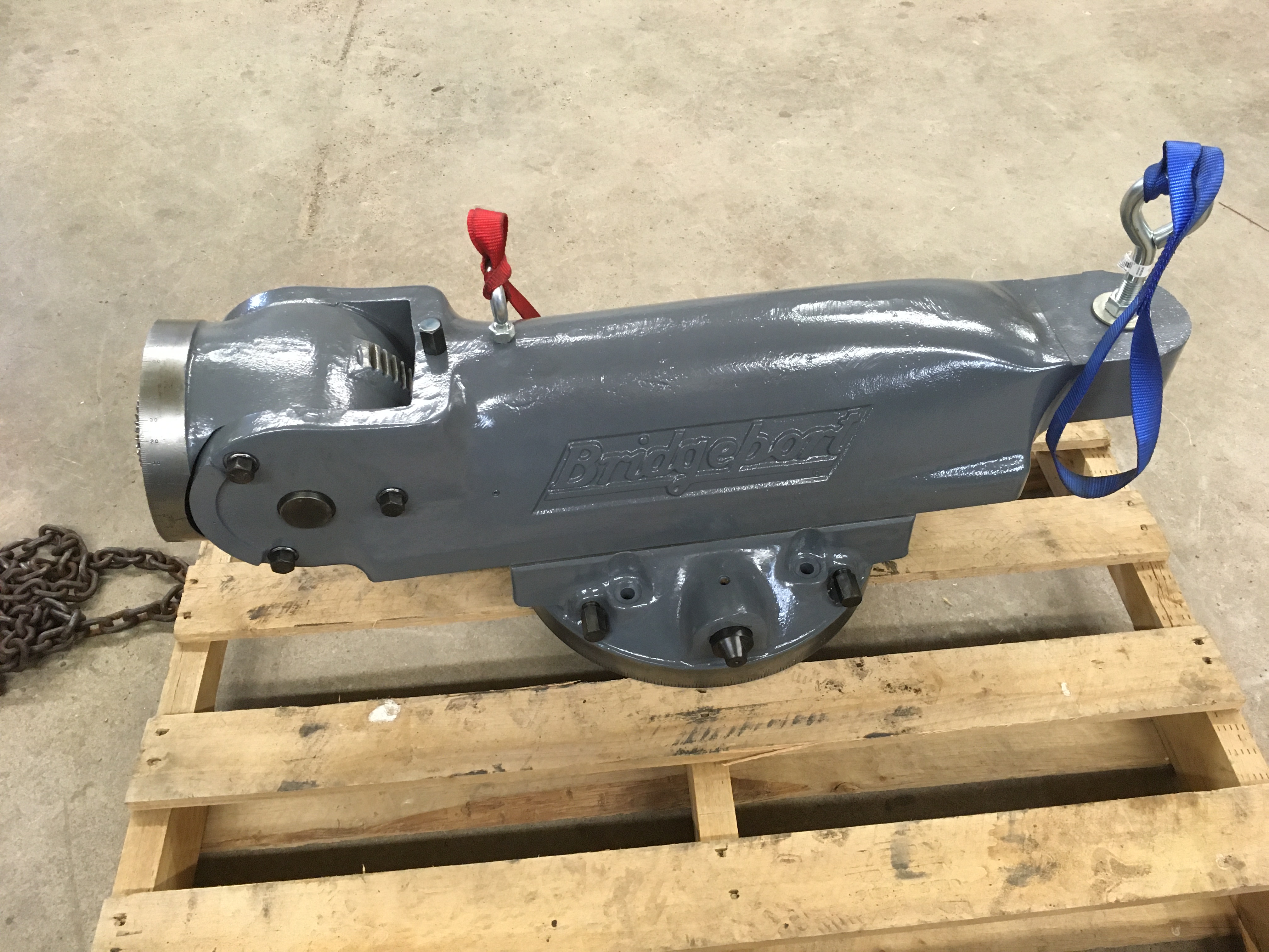

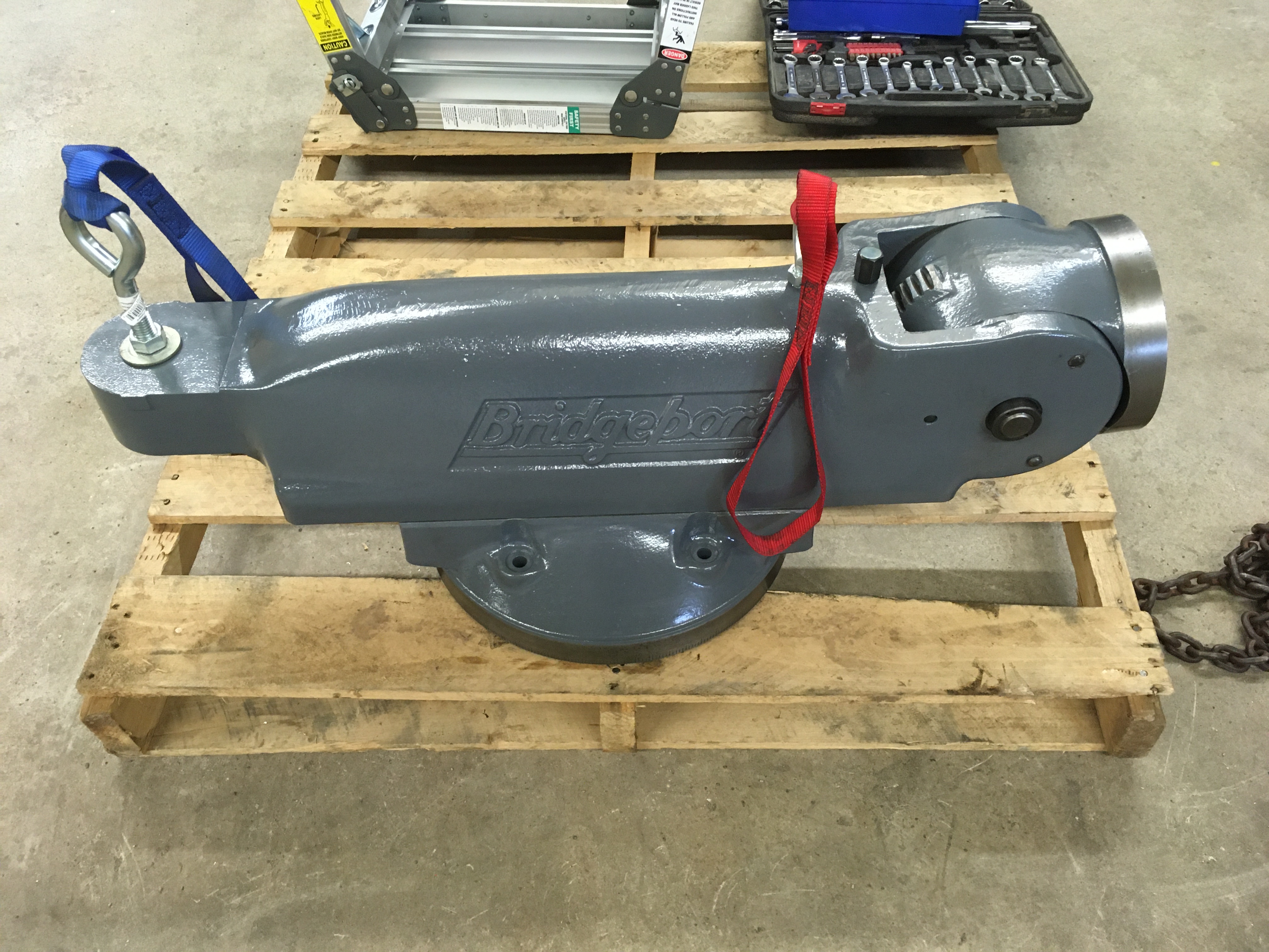

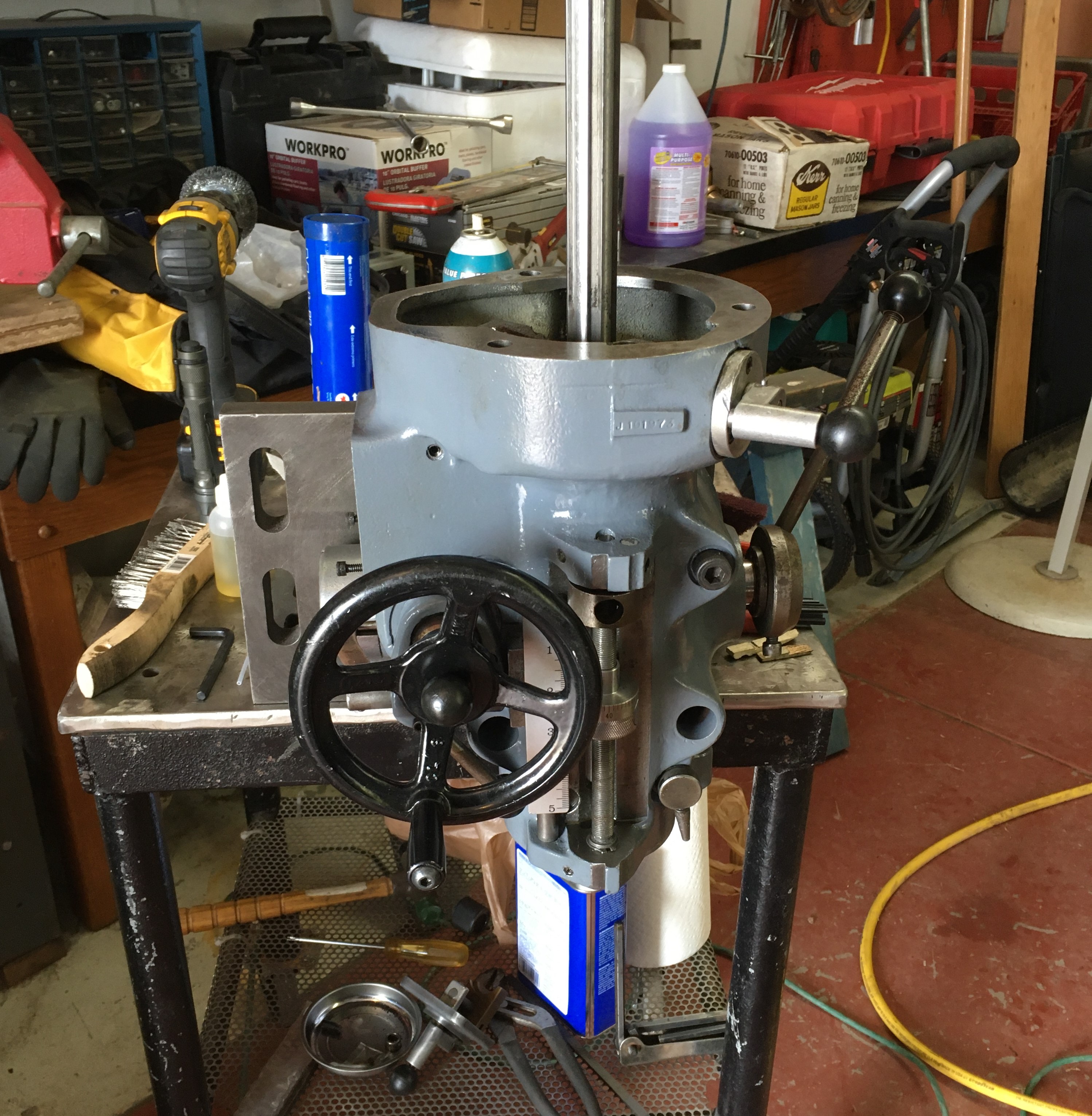

Yup, I like to bring the old stuff back to life. It won't be as good as new when I get done but it will do everything I need it to do. And it won't cost me $20K either. I finished the ram, knuckle and turret. I didn't want to paint the bolt heads due to the paint chipping when I wrench on them so I used cold blue for firearms. Seems to work fine.
Now on to other parts.

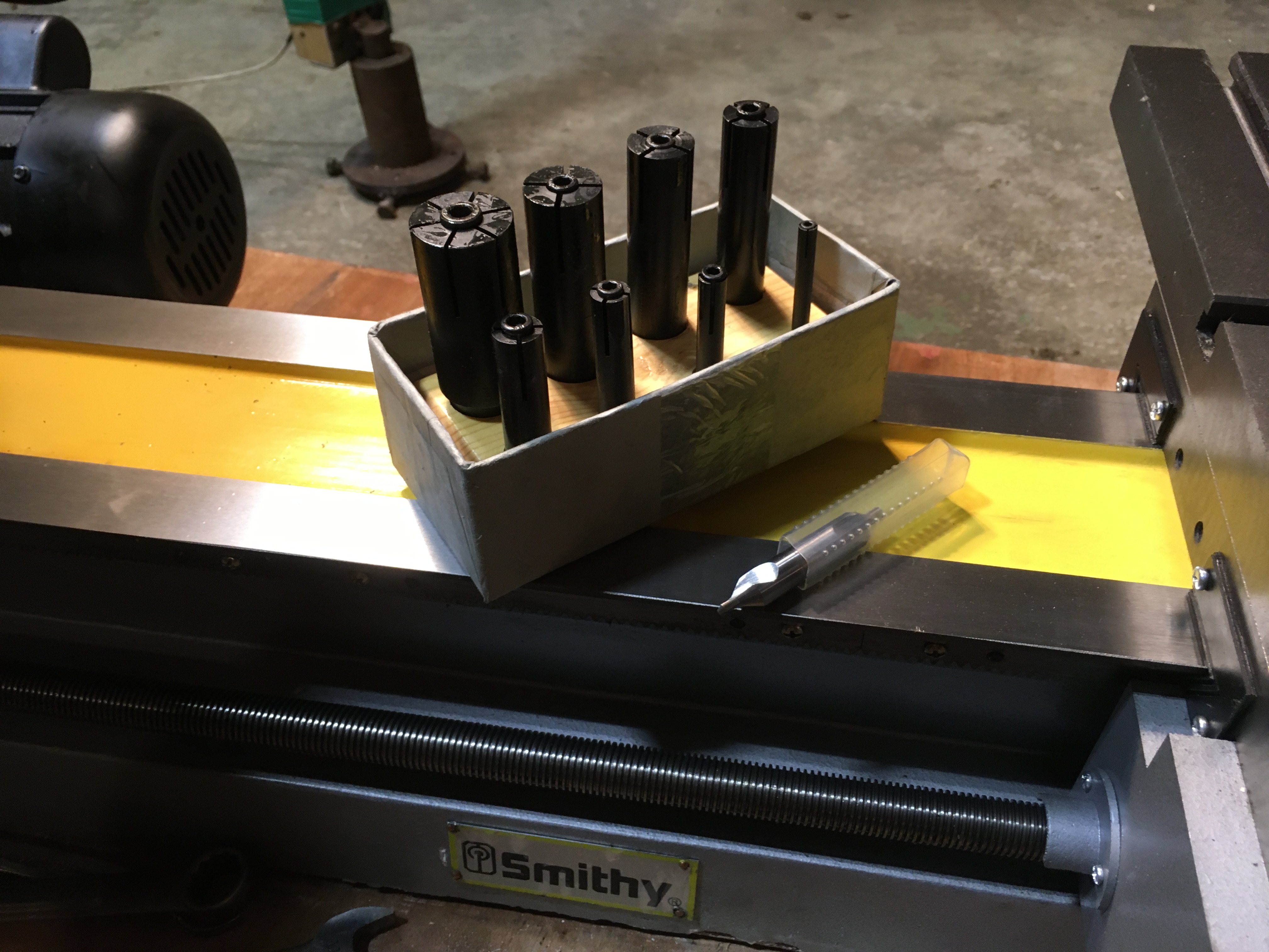

I dont suppose you would know what these accessory's are used for? I'm sure they have something to do with milling.
   / Garage hacks, adjustments and annoyances......... #59
look like collets to me and a center drill
   / Garage hacks, adjustments and annoyances......... #60
Very nice, thanks for showing your pictures I look forward to them, your getting more done then I am. Your paint job is good, battleship grey gives it that antique look are you bothering with primer first? If you was good with free hand a different shade of grey on the name would look nice, also great idea on the bluing is that something you already know how to do?
No primer, the rattle can I am using says primer is included. I am terrible with free hand but my wife has offered to paint either the lettering or the background so we shall see. I think we will load a picture into a paint program so she can try different things to see how it works.
Cold bluing is pretty simple to do, just wipe the solution on, let it sit a bit then wipe it off. In this case I poured the solution into a small cup then dunked the bolt head into it. That made them darker and it worked faster. It was a lot easier and faster than painting them.
I'm guessing your picture is showing collets but if those are collets, they are a style I am not familiar with. I would guess they are a morse taper but I don't know for sure. Your spec book on the lathe may specify what type of collet it is setup for. It appears they are also coated with a rust preventative so all that will have to be cleaned off good before use. That may also revel some markings indicating what they are.
