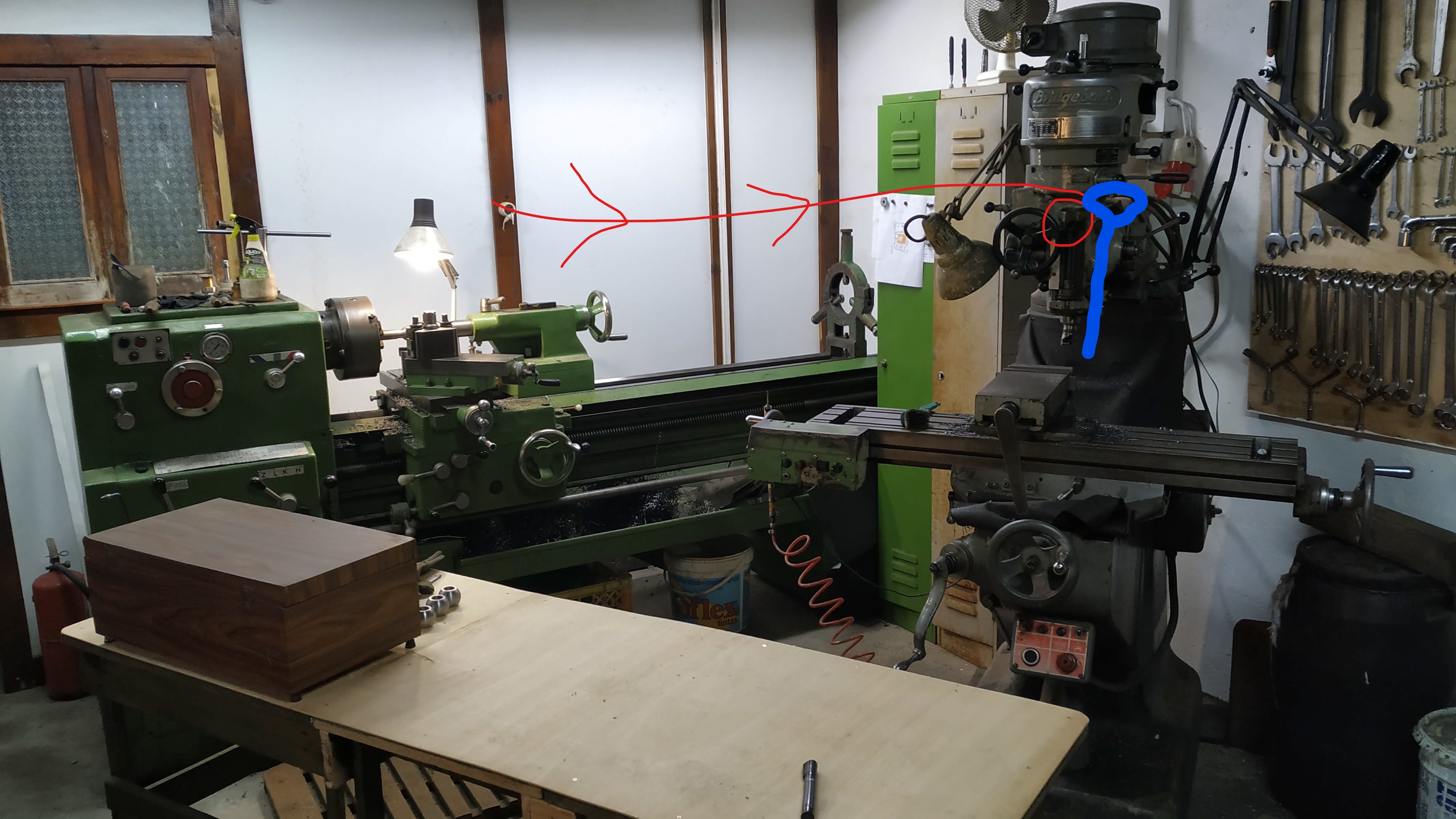

Nice shop with plenty of wrenches. Now let me make a couple guesses here, 1>to cold to paint, 2> This guess will be a bit harder, wheres the the rebuilt shaft go, I say here or close by......
The weather has been nice, but the last to days temps drop drastically along with rain. It dropped from around 82F to 45F in a matter of 2/3 days.
The machine has been in the waiting list pretty much forever, along with the forks for the loader and the carry all box. I just don't like painting but the day will come. In my defense, we can't go out to buy paint because of the virus. :)
You nailed it on the shaft location but it's in the back of the head, you can't really see it. The worst part is that requires to take the full head out, so you can take the little 1/4" set screw and it finally lets you pull the shaft out. Since I don't have any lifting equipment setup on the shop yet, I had to take the head off in 3 parts, the motor, the top half and the bottom half.

A bit further right and to the back of the head. You used a pencil, I used a crayon. It is used to rotate the head to either side.

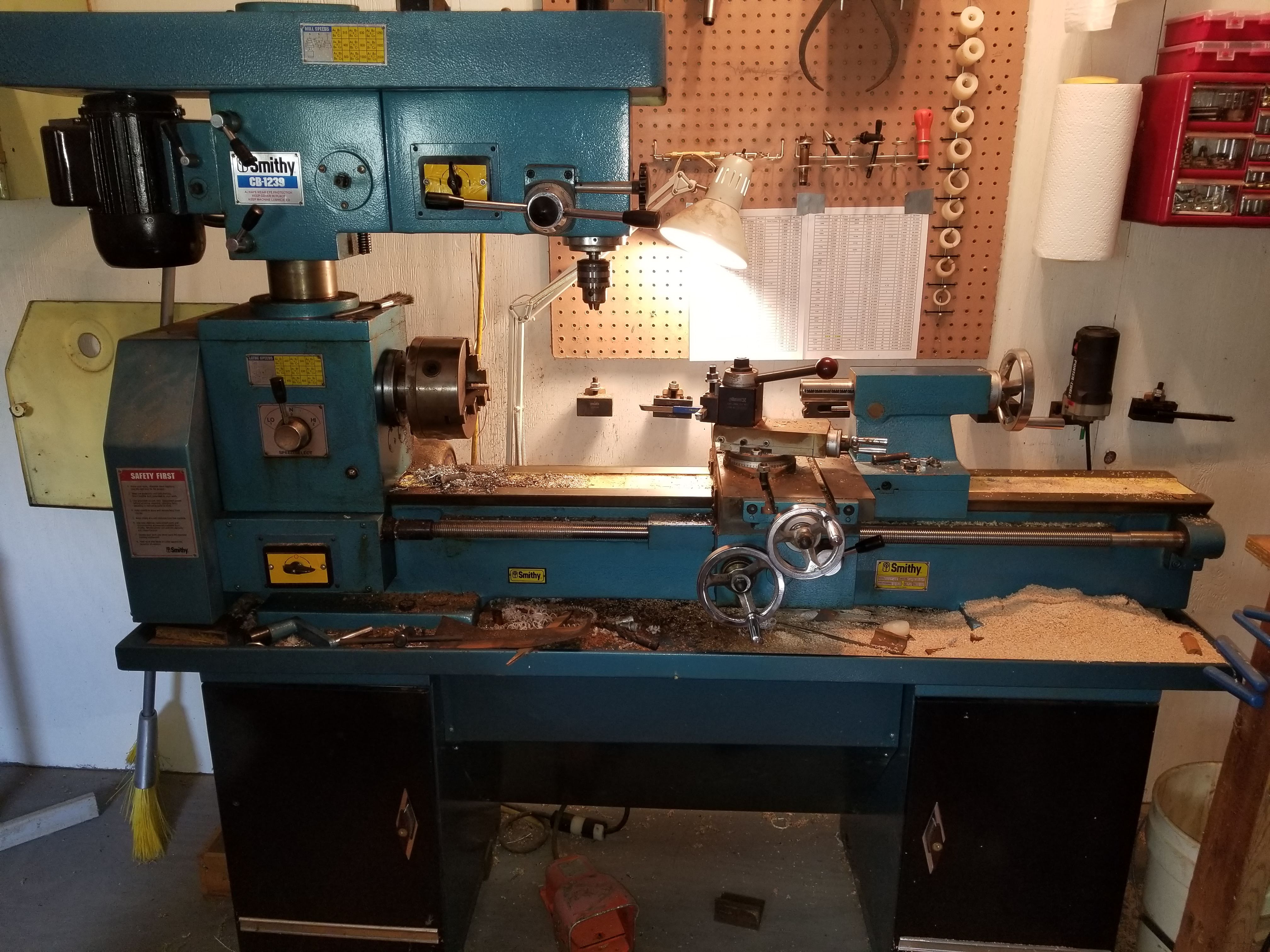

Yes sir to best of my memory about 20 years and probably only used it a dozen times in the past 5 or 6 years. But when I need it I have it. I'll try to get some pictures soon.

Thats ok, and your right that is darn close to the new one I just bought, a very nice set up to thanks for sharing!! You have a peg board that gives lots of hanging options and quite the assortment of nylon bushings, what are they for? If you can sometime could you get a picture on the drive end with small door open showing how you have your drive belt or belts for lathe turning, thanks...........

I don't have a rear chuck so I turned some different size bushings that will slide in the bore and hold longer objects steady, usually wood.
