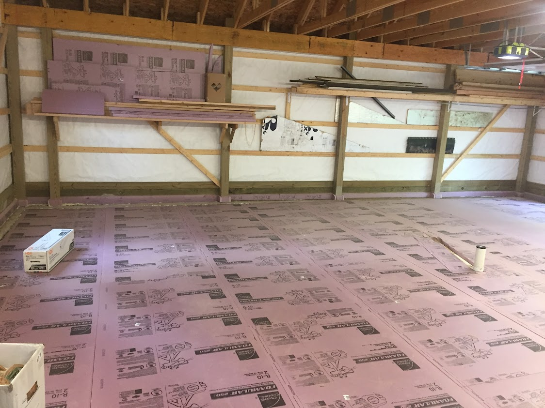

You didn't insulate under the slab?
You funny. :p
2" R10 foamular250. Not cheap! But I like to think I would have insulated the slab anyway even if not doing radiant, if the building is to be heated. We did 4" for R20 under the slab in our house, even without any PEX/radiant in it. Holds temperature crazy stable, it's awesome.

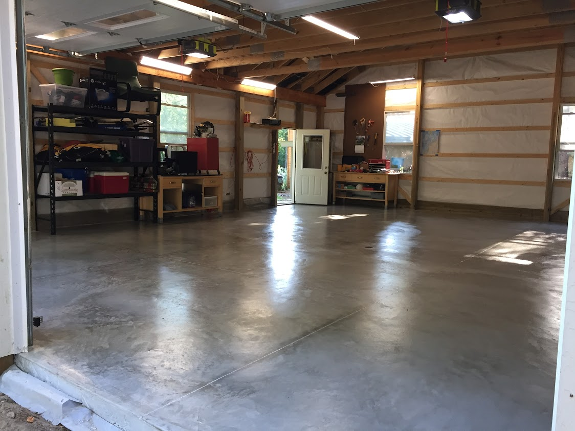

And while I have my old pics located, here is the slab after two coats of TIAH sealer. I was really pleased with how the slab turned out, not perfect, but for $3200 poured, pretty rad. Sad that I can never expect those prices again!
If anyone follows the Diesel Creek channel on youtube, that dude just had a gorgeous pad poured, nicely documented in multiple videos, of course.
/ Garage floor #54
I never thought about putting it inside a building, but that is a clever idea.
My cut joints are 7.5 ft. apart and about 90% of them are still filled with the dust from the saw blade.
Sounds like you have a new fun project to tackle! Lol.
Prior to foam backing-rod and sika-flex, I used a combo of compressed air and shop vac to clean out the joints.

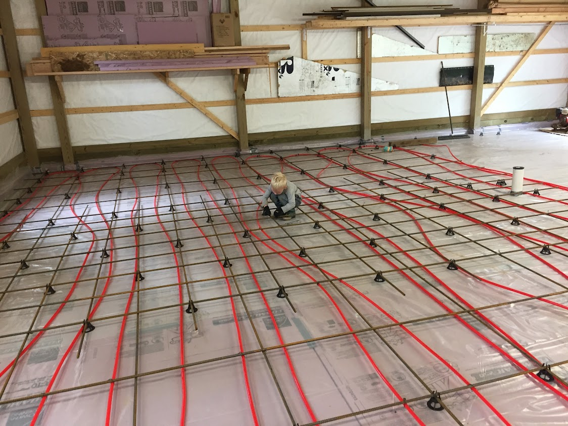

Your young one, looks so intent on the job at hand; that is so great!
Thanks for sharing the details and photos.
All the best,
Peter
