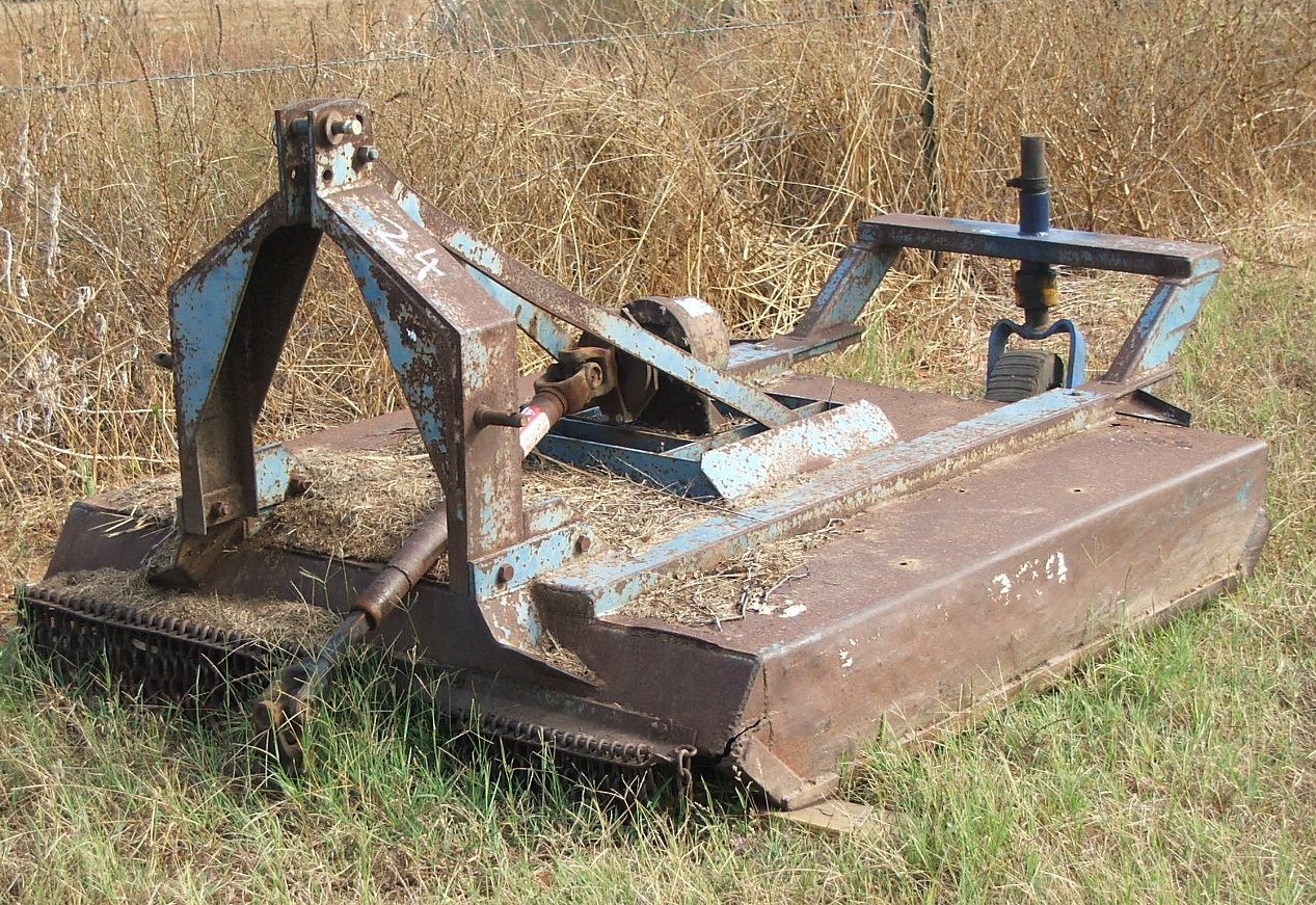

My little dozer has a crane. I lift mine by the rear wheel frame and rest it on the 3-point tower. I keep the crane cable attached while I work on the blades. Takes about 15 minutes.
Don't laugh. I paid $35 for this Ford 954 cutter about 12 years ago. Darn good cutter. It's due for a paint job after I finish the Ford tractor. ;)
