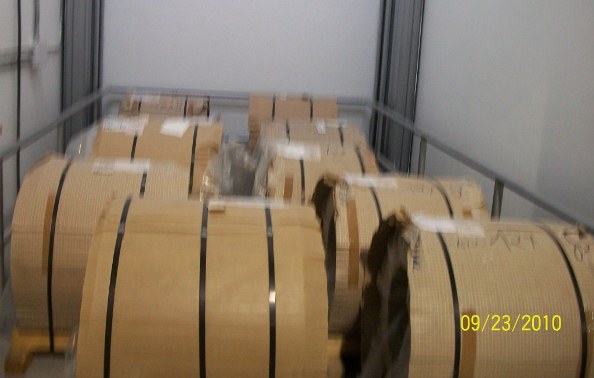

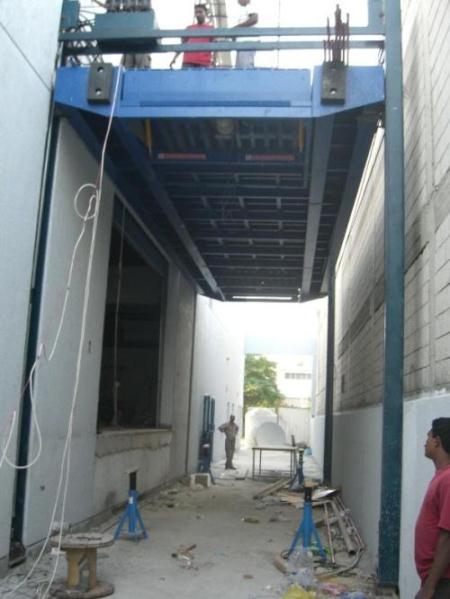

Here is a photo of one of my lifts being tested it is an 8 ton lift with 20 ft of rise note we have more than 20 tons loaded on the platform
This is metric tons by the way

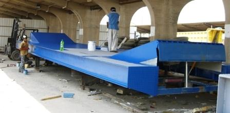

Some of my lifts are very special purpose
This one has dock levelers on both ends and is over 40 feet long

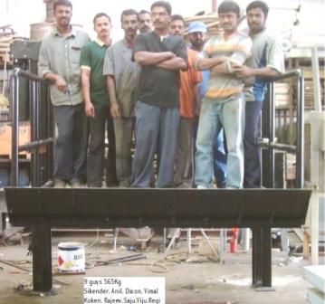

but some are tiny only capable of 2 tons

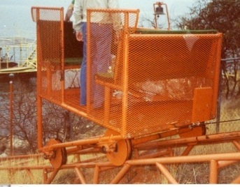

Here is something for those who have an extreme sloped lot. Back when I was building boat houses and marinas this was a solution for one customer to get from their home down to their dock.

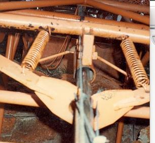

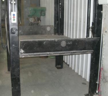

I have searching through my old archives to see if I could come up with a light duty unit that I had designed. the problem here is since everything I have built is used in the industrial sector with the structure having a minimum FOS (factor of safety) of 5 to one and suspension cables @ 8 to one. This is the lightest duty lift in my archives and it has some special features not normally found on lifts as well this is a 1 ton rated lift with a 5 by 7 ft platform 15 ft of rise surface mounted so that there is no obstruction in the walk through area when the platform if in the up position the ramps allow for loading from either end it is off loaded from the side when raised if the pressure of the pump is adjusted to its max setting the lift would raise over 3 tons
ON one service call my tech noticed they had figured out how to monkey with the pressure settings and were lifting 5000 pallets. He readjusted it back to the 125% setting then cut the adjustment bolt off
I do have some single and 2 column lifts but they are much heavier one is 6 ton rated
