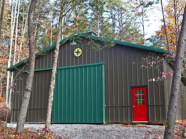

Morton just completed a 26' x' 54' x 12' building for me last Dec. They are more expensive than some alternatives but the materials they use are high grade, heavier steel than most others, and the crews are full time Morton employees who do a quick and professional job. They've been around a long time, show up on time/finish on schedule, and stand behind their work. PM me if you have specific questions or would like more details.

I like the brown and green combination FrogLick. Different than most of the pole barns you see.

Any more pics there FrogLick? Very nice....
