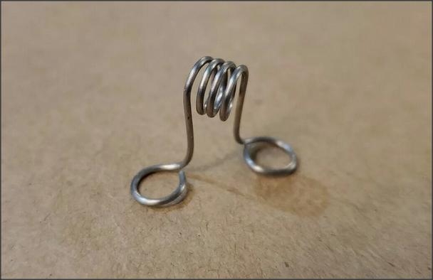

   / Gambled on a G5200 Today #23
I swapped out the glow plugs earlier today and it fired right up. The glow plug indicator lamp still doesn't work, but I haven't had a chance to get into the dash wiring yet.

#28
It's a parallel circuit, not in series, it is also a light, not the older style heater coil type.
The glow plugs can still work without the light working.
The glow plugs do, indeed, function independently from the indicator. On the G5200, the indicator is a coil rather than a light. I still haven't been "under the dash", but it looks like the part is about $60 if it's actually bad and not just disconnected.

   / Gambled on a G5200 Today #30
Do you mean it's like this - if so these can be found on the eBay for about $13 + mailing
(Search: glow plug resistor indicator)
