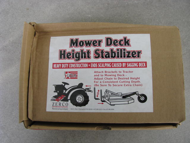

Has anyone ever attached any type of gage wheel to their rotary cutter? When mowing slightly uneven terrain the sides of mine tend to dig in a little and leave small ruts that I'm trying to avoid. I know the obvious answer is raise the cutter but this is at my place I only get to once a month so the lower the better for next time. This is mainly an issue in the yard around the house -- it is by no means a well manicured lawn but would like to prevent ruts and tearing up if possible.
This would be for leading corners only as it already has a single trailing wheel.
I'm envisioning some way to almost turn my RC into a finish mower without the need of finish mower quality cut.

Maybe just widen the skids?
/ Gage Wheels for Rotary Cutter #3

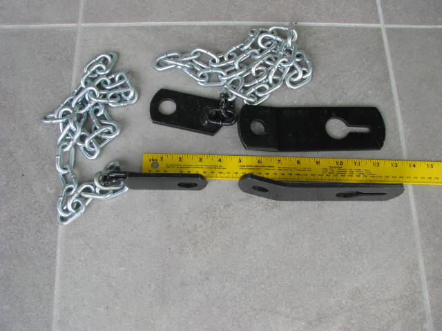

LIMIT CHAINS. Zerco Limit Chains for Rotary Cutters have been around since mid-1950's.
If your LOCATION were part of your TBN PROFILE I would provide a link where you could buy them. $30.

Those are still going to allow the cutter to dig into the ground if he is cutting short and going over uneven ground. Here is a pic of a wheel set up, would work ok going straight but if they hit while turning they would tear up the ground. You might find a pair of swivel gauge wheels from a finish mower and mount off the front corners, these would swivel if they touched while turning.

LIMIT CHAINS are simple, proved, $30.
/ Gage Wheels for Rotary Cutter #6
The fronts would need to be caster type too, and wide to take the weight. Otherwise a fixed-straight wheel will just dig in and you won't have fixed anything.
