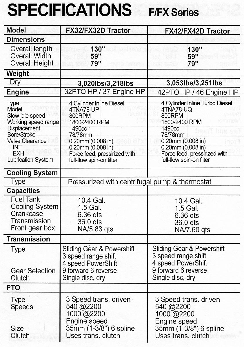

Not sure what you are looking for. Here is a pic of a spec page from a owner's manual for the F series tractor's.

I do not think that chart is correct the fx32d I am looking to buy is a 3 cyl engine, could be a typo , not sure

This thread is over 1 year old, but the FX32 still has a 4 cylinder engine.

Based on my googling I'm to wonder if 3 and 4 cylinders were made? Wonder if one maybe preceded the other. There seems to be evidence of both if you look. Not saying this is fact, just saying there could be both.

FX14 3T70B-N
FX15 3T72H-N
FX16 3T75U-NC
FX17 3TN75U
FX18 3TNB80-U
FX20 3TN824
FX22 3TN684U-B
FX24 3TN684U-A
FX26 4TNA78U-M
FX28 4TNA78UN
FX32 4TNA78U-P
FX42 4TNA78TQ
FX165 3TN75-UN
I guess that could be true. I was basing on this listing from someones OPs manual from 2003, which we all know is just a compilation of American user input, and the fact that the only head gasket Hoye shows for that model has 4 holes.

It depends on whose specs you choose to believe. The only proof would lie in a FX32 OEM Japanese parts manual.

So you have not actually seen that tractor. Can find no evidence that anyone has actually eyeballed a 3 cyl. FX32, although several spec sheets list one.

My FX 26 D is a 4 cylinder. I find it hard to believe they would put a 3 cylinder in a bigger tractor but I guess anything is possible.
/ fx32d #12
I had an FX32-D for 4 yrs, its a 4 cylinder.
The fx42-D is the same engine & frame, but they put a turbo on it to gain 10 more hp so its a 42 HP.
