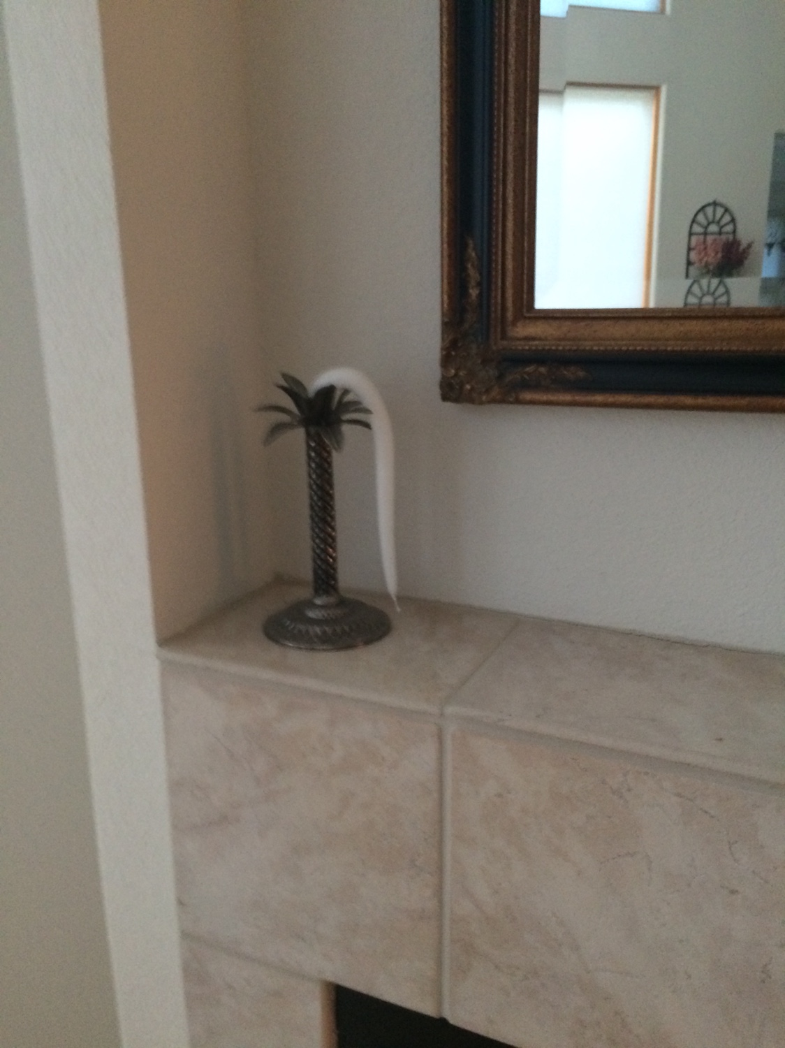

Here is an interesting problem I had about 2 years ago.
It happened at a Lake house we owned that was a vacation place v. permanent residence.
I went down one weekend. It was summer. Unlocked the door and it was boiling hot inside. Heat was running. Thermostat was at 99 degrees (it only went 2 digits).
I turned off the system (it was originally set on cool when we left last time) and the heat stopped.
Here is a picture of the candle on the fireplace mantel.
Turns out an animal (guessing chipmunk) chewed thru some wires outside and somehow made the heat run non-stop. Guy replaced the wires and all was well. Never happened again.
