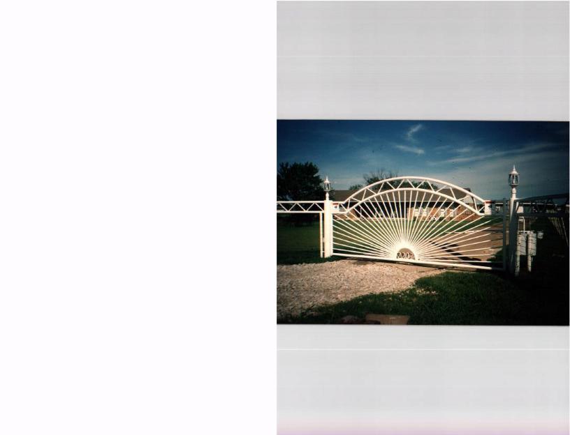

/ Fun with gates #22
That sunburst is beautiful!! That is one lucky school!! For $500 you oughta be able to take that as a charitable deduction on your taxes!!!!!!! /w3tcompact/icons/laugh.gif/w3tcompact/icons/laugh.gif/w3tcompact/icons/laugh.gif/w3tcompact/icons/laugh.gif
