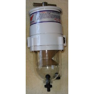

The cartidge may be bypassingor have ahole in it
switch to a paired 5 micron filtration cartridge unit and you will have fewer problems with your prime mover.
Saying that installing a Racor model 1100 fuel filter with a thermostaticly controlled fuel heater will remove everything to either 20 micron or 5 micron a little fuzzy remenbering the spec
The Racor passive design relies on the prime movers injection pump and creates a centrifugal flow with director vanes which spins the fuel and the sediment and water collect at the bottom and it has a manual drain to dump it all.
You would not believe how much junk and water collects in tanks whether they are on the prime mover or mobile or stationary storage- weld spatter and chippings from the core wire after cooldown and usually they dont clean them very well either.

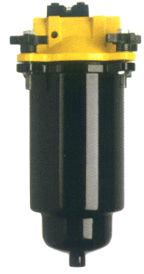

They make a bulk fuel filter too- I will find what I have and post it here.
The bulk diesel fuel filter separator moves along at 35 gallons per minute
my thoughts anyway
