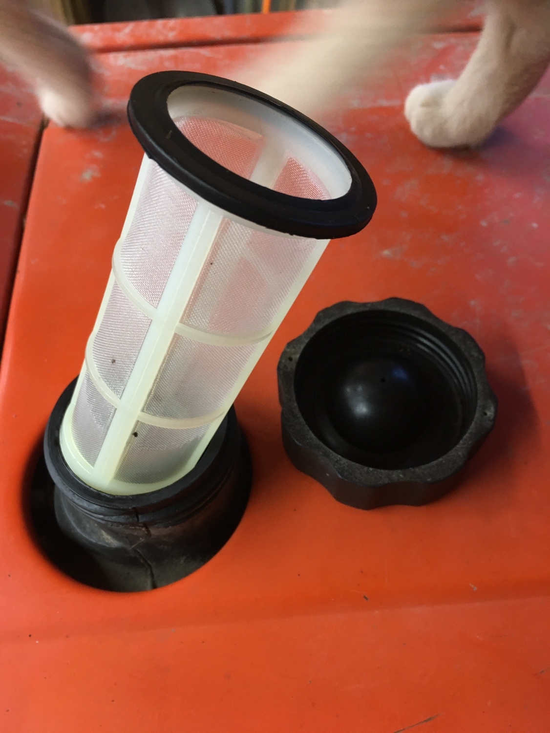

I have this in my tractors fill neck. It helps catch stray bugs and whatever.
My fuel goes through a 10 micron filter water separator then a 2 micron final filter from my bulk tank. Cant be too clean.

I've never seen white powdery residue in my strainer. I use a MrFunnel for known contaminated or suspect fuel on rare occasion, and plan on getting one of the metal strainers for the filler neck like posted above.

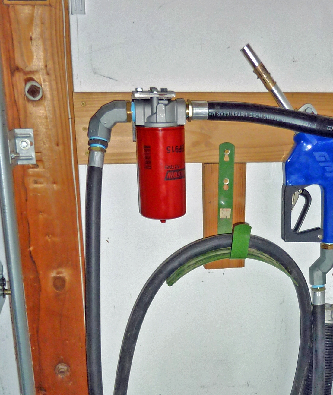

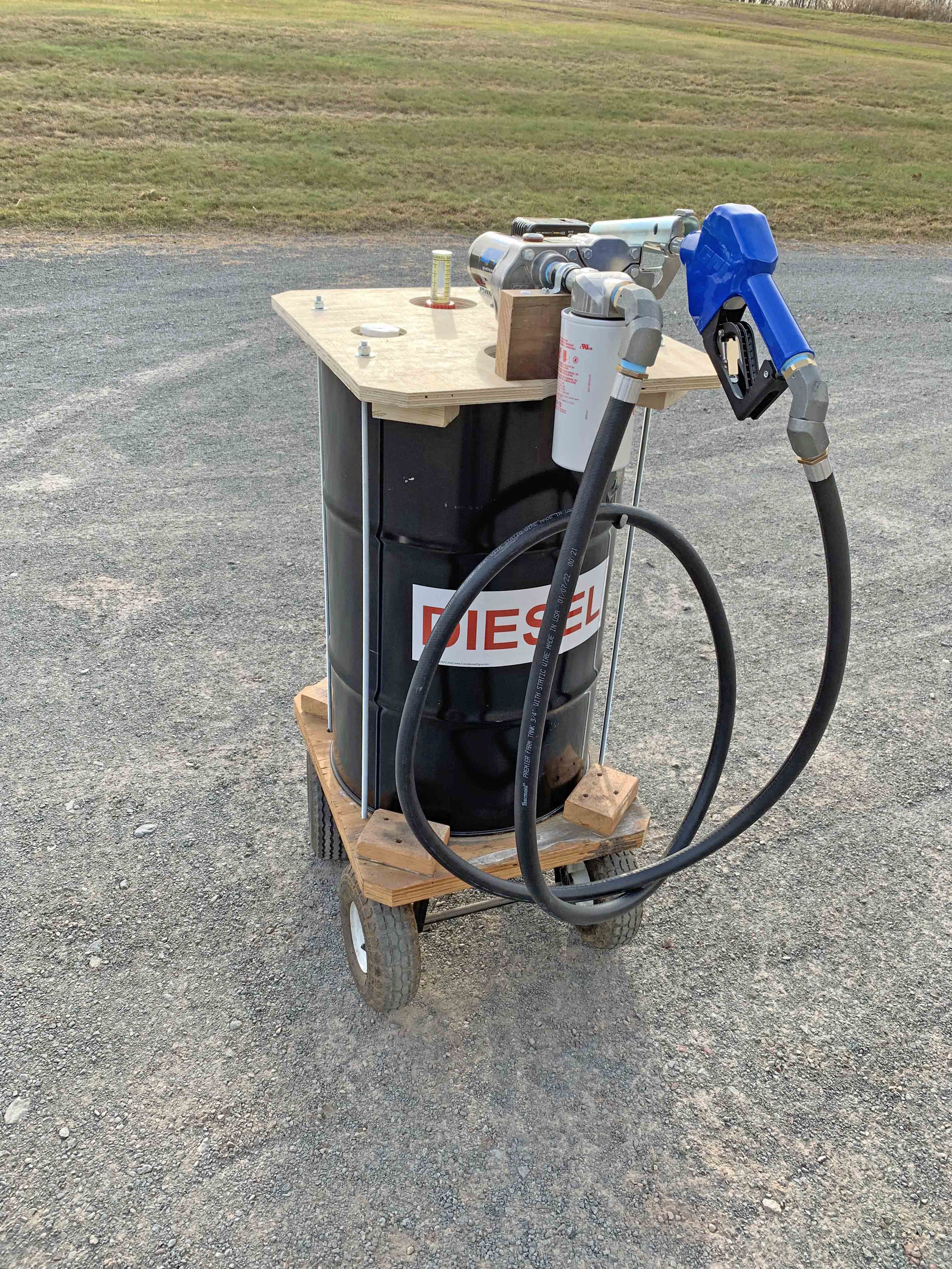

My diesel is filtered twice. First using a 10 micron filter on my bulk tank, which I use to fill a portable tank. That one is equipped with another 10 micro filter and used to fuel my diesel equipment.
View attachment 3845935 View attachment 3845936
mine isn't on a cart like that but I use that same type filling / filtering system
Around here, a blue nozzle cover signifies gasoline. Green is used for diesel on a nozzle that is too large to insert into a gasoline powered vehicle. That is also the way my GPI filling equipment is sold.
