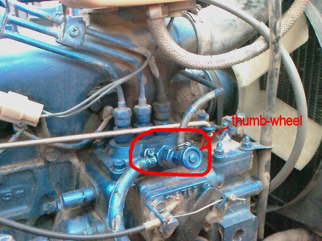

I also have a little bleed valve on the outlet of the fuel pump. It has a little "thumb wheel" to open and close the valve. There is a hose comming off this valve and it goes back to the top of the injectors.. it is not the main fuel line/lines to the injectors... those are rigid tubing. My best interpretation of the manual says that this valve is to be opend to bleed air aout of the fuel system. This valve has been open sisnce I bought the tractor last spring. It has been running fine with the valve open... just wondering if it should be left open or closed and if I could have done any damage by running it open??

I also have an LK3054. When I installed the new engine, I used the "thumb wheel" to bleed out the air and then closed it. It started right up. I've left it closed since. Instructions said to turn counterclockwise to open, crank and when it starts or air is expelled, close it by turning clockwise.
The manual that came with the new engine (TD1400) also states:
"The air vent on the fuel injection pump must always be closed during engine operation. The engine may not run if left open"
Guess they're wrong ;)

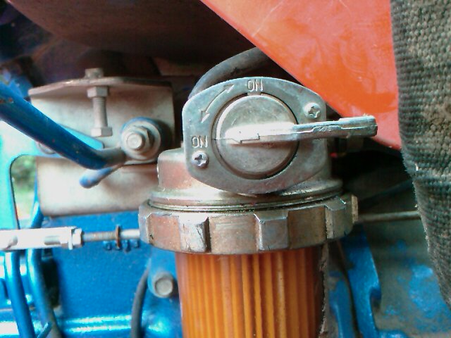

Pictures are a great idea! I took a couple yesterday evening and scanned in the page from my manual. So here's a picture of how my fuel shut-off valve looks. This is how it had been since I got it.
I've been running it with the lever as shown. Sounds like that's NOT how you guys are running it right?
Next picture is the air bleed valve. It has been running wide open for the past year.
Third picture is the page from my manual. After looking at it again, I realized that I am missing the spring and small o-ring! I don't think that is causeing my leak from the top of the bowl, but I'm pretty sure the filter is not and has not been seated as it should be.
The more time I spend with this tractor, the more thing I find that the previous owner did kinda half-a$$ed!! I'm going to have to start another thread about my alternator.
Thanks for all the input guys. Let me know how these things should be set.

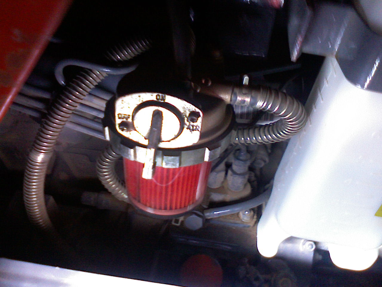

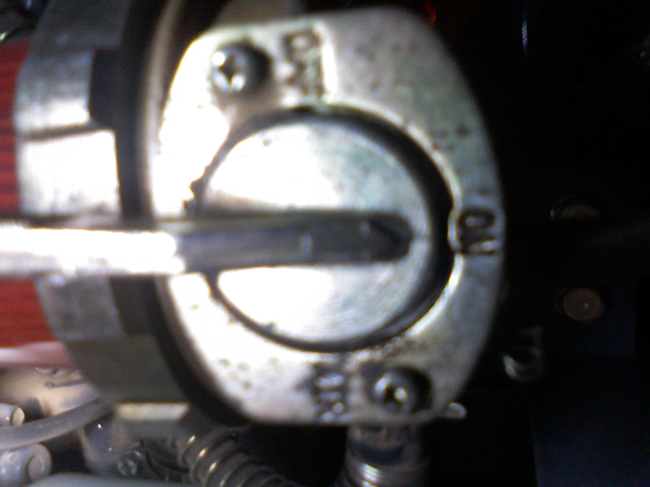

Pics of my fuel filter, and the manual method and parts. When I get my shop manual tomorrow I will look for any diagrams that may help.
My book says to leave the fuel cock in the open position. You may need to click on the pics to make them larger.
If something isn't clear enough let me know, I'll have to bring the book in the house and scan to post it.
We have two different fuel cocks, I would look to see which one lets the tractor run, and which position chokes the fuel from the tractor. As far as the other stuff, our equipment may be too different for me to be of any help to you. I am guessing that the leak is a result of a bad gasket around your fuel bowl. My second guess is that the fuel line connection to the fuel filter is leaking and collecting around the filter bowl where you can see it. Other than this I would guess it has something to do with gremlins or the tooth fairy. I am really surprised that none of the Kioti motorheads have solved this for you yet.
The spring adds pressure to the filter itself in the bowl, forcing it up to the fuel flow. The bowl should not be taking or having any pressure in it (I think). Maybe it is the spring causing the leak. Heck I'm tired of guessing, I'm no mechanic. I rip things apart all the time trying to figure out how they work. Somehow I get most of them reassembled.
