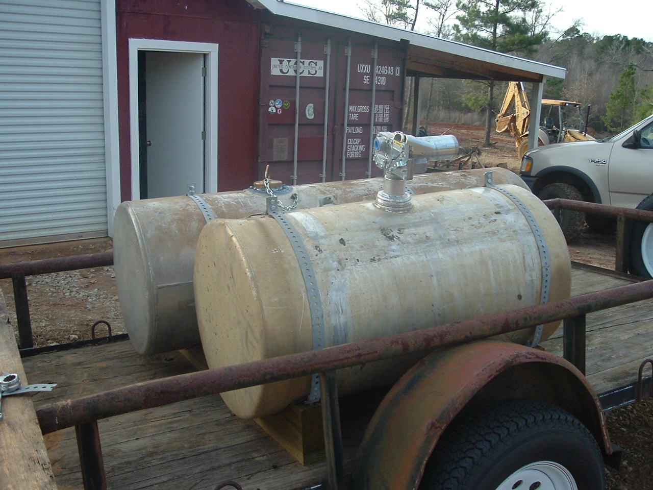

I will never store ethanol gas in a bulk tank again. It has caused problems in three Polaris SxS’s, and a Jeep. Treating with Stabil and SeaFoam did not solve the water issues.
I now purchase non-ethanol and store in non vented cans.
Diesel is stored in a reefer tank and is treated with three additives. 50 gallons last about 3-4 months.
